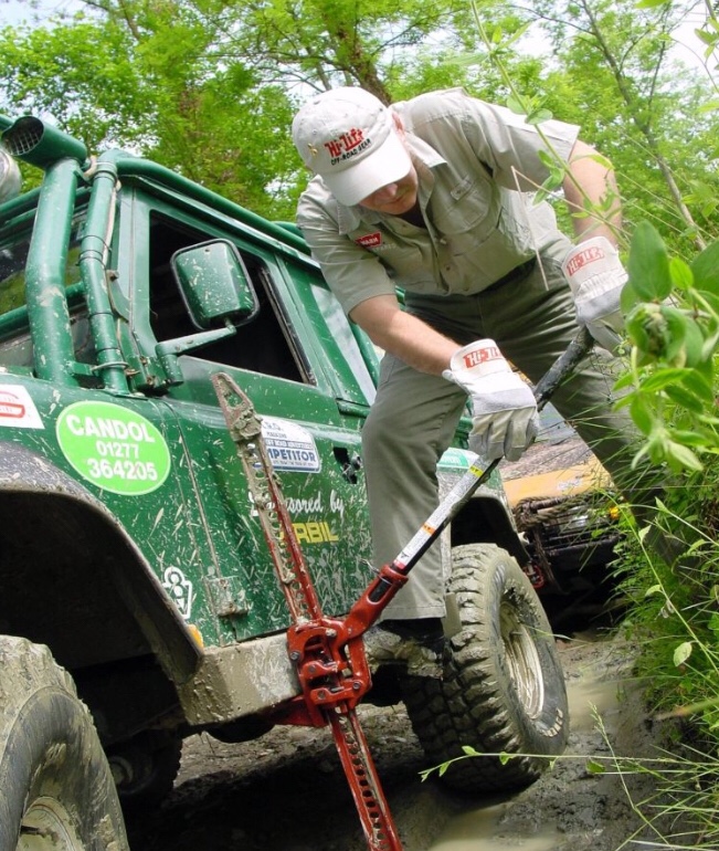

    As mentioned, do love em in the right high lift steel situation needed.
    Pictures below direct from ‘Hi-Lift’ site. Picture here also is only possible due to structural box steel extended slider but as soon as the Jeep Weeps sideways slightly, can opener door time and usually with upper hand/knuckles stuck between, bad idea :-( ! https://hi-lift.com/hi-lift-jacks/x-treme/

    Hi Lift Jack Mounting options
    Almost forgot, last picture from their site, fool has his head over the lever/handle awaiting a jaw realignment. Only takes a bit of crud in between upper & lower pin workings. There aint no third redundancy pin on any brand, always ease lever pumps and listen for solid home clicks of each!!
    EDIT: “Deep Clicks/Lock” !!
