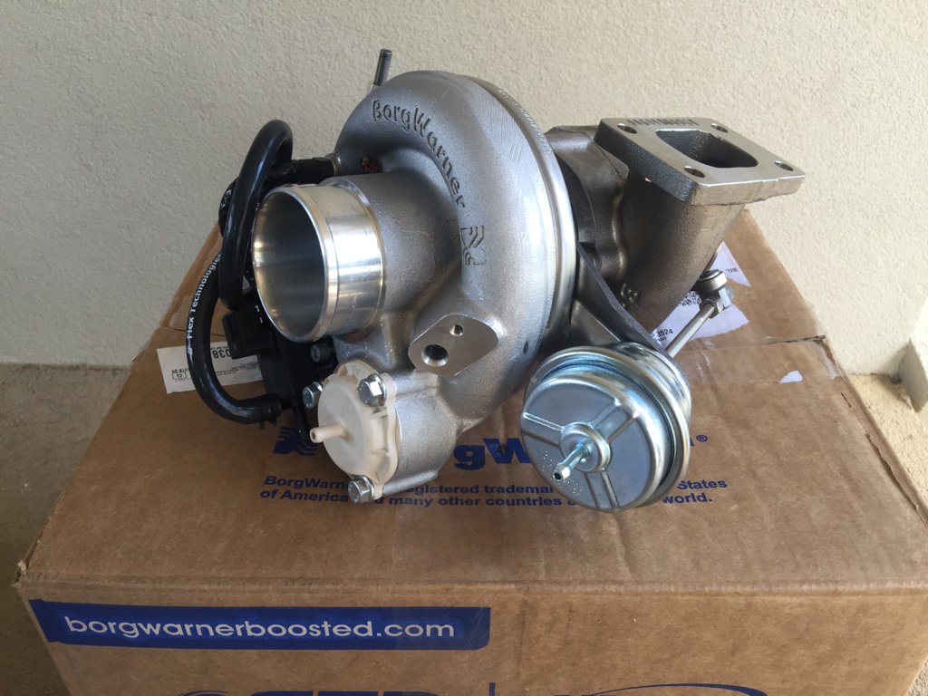

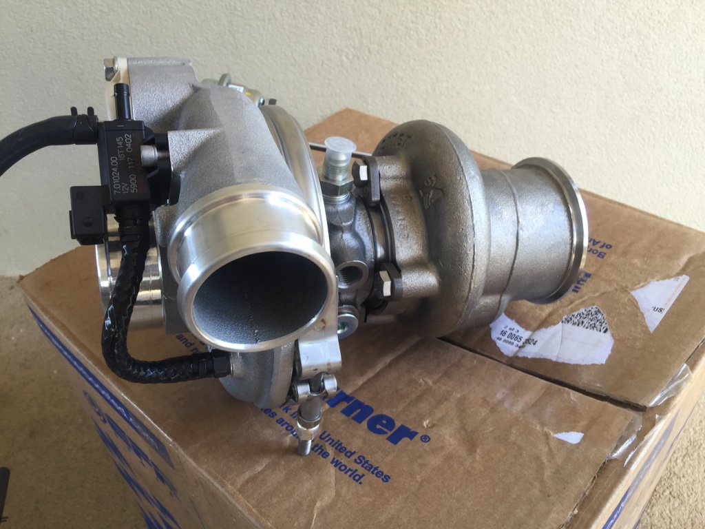

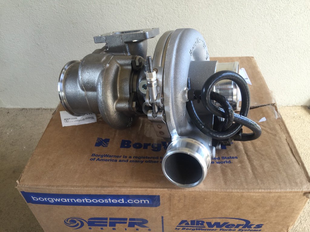

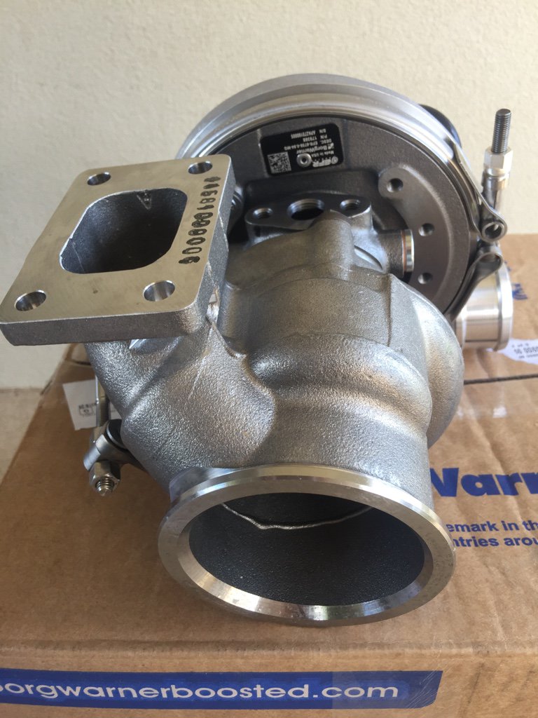

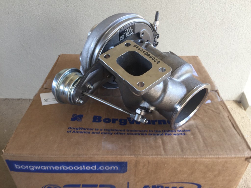

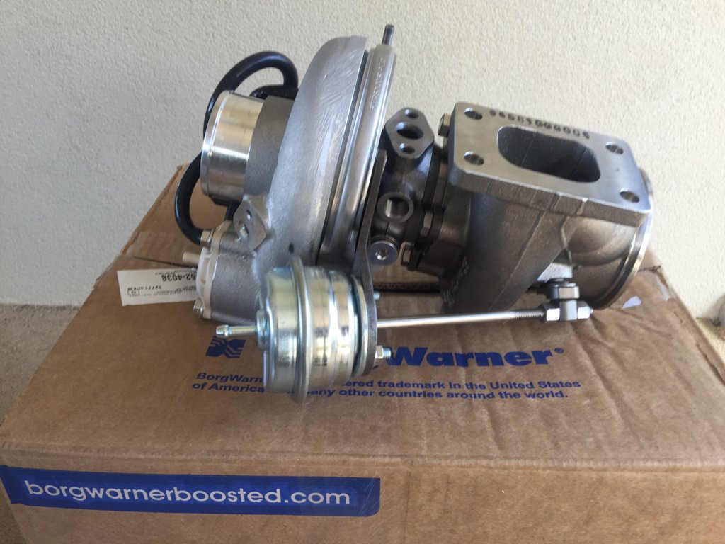

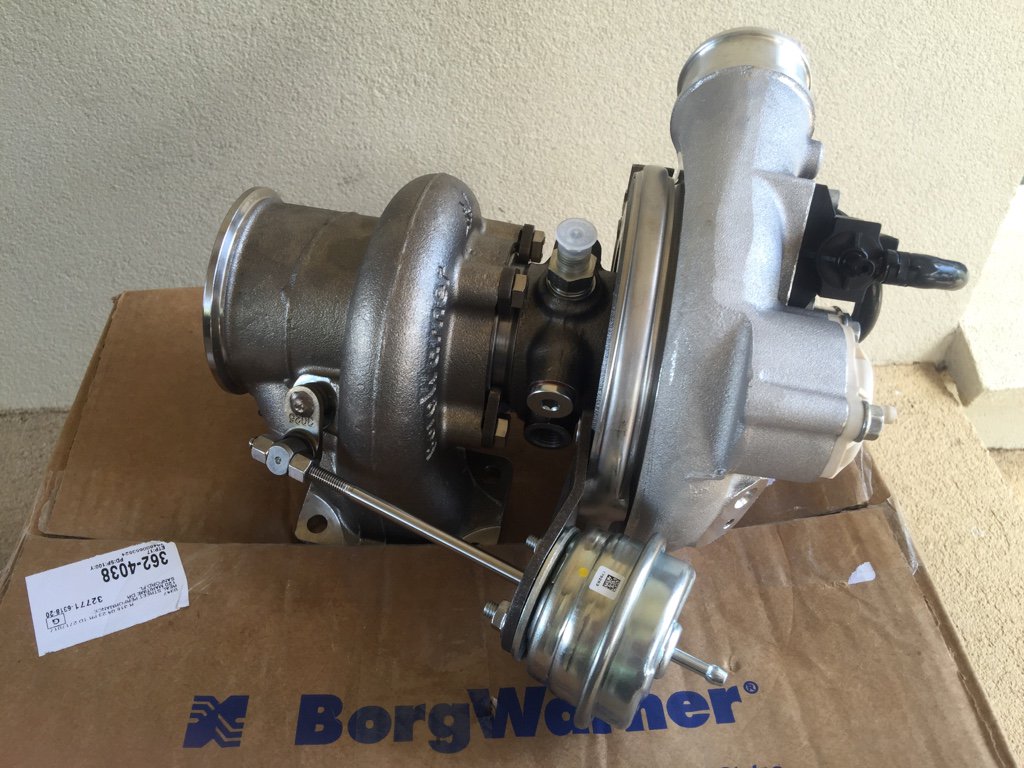

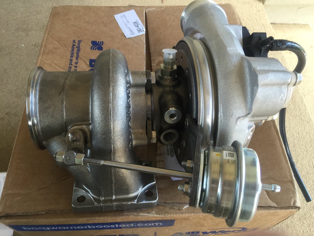

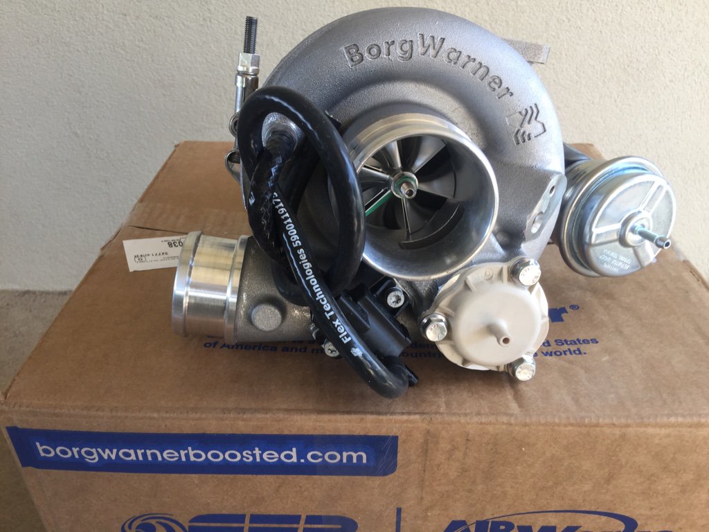

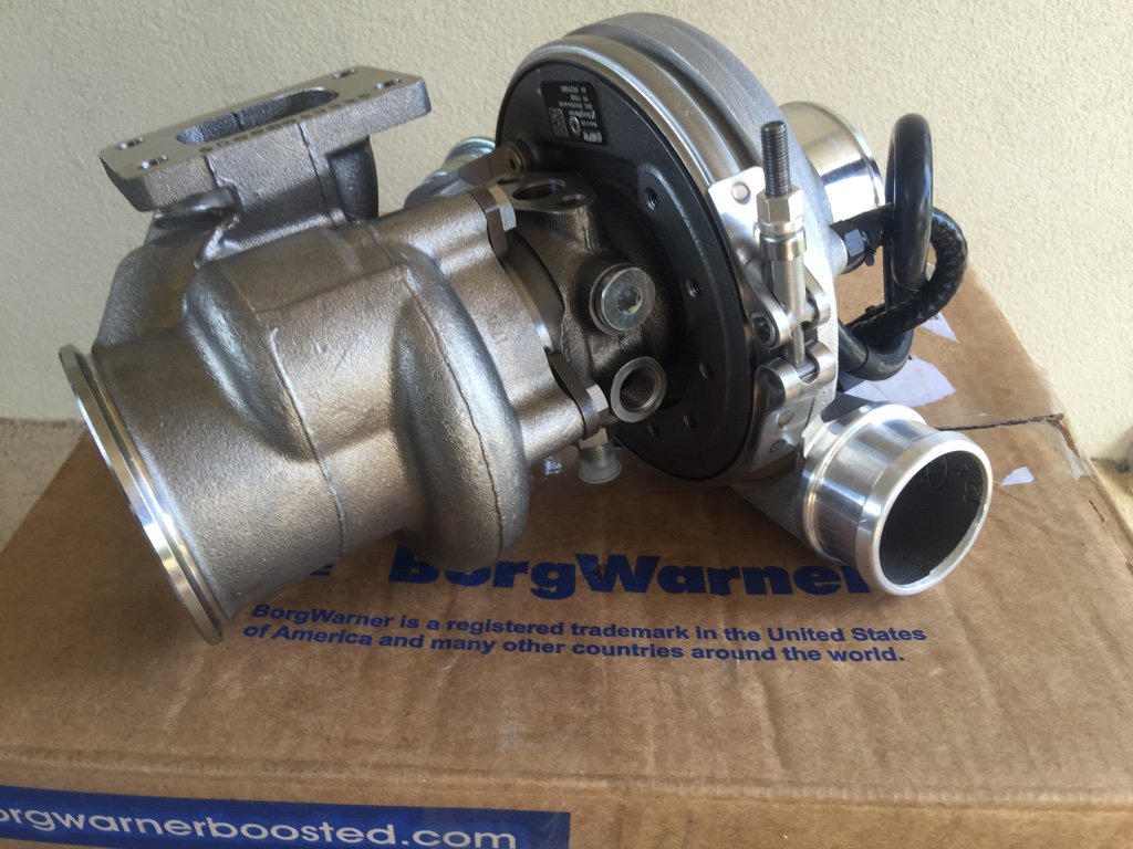

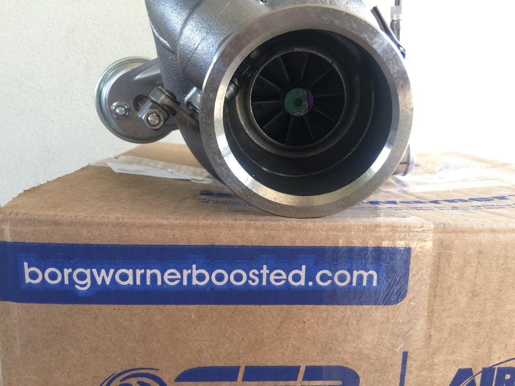

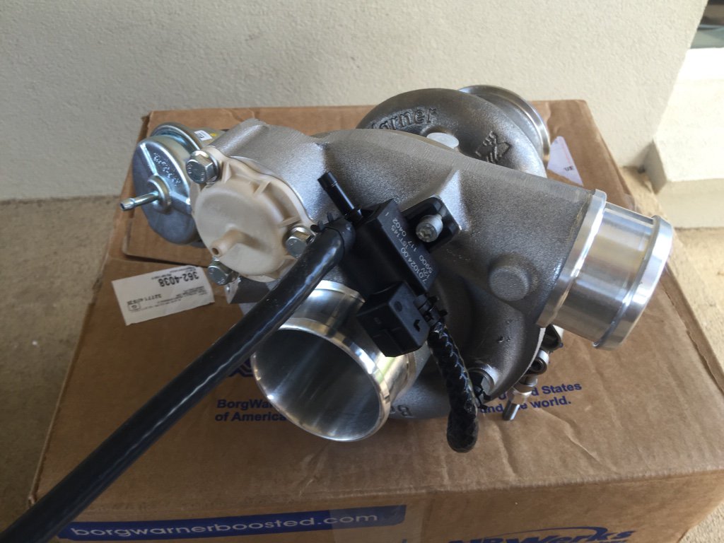

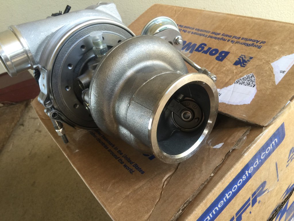

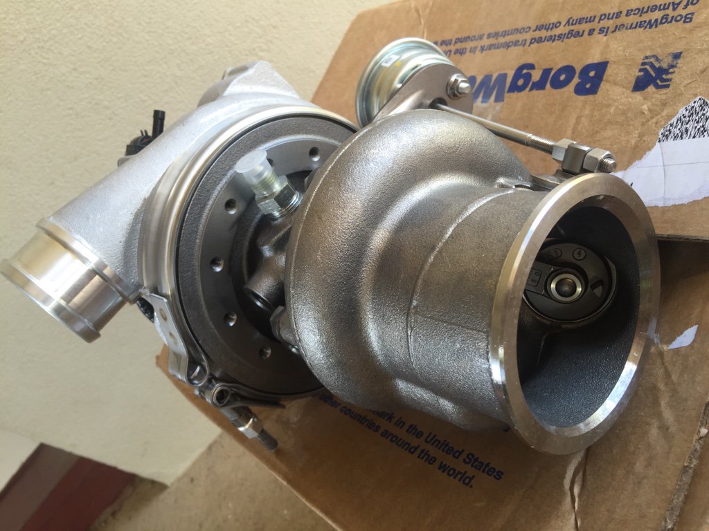

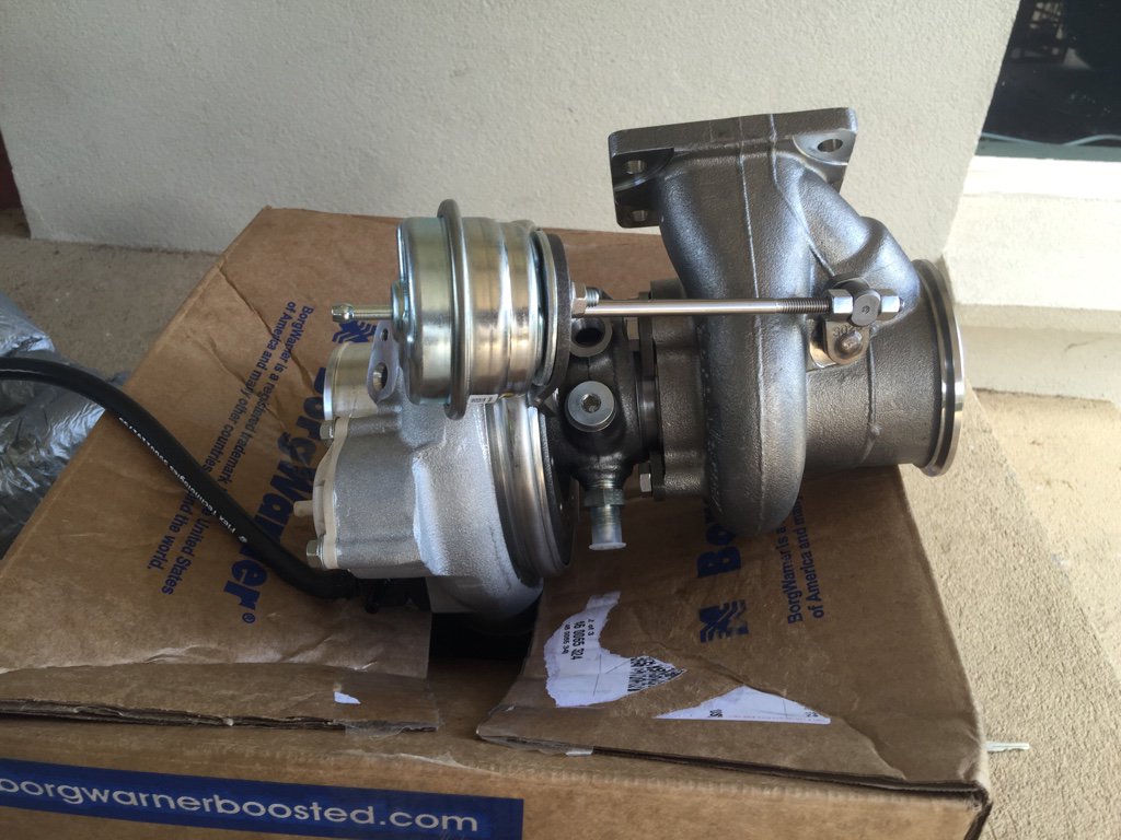

    Some more pics of the Turbo

    Underside of my turbo looks like there is only an Oil cooling line
  14. #158
    28,408
    13,850
    Ok so your turbo is just oil fed, no probs...
    Take off the Boost Controlled Solenoid Valve (The black plastic thing), not needed mate.
    As discussed, get that oil drain early this week. 38mm bolt space flange with 2 x bolts M8 x 1.25. Straight down fitting with no bends and hose and clamps to suit to your oil drain barb on block.

    @MudRunnerTD Your turbo is only oil lubricated, there really isnt a lot of cooling from the oil.
