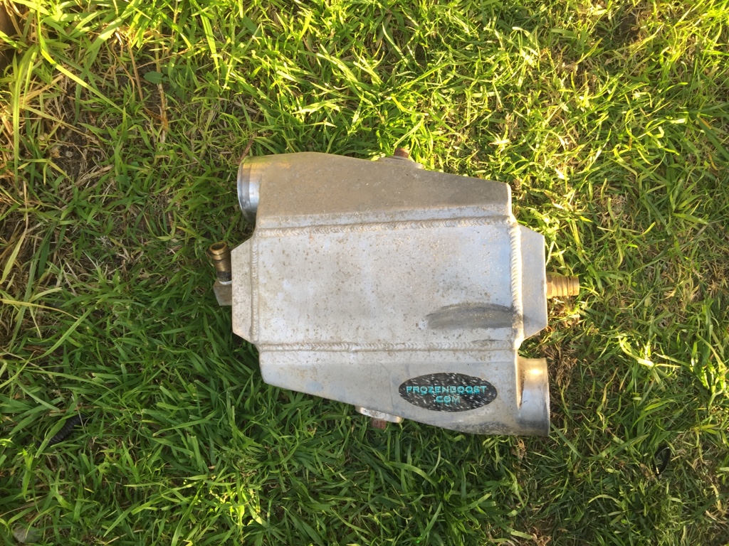

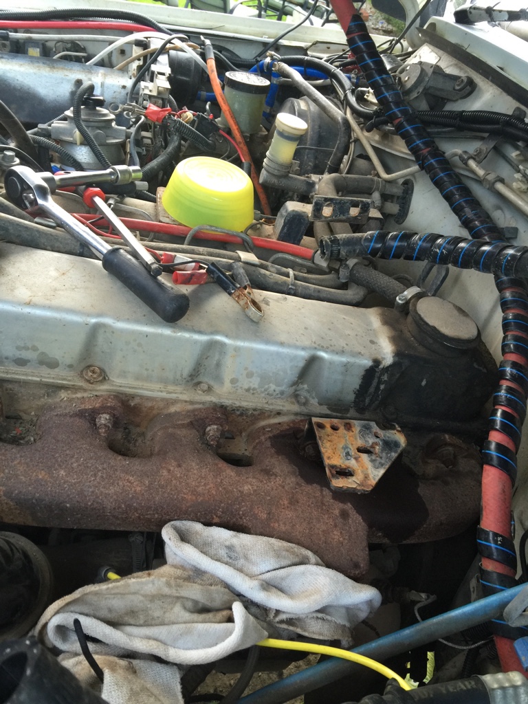

    So got back on the GQ this Arvo. Finished tightening all the body bolts and finalized the body lift reduction. Very pleased.
    Then the daunting. Lifted the bonnet and started on the intercooler.
    Out she comes
    Couldn't remember how to remove the heat shield...... Figured it out!
    Out with the 9" grinder for some slight adjustments!!
    Test fitted to intercooler back in and shot this vid with my iPhone in the engine bay. We are close! Very close!!

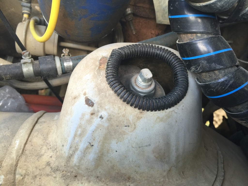

    So with the body lift gone I am glad I drilled these holes for the top of the front shocks or they are never coming out!!!

    Been busy!
    Are you spraying the guards yourself?
    Also I wonder if you could find some rubber bungs to in the shock tower holes, it might help keep dirt out out the engine bay?

    Yeah I reckon I could. I used a hole saw so it's a nice neat hole. Not sure how much would enter there versus the rest of the engine bay though? Will check it out though cheers.

    Your shock tower will hit the body, the top of my shocks punched holes in those humps without a body lift

    Quote Originally Posted by liftlid View Post
    Isn't that why there's a hole cut there?
