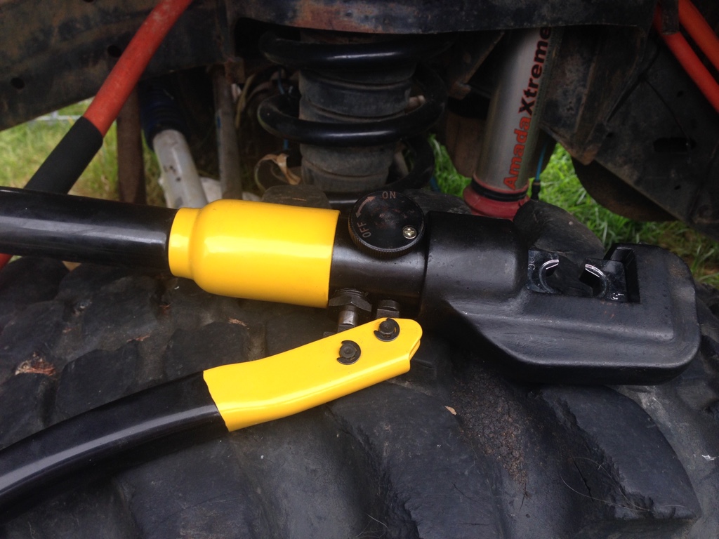

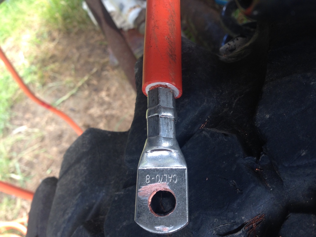

    I also used the Ebay hydraulic crimper for my winch install. I added pics of crimper and result in the thread I did here.
    Like Cuppa, I had to go one size under for the correct crimp. For the 50mm2 cable I had to go once with the 50mm dies then pass the 35mm over it.
    The reason I did this is because I soldered the exposed copper near the end of the lug and found it wicked through the crimp. This is a sign that the crimp is not "gas tight" as it should be. Didn't happen after using the 35mm dies.
    I just assumed the chinese dies weren't precise enough.
    This is the crimper and the result on 50mm2 cable after passing the 35mm dies.

    I do a double length crimp with mine rather than a single central crimp like that, I crimp the full length of the lug.

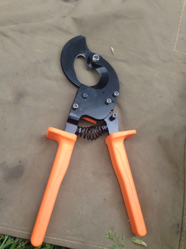

    And these shears make everything possible

    Your dies are thinner. That looks neat. Wouldn't look as neat with the thicker dies I think.
    I like those shears.

    A grinder works well too for cutting big cables neatly =]
