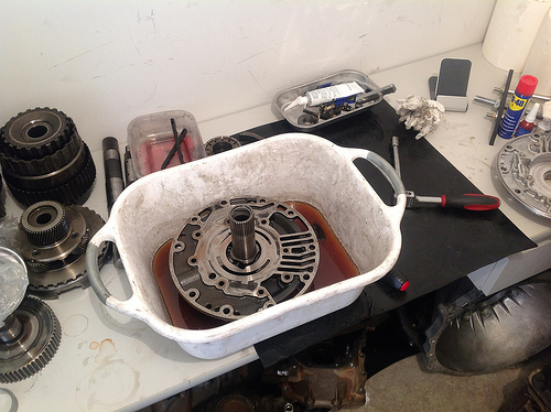

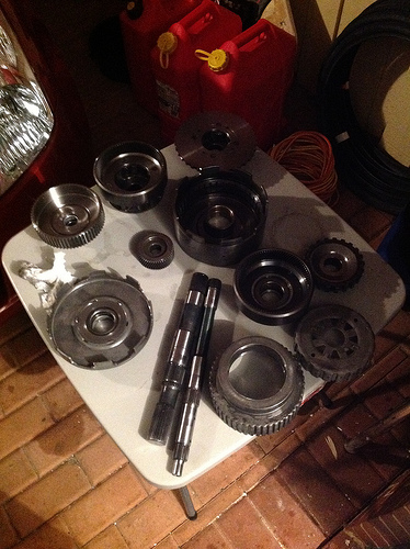

    Next job as I said was the cleaning....definitely the worst part of the whole job. All the external surfaces were covered in 22 years of muck. The internals were covered in burnt on black friction material. Took ages to get all the bits clean and dried off:
    Was also pretty amazing how fast the parts rusted (in minutes) following degreasing and drying if not oiled up with ATF fluid. Here is the pile after cleaning:

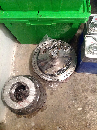

    Next up the rebuild began in earnest starting with the oil pump. I basically just followed the order of the workshop manual but it is useful to do the oil pump first as you can test the two clutches towards the front of the box using it. After rebuilding each component I lubed them up with ATF pretty liberally and put the in plastic bags for storage since I was rebuilding the components over a number of evenings:

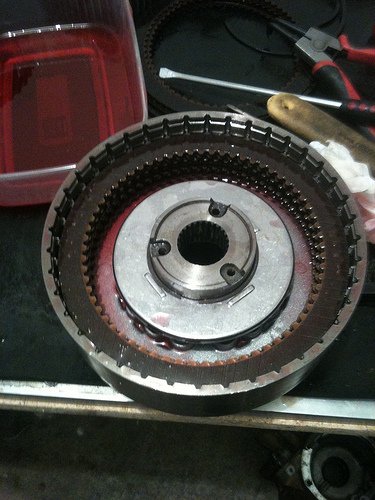

    From a pile of clean/new parts assembly of the internal components is very quick. I also checked the amount of play in each clutch pack using a calliper versus the specs in the workshop manual. I guess this is important as if there is too much or too little play you might be in danger of undoing all your good work prematurely through accelerated wear. Lucky for me all tolerances were ok, however, if they are not you can get different width packing plates to account for any discrepancy. Here is one of the rebuilt clutch packs:

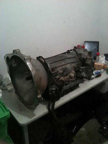

    Me and a mate refitted the box in half a day or so using the same table jack as we used for removal three weeks or so before. This time though we only put the gearbox in leaving the refit of the transfer box for later. This made the whole package much lighter and easier to manoeuvre so I would definitely suggest this to others. We then used a series of chocks to get the gearbox bell-housing and the block parallel so the two would just slide together.....and they did!
    After that we bolted up the flex plate to the torque converter using a bit of threadlock and then simply bolted all the bits back on including the transfer, driveshafts, oil cooler lines and coupled up all the wiring. Last job was refilling the gearbox with the 8-8.5l of fluid it required.
    At this point I kept looking for things I had forgotten to avoid turning the key! But with nothing else left to do/check I put the key in it, gave it a crank and started it up. No nasty crunches was a good first sign so I was pleased with that! I was even more pleased after a minute or so of the rig running that when I dropped it in reverse it crept back and when I dropped it in drive it crept forward!!!!
    So I had at least 2 gears: forward and reverse! Next up was a quick road test, which confirmed I had all forward gears and reverse working perfectly and the torque converted locked up at ~85kmh. Result!
