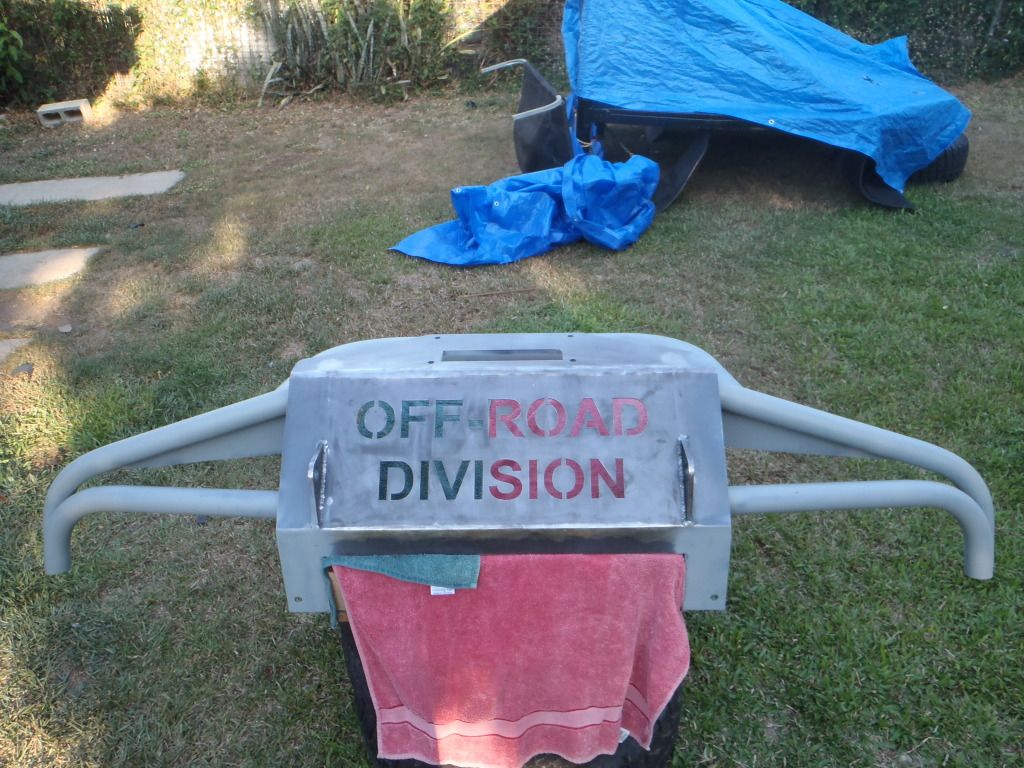

    thanks for the replys guys it was bare metal apart from one peice but i wire wheeled that back to bare no rust what so ever there was a couple small surface peices but also wire wheeled them scuffed the whole bar right back with the wire wheel also cleaned her up with wax and grease remover and used an enamel primer.
    was painted the very next day before i got a chace to get onto my computer so im hopeing it will last well.
    everything but the front plate on winch cradle im primer
    i have to weld on some brackets to mount spoties and 2 aerials on before i start painting the colour on
