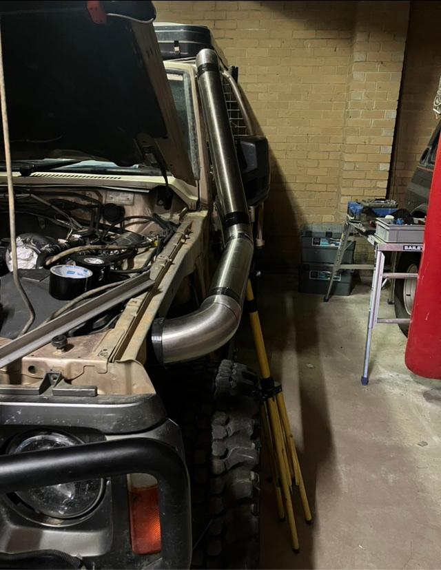

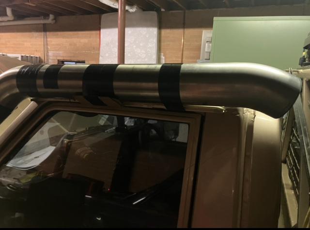

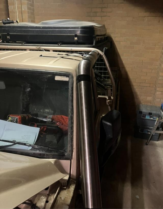

    Mocked up with black tape, another Wacky MB concept
    Not sure if I love it or hate it yet
    Keen for your honest helpful thoughts prior to welding Team NP.com.au?
    Certainly will keep I believe our pesky local Hills bugs from ram feeding into the airbox, open passenger side window for a Navi would be a lot more bearable too I imagine
    The 30 degree downwards, slightly twisted final bend theory is for parked up outside/overnight camping torrential rains protection.
    Have had previous plastic family GU wagon truckster ram head snorkels fill airboxes overnight and believe poor @Rossco ‘s GQ once did the same nearly hydro-locking his beast on morning startup
    EDIT: Besides looking a little kooky, not powder coated yet Could the extra nearly say 800mm of 4” pipe potentially hinder its air intake? I’m only chasing 150rwkw again
    I’d say no bro. That 30 degree turndown lowers the intake height and if you get water coming over your window height you might be in big trouble.
    Extend it up vertically at least 2 metres to be safe I reckon.
    That way he will be able to not just cross rivers but also to cross deep lakes.
    I think if he's got water up that high he's in the poo regardless.
    I have a nice looking 6inch chrome air ram here at work he could fit aswell.

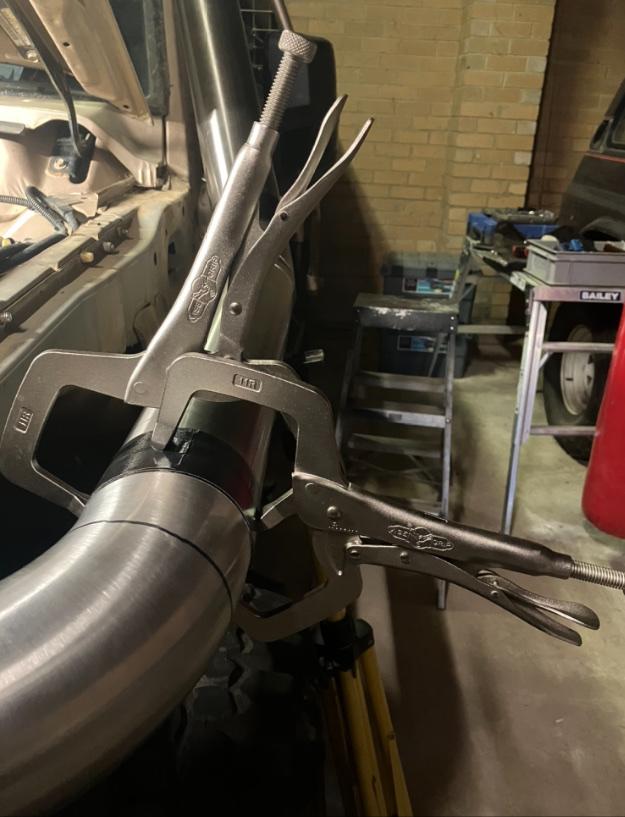

    Cheers Legend’s, you’re all as wacky as I am
    Struggling to locate my old school metal G welding clamps, spoiled myself on the way home and bought some long wanted C Visey grips:
    I’m far from a steel fabricator but this wacky method of mocking up pipe work with tape then tack welding through small tape cut holes N/S/E/W might actually work

    Looking good Mark. I had my staino 4" powder coated, came up really good if you want the black look
