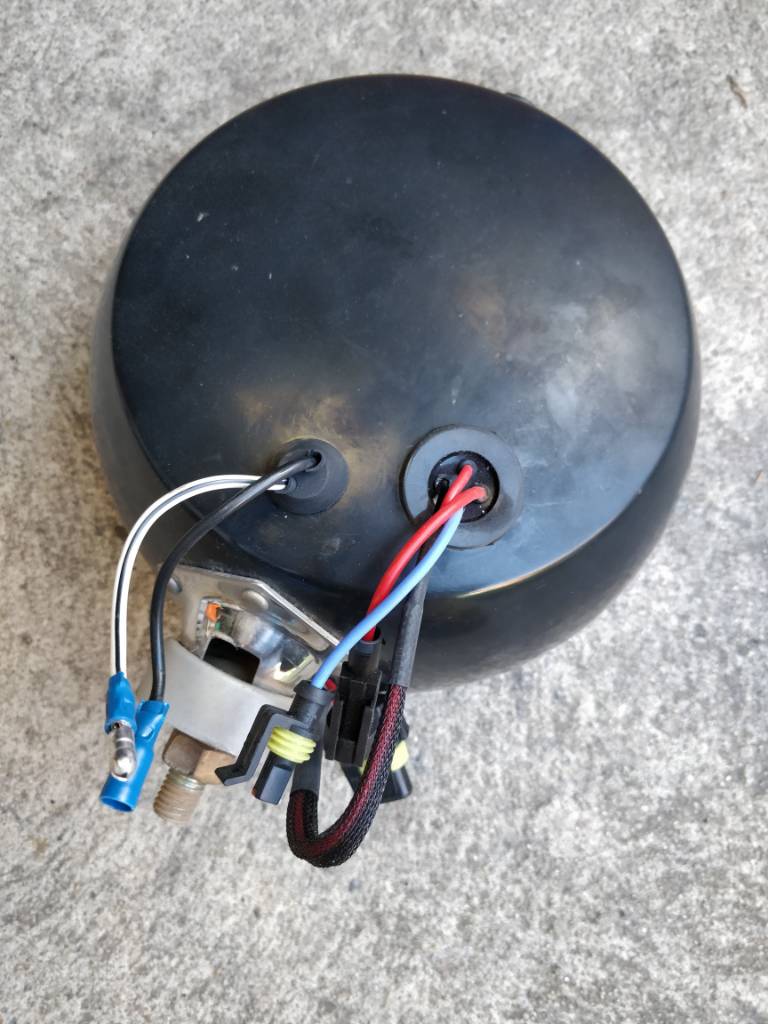

    I bought a cheap 35w HID kit and retrofitted it to my factory IPF spotlights for a little more brightness and a whiter light.
    It all fit pretty easily, I just had to drill an extra hole in the back of the spotlights for the wiring grommet and mount the ballasts to the back of the bull bar.

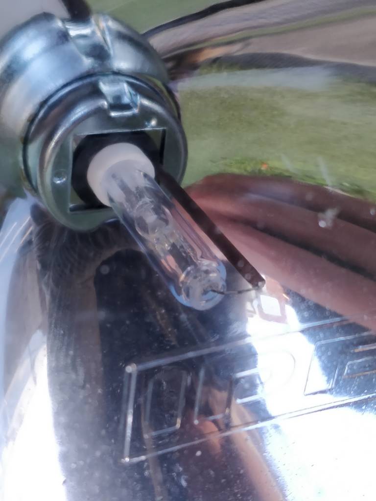

    When I did this using cheap 55w 4300K HID in IPF driving lights they were a bit too tightly focused leading to blinding reflections from signs.
    Putting a washer around the globe so it didn't go in so far widened the beam and now there just right.
    The ballast were behind the grill where the intercooler piping is about to go through so moving them to the bull bar sounds like a good idea.

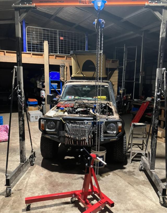

    Stripped Old Golden Grandpa’s Ticker down ready for removal tomorrow and TLC assessment plans thereafter:

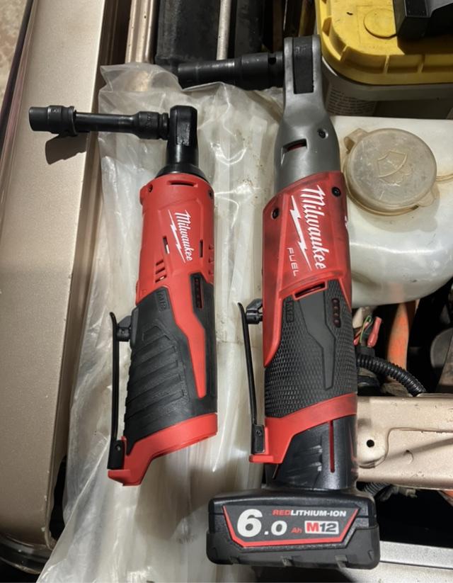

    Borrowed these 3/8 & 1/2” drive new age twin contraptions from work. Highly recommend saving up for them Folks, huge time savers and my wanky injured wrists are feeling great and still ready for another session

    If you have compressed air at the shed, you can buy the pneumatic version of that, which is usually cheaper then the cordless one.
