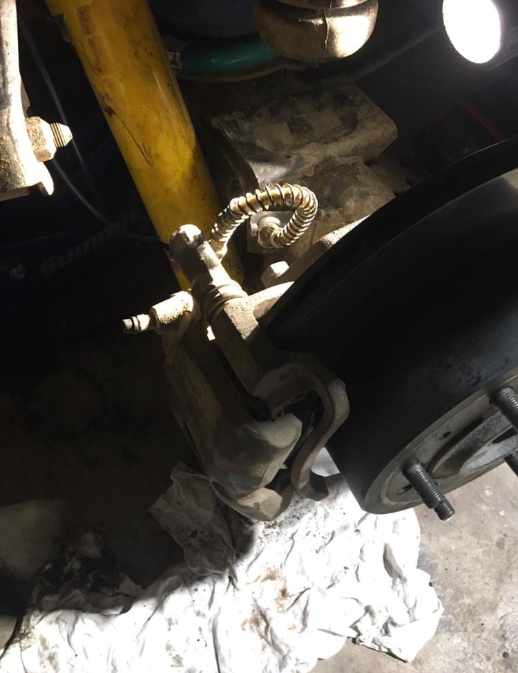

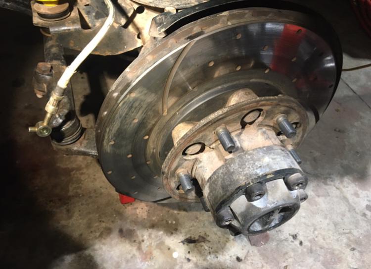

    Rear calipers installed this afternoon with flash new braided lines kindly gifted too!!
    Fronts awaiting a Patrolapart visit tomorrow for a rebuild rubber kit as online Sunday they appear ‘Out of Stock’ for changeover of your previous generosity twin pot GQ EFI calipers gifts and slotted rotors

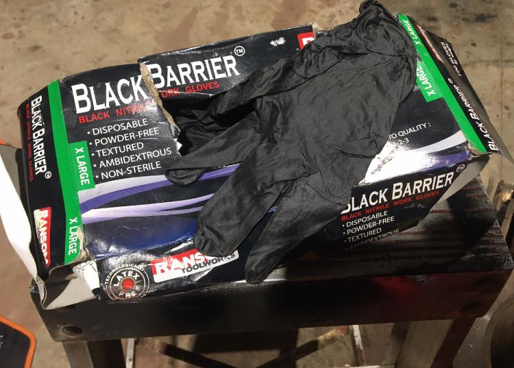

    Watched some Youtubey videos today as I’ve never personally reconditioned calipers before, sexy time gloves are ready to hopefully keep grubby contaminated fingers off the seals going in deep
    One thing is for sure they should come apart a lot easier than when I re-co'd them!! Its not a big hassle for a man of your capability, only time.

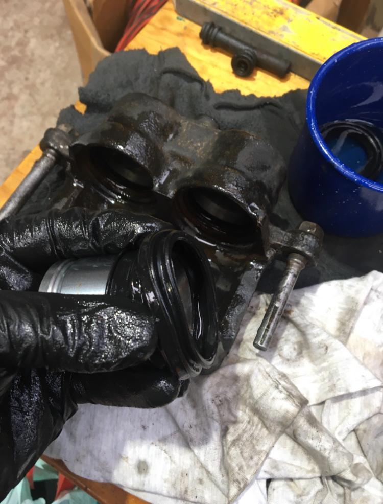

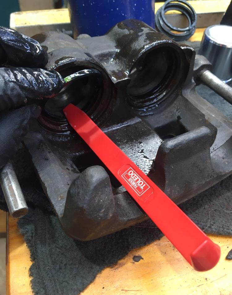

    A little tip learnt the hard way again, don’t follow the final rebuild steps listed and pictured in the Haynes GQ manual:
    Found it to be impossible I believe to safely push the piston through the dust boot as their final step describes without it getting caught against the bore seal and tearing
    This trick below worked a treat and should be updated I hope by Mr Haynes:

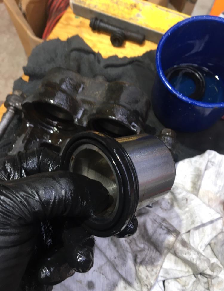

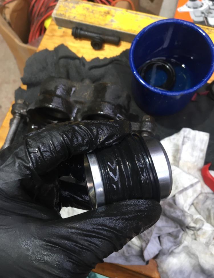

    1) Slide the dust boot onto the piston first and lock its outer seal into position on the outer piston groove:

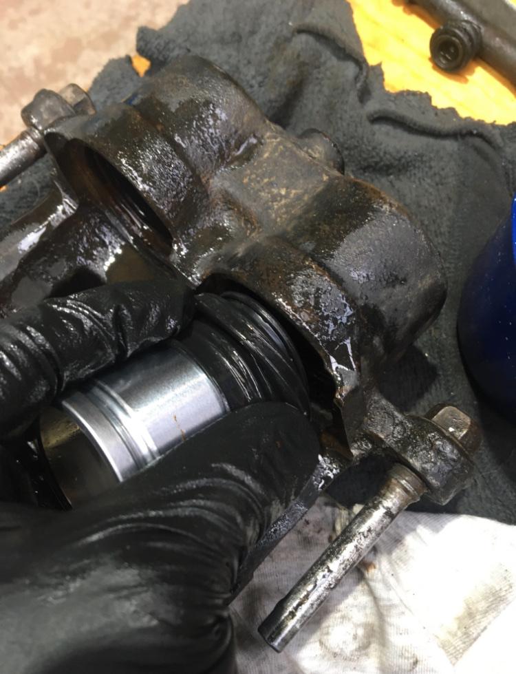

    2) Using the groove to hold the dust boot from sliding, stretch out the boot as long as possible and secure with fingers and thumb:

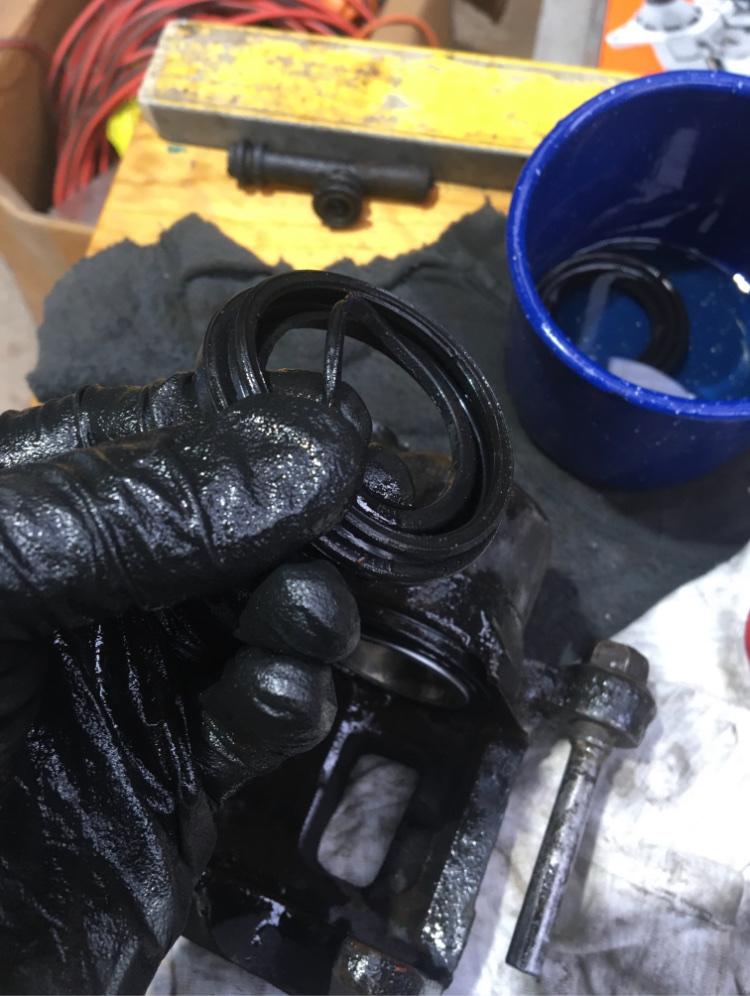

    3) Carefully slide the stretched dust boot forward out of its outer groove and off the end of the piston whilst securing it stretched as much as possible ready for installation:

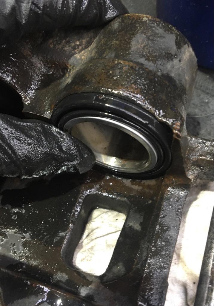

    4) Commence installing the dust boot firstly and once it’s outer bore dust seal is seated carefully push the piston on through its bore fluid seal:

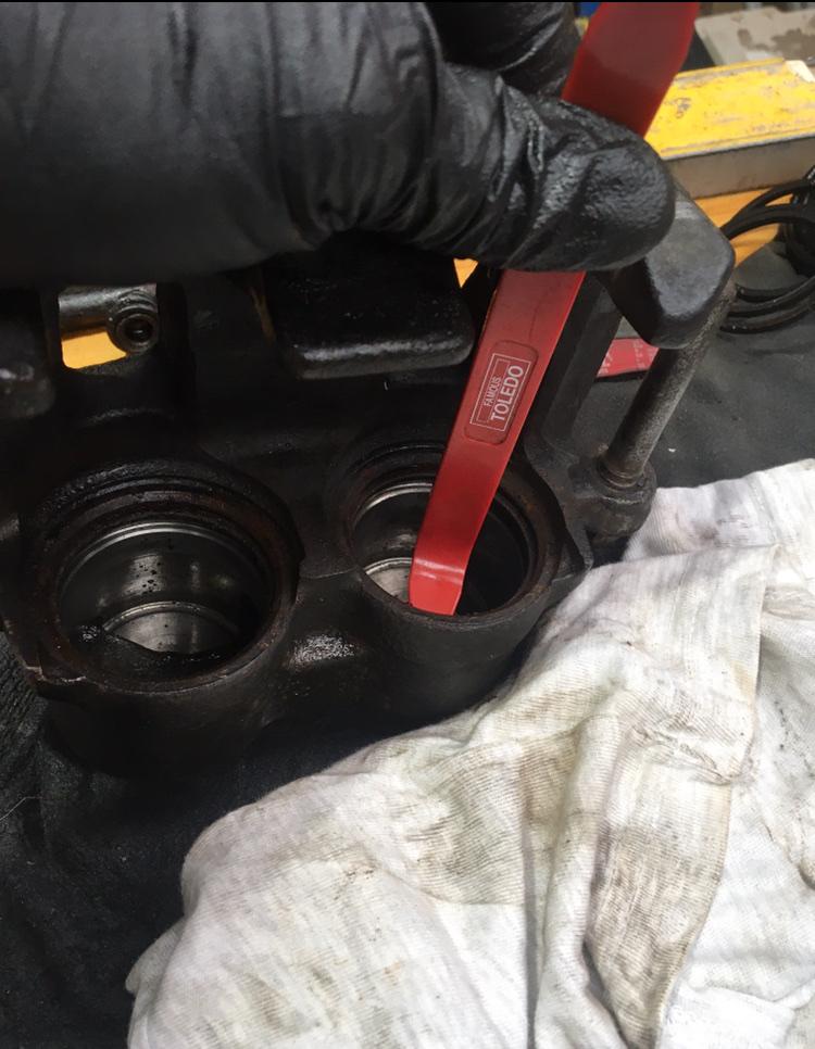

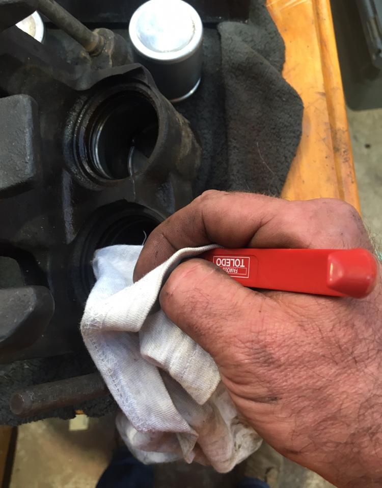

    Additional helpful tools, this plastic Toledo trim kit remover was great for cleaning hard to reach seal grooves and also invaluable assisting in the final dust boot and piston installation above:

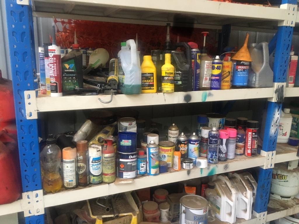

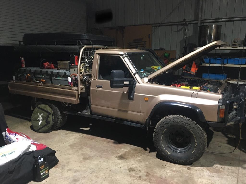

    MB IDIOT Debacle fixed earlier today and appears braking better than ever known before with your old GQ EFI twin pot front calipers Philstar Mate
    Thanks Rossco Legend too for assisting with pedal pumping the last of the hopeful bubbles out of its dead dry system
    95% packed and ready, just need to shut its side gates:
    Put some IDIOT Proof measures in place so this never happens AGAIN
