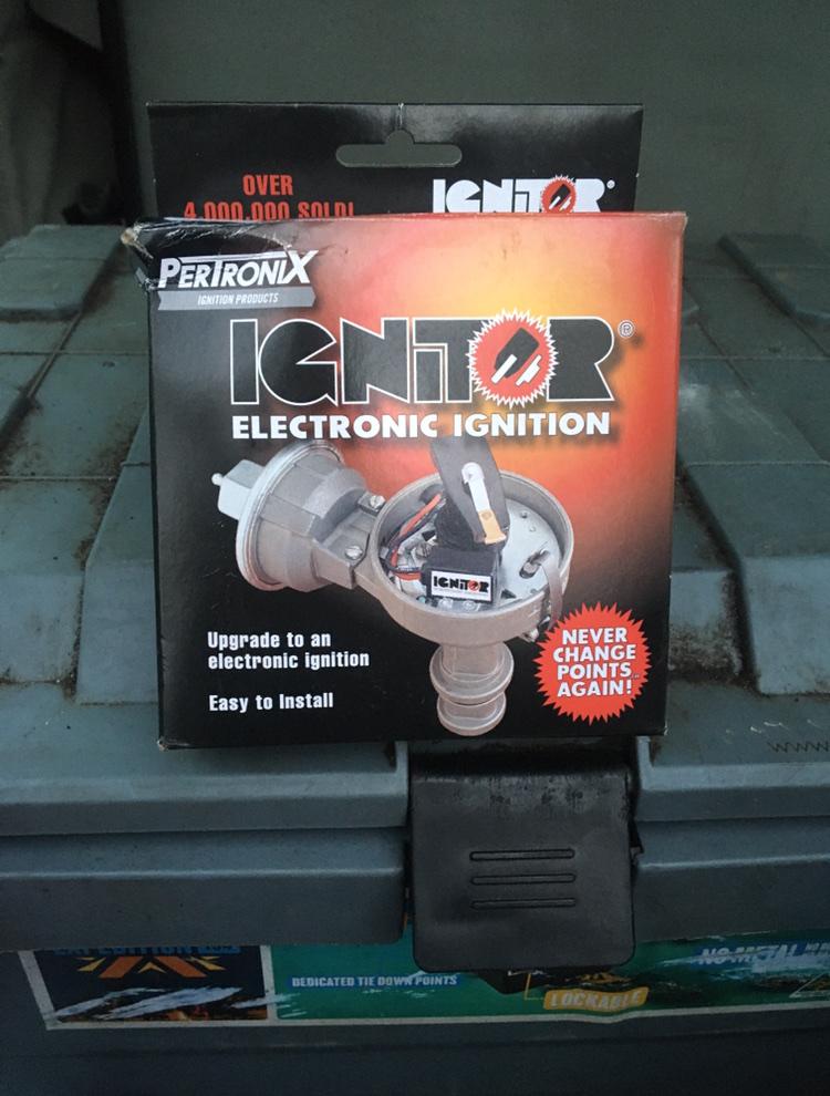

    ……………Please DO-NOT install performance modified longer distributor rotors folks and I’m seriously questioning newfound Petronix upgrades for heat resistance/longevity from previous owners installation too
    I stand by my earlier opinion on the aftermarket extended performance TB42S dizzy rotors that do cartwheel/destroy above.
    Have definitely changed my mind on the longevity potential of the Petronix upgraded ignitor from previous owners install.
    Arrived at final work destination last night and fulfilled a decent days work start today finally. Was greeted by @AB’s overnight Pak&Send thankful parcel of a replacement Petronix from Patrolapart down in Mexico-Lilydale
    Not a minute too late, we crossed some of the steepest parts of the East Coasts GDR at times down to 1st gear low range with hazard lights to reach each roller coaster peak for another downhill 1/2/3/4/5th gear 1,000rpm windup again for the next
    Petronix has held on for seriously 1,000km of hell but didn’t stop completely, FULL RESPECT Mr P Thankyou
