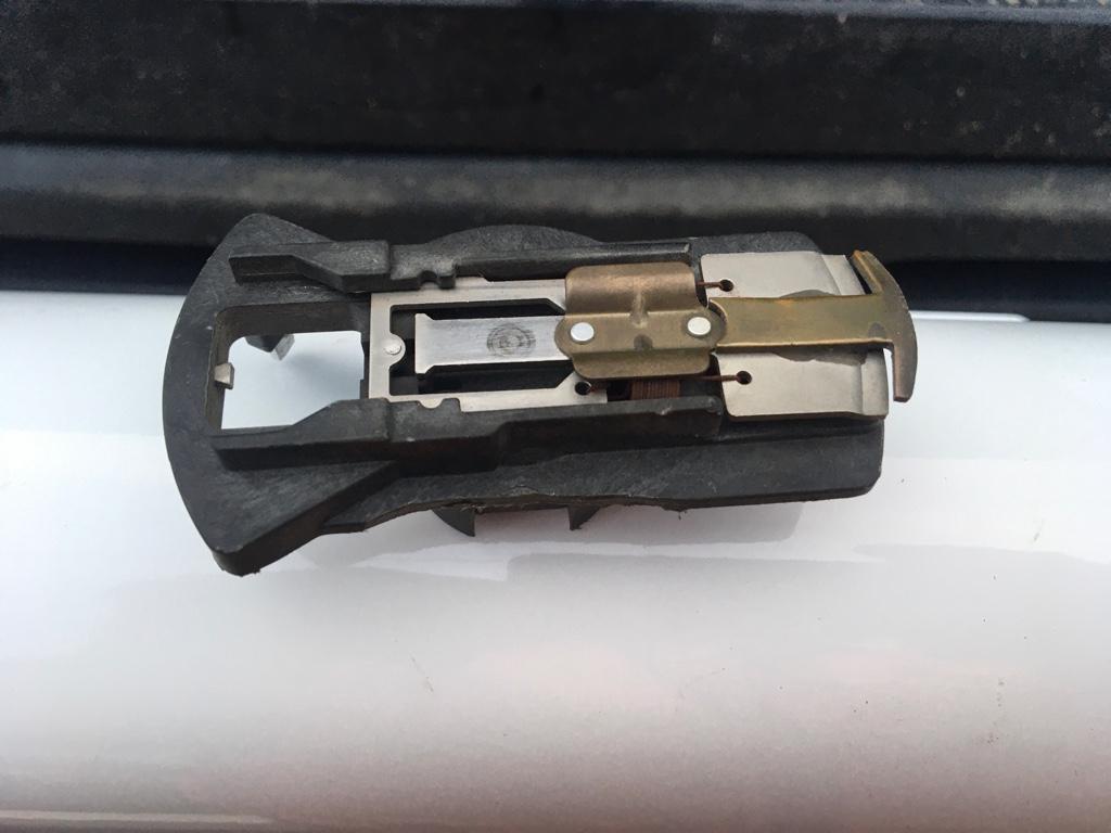

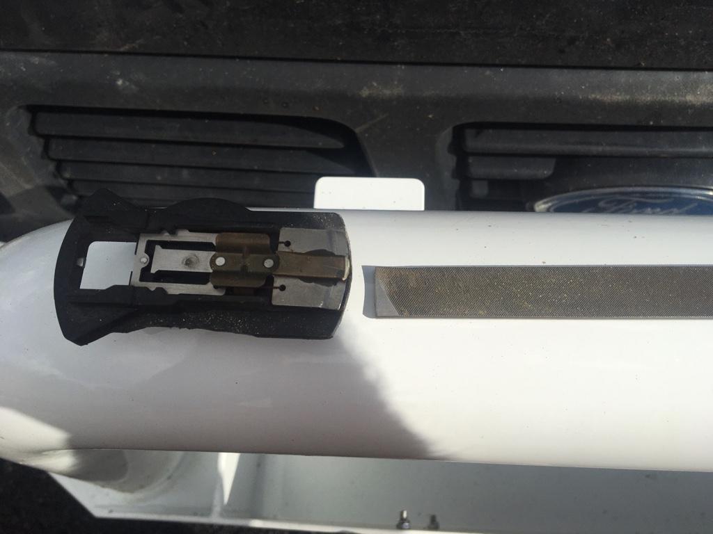

    …………………………here’s hoping Fords 1989 4.5L carbureted engines can handle some nonstop miles like Nissan’s old diesel dinosaur donks
    Fair Diddly Dinkum, I should’ve brought the TD42 faithful slug ute for this work trip
    Two solid pre-sunrise to sun-down days driving, fixing, stopping searching for parts and we’ve only made 1,000km with a mere 2hrs paid work stop this afternoon.
    From start to finish, replacing electrical bits and bobs wherever we could find them we’ve so far installed over the last 500km:
    #Ignition coil (GT40R) almost impossible to find these days in stock out there.
    #All ignition leads, coil/spark, no kits available for TB42S, hand picked for length at various stores enroute.
    #Distributor cap, found the last one in NSW at Dubbo.
    #Electric fuel pump, had a spare in the back.
    We’ve nearly lost all peddle now and putted into Tamworth tonight using torque at 10% throttle and still have another 300 clicks tomorrow to hopefully meet a Petronix ignitor that @AB has kindly express posted from Mexico
    A long story picture short, diagnosis’s has been confusing & tiresome over many kms:
    Cooling down the suspect hot coil every 50km originally:
    Replacing all leads……..better for a while.
    Finally noticing distributor cap damage:
    Tracking down a new distributor cap……….
    Modify the aftermarket rotor back to standard OEM length from previous owners performance enhancements:
    The OEM rotor balance spring/weight that counteracts cannot cope with this heavy extended performance modification and has assisted slight dizzy bearing degradation/wobble in my nuffy opinion, hence the previous severe cap uneven damage.
    It has been a weirdest ever changing diagnosis fault on any vehicle I have ever owned and finally tonight have much clearer consistent symptoms of it being like cooked points of old except it has an aftermarket Petronix replacement ignitor custom installed

    As soon as is possible (back home hopefully parts available) this little shorty will be converted back to OEM full specs of points & condenser with a spare set thrown in the ashtray for changeover every 100,000kms
    Please DO-NOT install performance modified longer distributor rotors folks and I’m seriously questioning newfound Petronix upgrades for heat resistance/longevity from previous owners installation too

    Looks like that dizzy itself has worn out. The shaft might have too much play in it by the looks of that pic.
