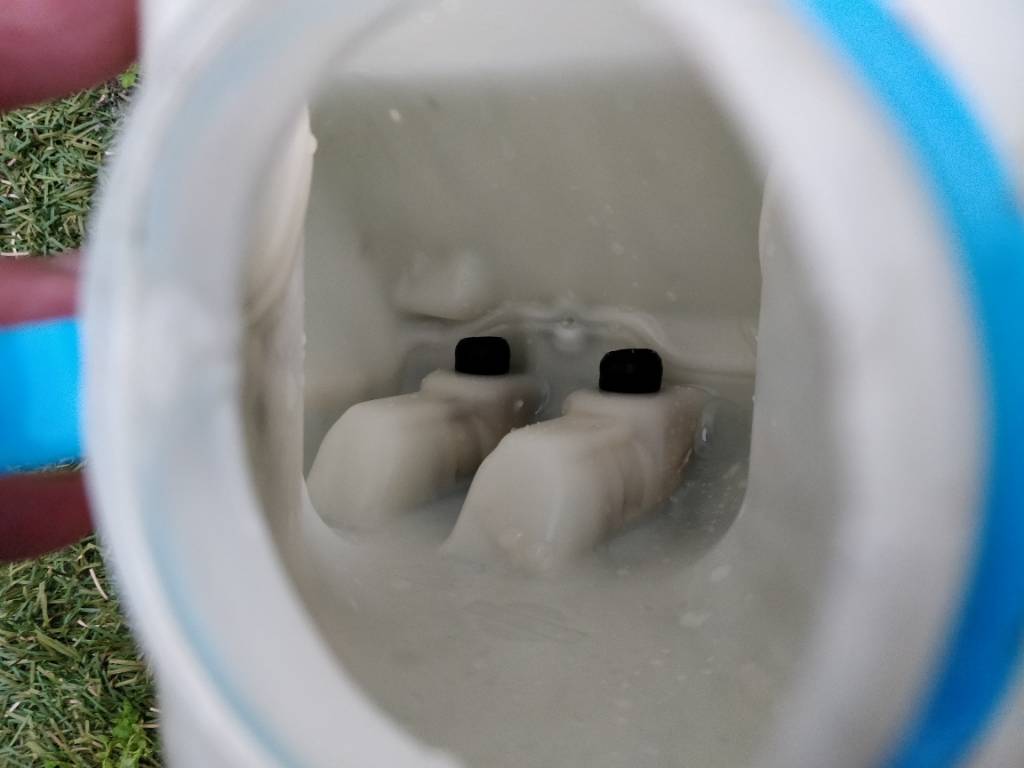

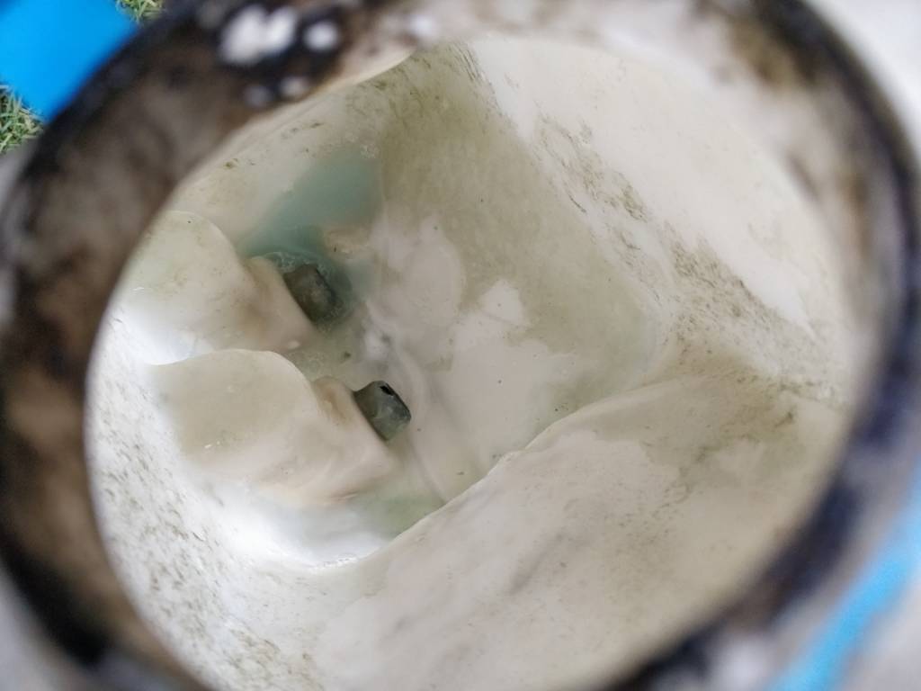

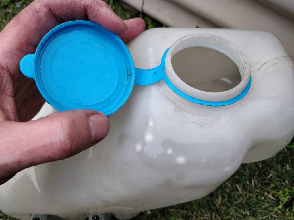

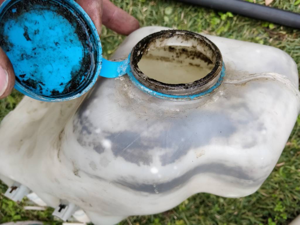

    Cleaned out the washer bottle as it was stagnating. The thin lining of scum was being sprayed onto the windscreen and it did not smell good!
    Washed the bottle and the lines out with vinegar and water and it's working again properly now

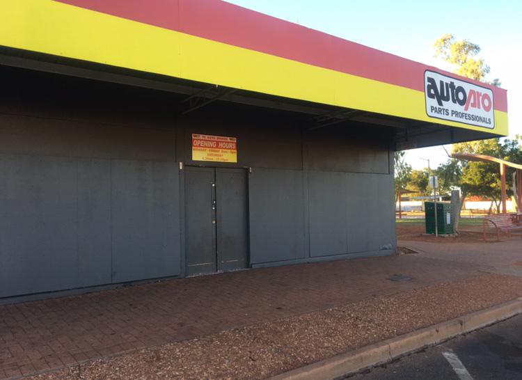

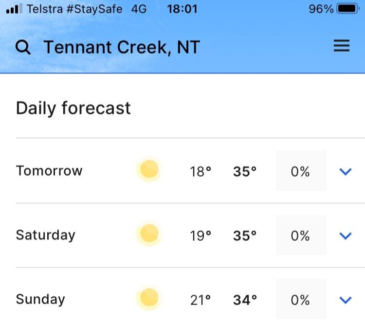

    Upgraded the old TD42 A/C idler bearing a coupla of days ago down in Tennant Creek thanks to Autopro Legends opening up early for us

    You going soft young fella??
    Hurry up and get back here, you won't need that AC at Licola bid.
