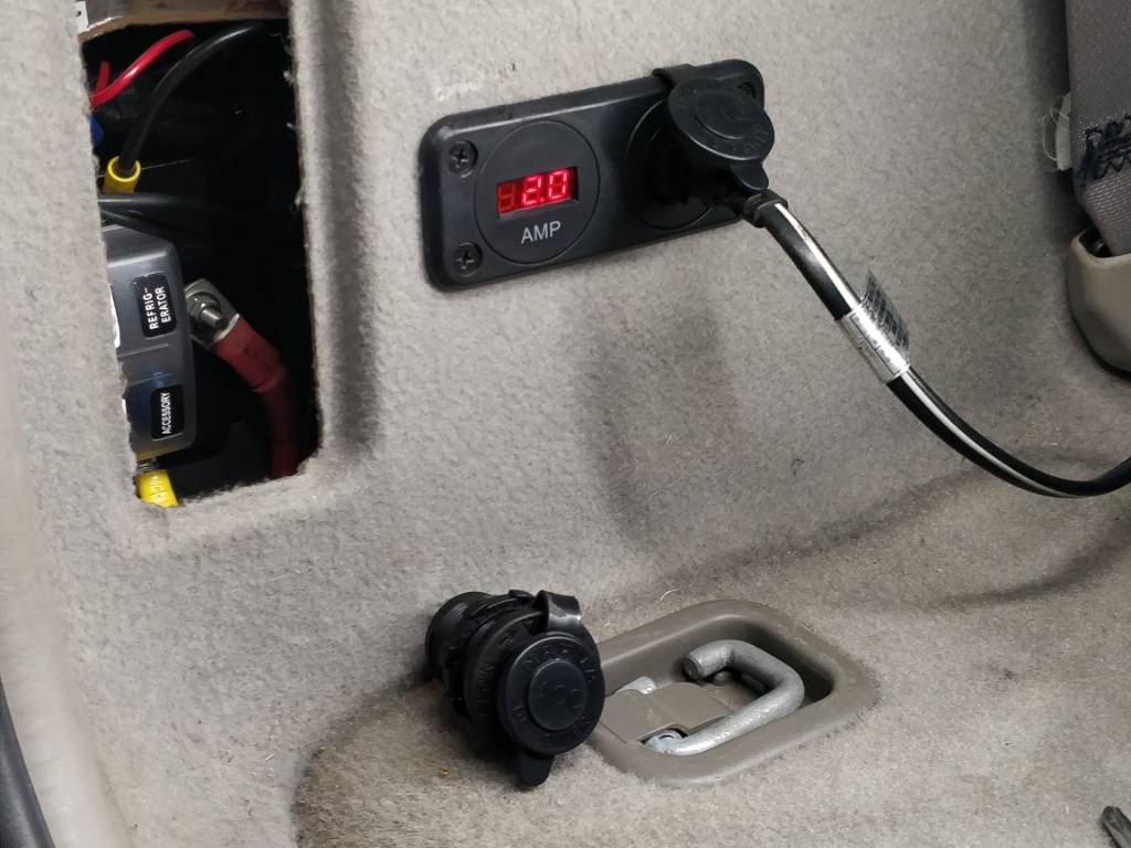

    I removed the acc socket in the rear cargo area and replaced it with a Narva amp meter. These single amp meters are on clearance from Repco for $16.
    I had not used this socket once in the almost 3 years I have had it installed, so the amp meter will be more useful in it's space to monitor how much the fridge is drawing.

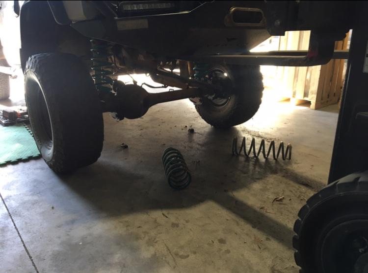

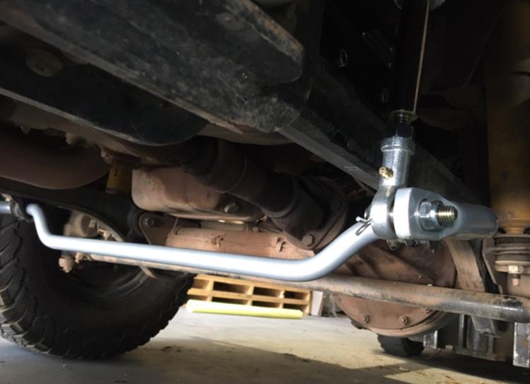

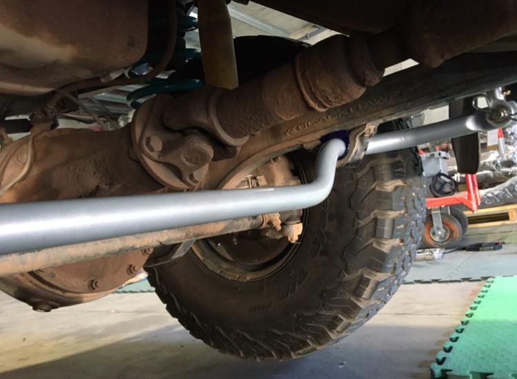

    Finally installed the GQ ute front Superior-Engineering drop down sway bar version today:
    Forgot I must’ve ordered the linkage disconnect ends as well but not sure I’ll end up keeping them on at this stage as the light removable pins each side worry me a tad for strength/snagging and I’m a pussy when it comes to flexing completely off angle sideways on our hilltop tracks.

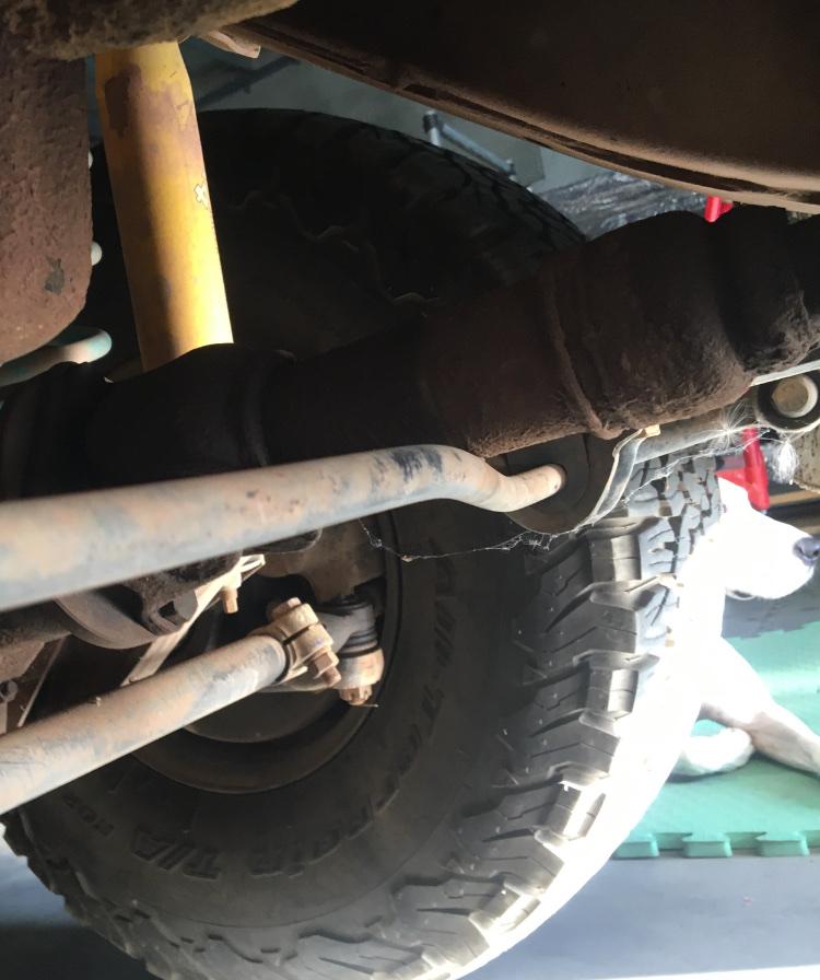

    Reason for this purchase a while ago now was due to my Black-Hawk high clearance radius arms unbeknownst at the time do not work with an OEM sway bar configuration, albeit only a tiny bit bent but has been gouging a groove in my front tailshaft off-road with down travel found:
    Forklift made light work solo too for swapping new coils over front & rear:
    Trialling Dobinsons C45-108 in the fronts, 75mm lift with 60-100kg linear rate constant load there & C45-325T in the utes rear with 150-250kg linear rate constant load back there. Airbag Man 3” rear kit has now gone down to only needing around 5-10 psi in them fully test loaded with tools & tucker but an empty near 300L diesel storage capacity capability is still below if touring/work needed

    Sway bar looks way fatter than standard Nissan setup, have you had much of a chance to see how she goes in the corners reckon Nissan one's are near on useless lol. . .

    Only a quick 5 minute spin around town so far Rossco but felt positively different for sure. Can’t make any comment on the front sway bar as yet but upgrading the rear springs from C45-123VT 200kg variable rate constant load feels shiploads less boaty now full of tools at under 10psi running upwards of 40-50 psi kevlar bagged floating on air only previously.
