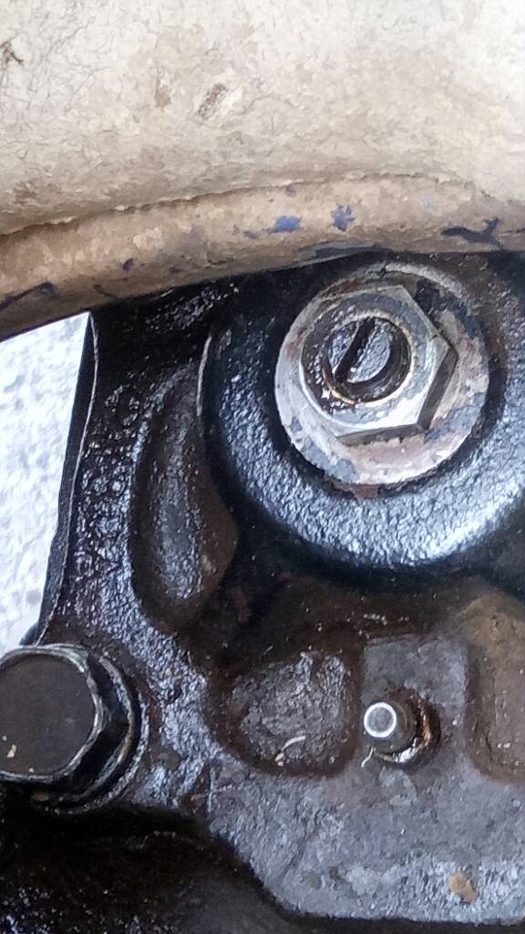

    After putting the streeing box back together I left it alone. Today I went for a 15min drive focusing on turning. Got back and had a look.
    Dry.....

    Power steering box has stopped leaking whatever it was leaking out. All other fluids are OK.
    A/c bearing doesn't seem to be that bad so I'll just monitor it.
    Sway bar wasn't snapped on the last trip. I noticed that the front corner was sitting lower a few months ago and just didn't do anything about it. I took it out today and sitting level again.
