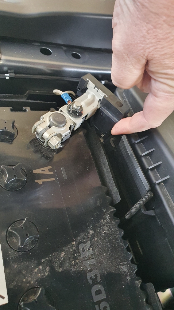

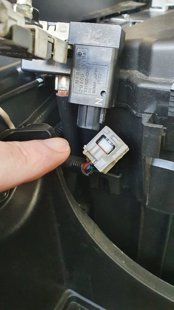

    So the Shunt is attached to the side of the negative battery terminal. Right here.
    First disconnect the negative terminal with the 10mm socket and put something over the battery post to stop it arcing while you work.

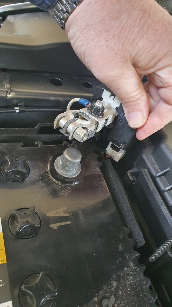

    Lift the terminal off and you can see the shunt.

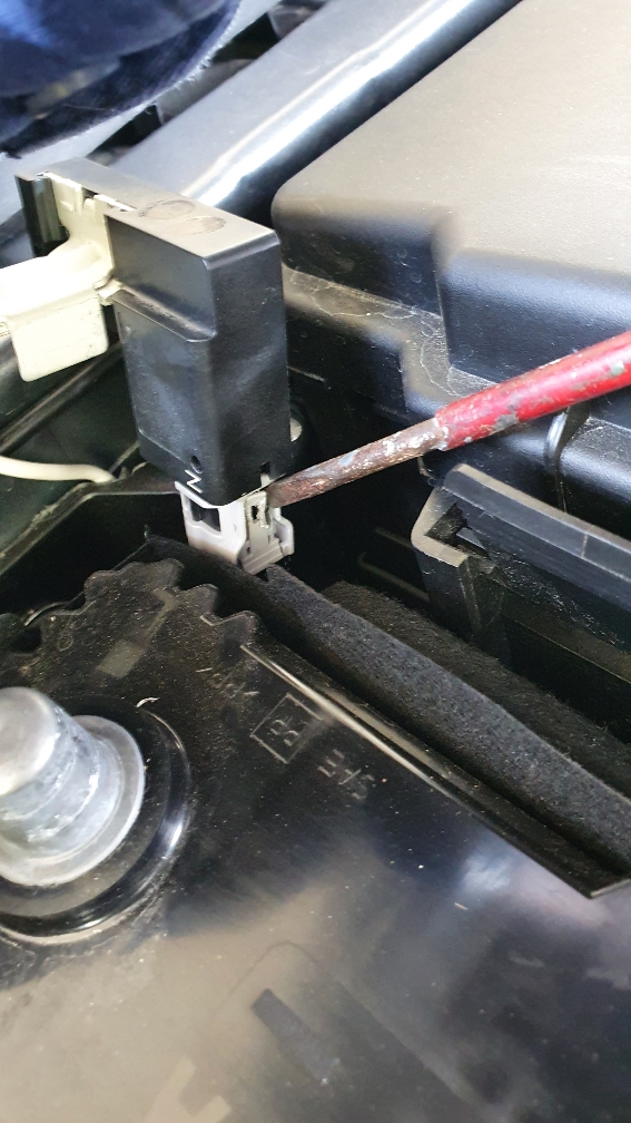

    Use the screw driver to leaver under the crazy little clip on the side. This was a bit of a bustard but it got done.

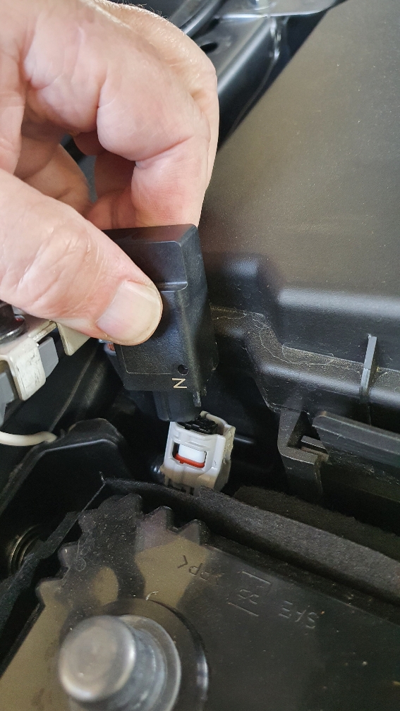

    Pull that sucker off.
    Then shove that sucker down the side of the battery and forget it was ever there. Never to be spoken of again.

    Instead of levering off the top of the retaining clip with a screwdriver, push in on the bottom of the retaining clip and it pulls straight off.
    hahaha. cheers mate. I did look for somewhere to push but im going blind. It got done, push makes way more sense.
