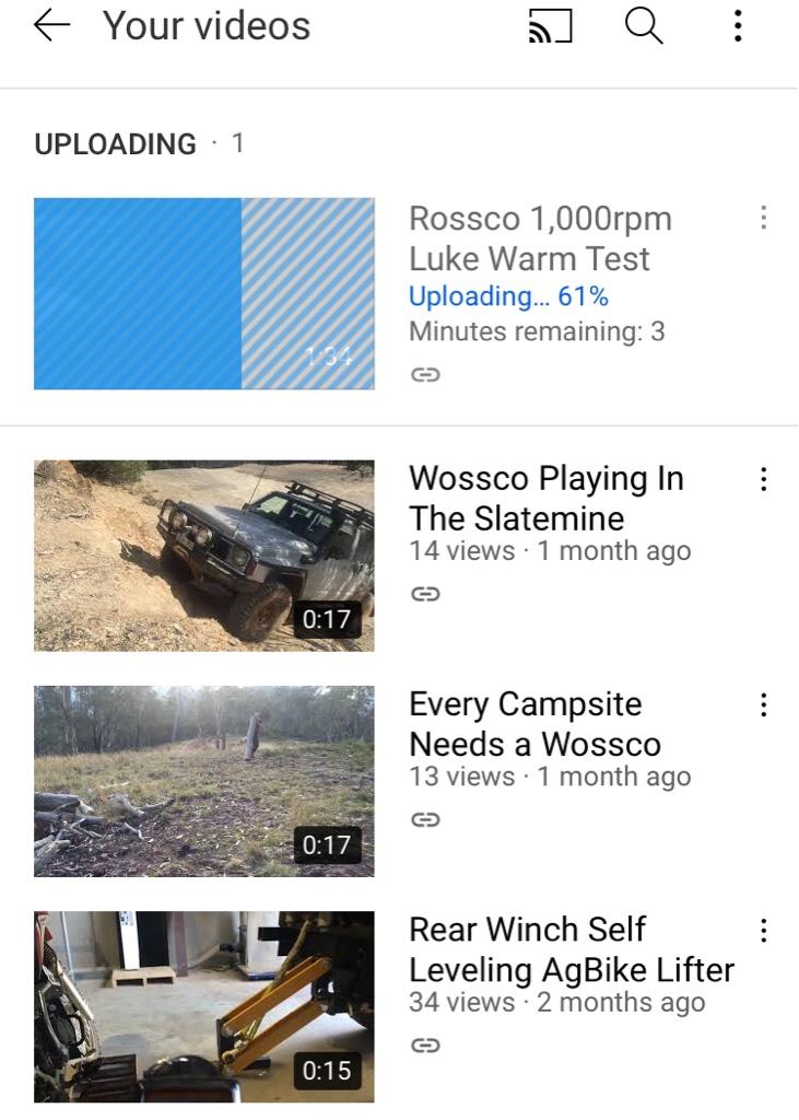

  15. #29
    Thanks Rossco Mate
    Test performed just before, satellite is about to explode uploading such a massive video file
    Won’t be too much longer hopefully
  16. #30
    All done:
    https://youtu.be/1K4NrpNZjrc
    The old clacker definitely has rocker fumes, even lukewarm testing but I’m assuming they’re the particles it’s catching in its new can?
