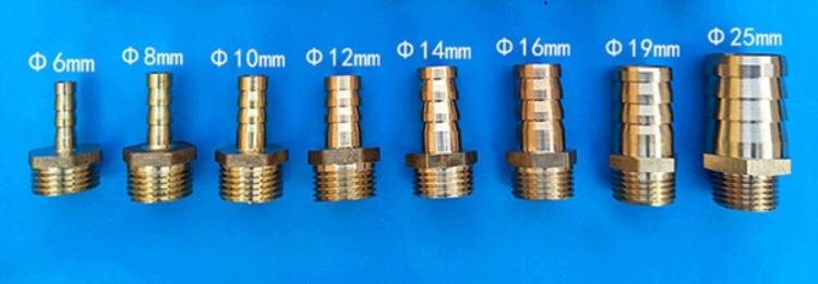

    I did the same a few year back and just ran a tap through it and screwed a barb fitting in with the aid of a little liquid thread tape. Never leaked once. Was actually stronger than how it was...

    Sounds like it could be a handy fitting to keep onboard if it ever was to easily happen to us all out there.
    Was it simply something like this you used to keep rolling Mate?

    Exactly mate. Just can't remember the size I used. I think it was a 1/8 NPT thread with a 1/4" barb from memory. I drilled out the hole first to suit the thread I was going to tap first, just like you would when tapping a metal thread...

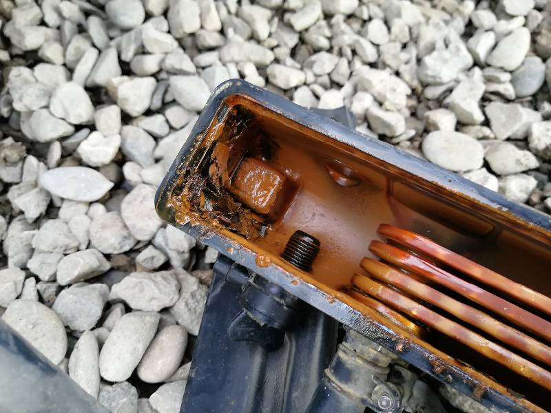

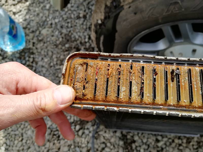

    Maybe it is possible to solder the old fitting? Now there are plastic electrodes for various plastics. Radiator tank made of PP plastic.

    Although I just changed the tank.

    SCA had a fitting on the shelf which had the right size barb for the hose and a big enough thread diameter to go into the hole. Used a 12.5mm drill to clean out the hole and then used silicone grease and the actual fitting (back and forth) to tap it out. plastic there is around 2mm thick so made sure I got 3/4 of the thread inside. Bit of thread tape and it's done.
