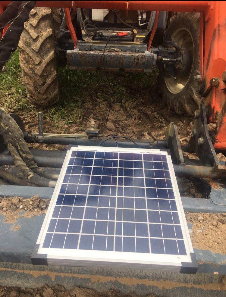

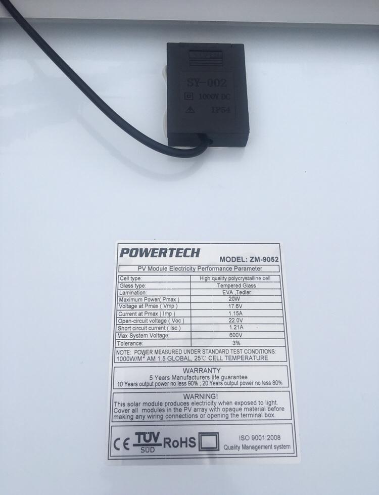

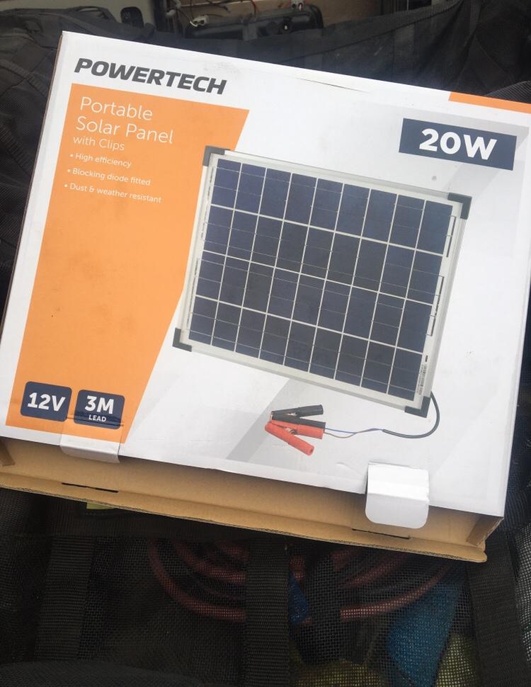

    Confirming did the old ‘Jaycar Click & Quick Collect’ for a couple of Rusty_Nails & PeeBees phone advice panels on the way home from work.
    20W/1.15A direct onto the tractor battery (Lead Acid 160 RC Minutes) if I understand everyone’s thankful advice should loosely convert hopefully to 100+AH safely?
    Will look towards a third flash bluetooth type remote version for dam pump down in the valley once time & money permits thanks heaps again Gentlemen
