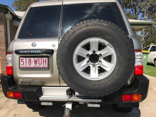

    I have a frame that goes around the rear window for work lights. (first photo)
    I have an awesome led mounted under my jerry can box which is on the reverse light trigger. (second photo)
    The second photo also has my first go at a rear light bracket, the first photo has the second style of light frame.
