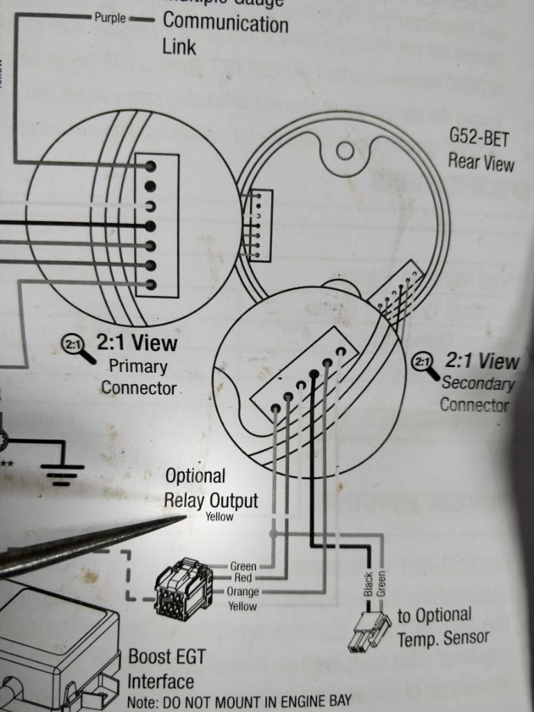

    Hey @MB, did you sort this out?
    I was just reading through the operating instructions for the redarc G52-BET and thought you could use the optional temp warning level on your redarc gauge to trigger the relay output and power on your second fan when it hits 95°.
    You should only have to buy a relay to test this out.
