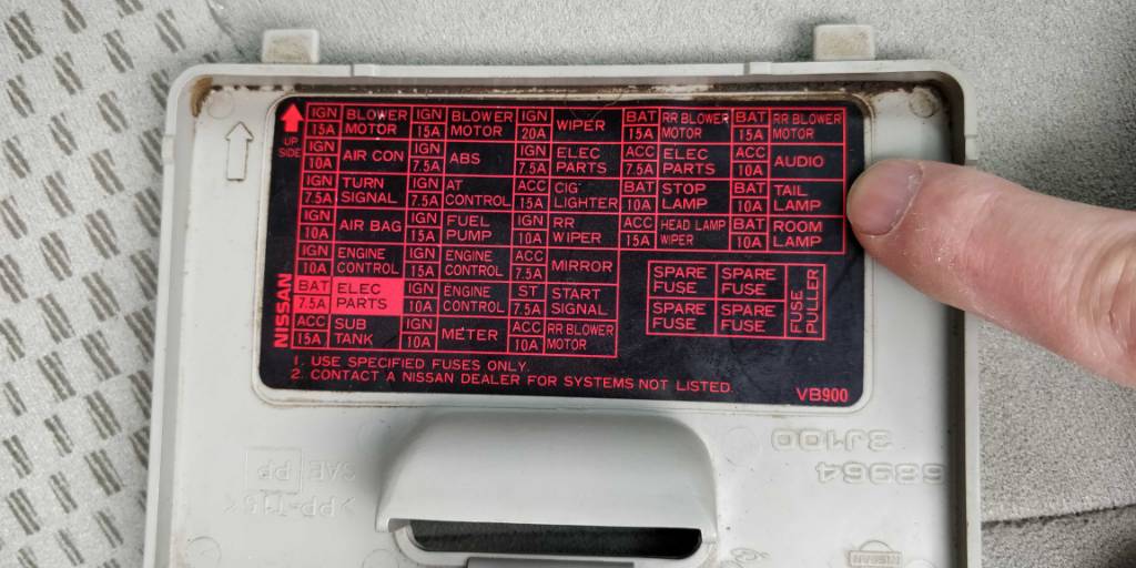

    I haven't had much luck with trying to reset the sub tank controller by pulling the fuse. Are you referring to the 15A fuse in the bottom left (lid photo above) of the fuse panel?
    I've tried removing it with the car off, leaving out for 20 mins, refitting and starting car.
    No good.
    Removing with the car running.
    No good.
    Removing when the car is off, then refitting it when the car is running.
    Still no good.
    So far only removing the earth wire from the battery when the car is off, turning on the headlights to flush any residual charge, then refitting the earth lead and starting the car clears the sub tank error light.

    Fuse 24 - 7.5 amp
    Amongst other things it is the Battery supply to the Sub Tank Poota.
    Pulling it should reset the Poota and next time you turn the ignition on the Poota will do a self test.
    If there is fuel in the sub and the main is not full after a minute or so if there is no fault then no warning light and all is good... if there is still a fault the warning light will illuminate and the pump will stop.
    Checking the codes is a good idea... helps pinpoint the area that the Poota thinks is faulty.

    Ah ok, I've been pulling fuse #27 labelled sub tank, I'll try that fuse #24 you mentioned.

    Pulling fuse #24 worked to reset the sub tank warning light. It also resets the odometer, which I was hoping to avoid, but it's certainly easier than removing the negative battery cable.
    Cheers for the tip!
