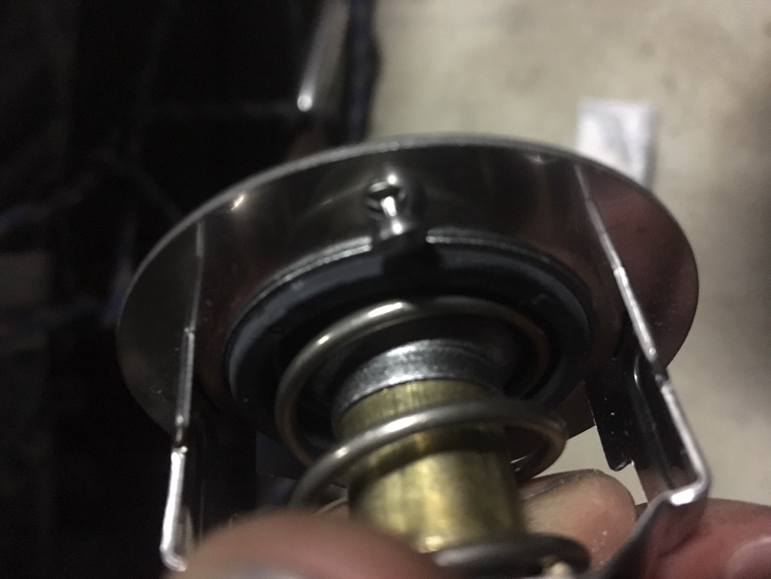

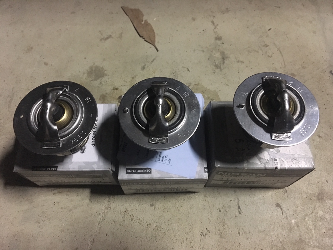

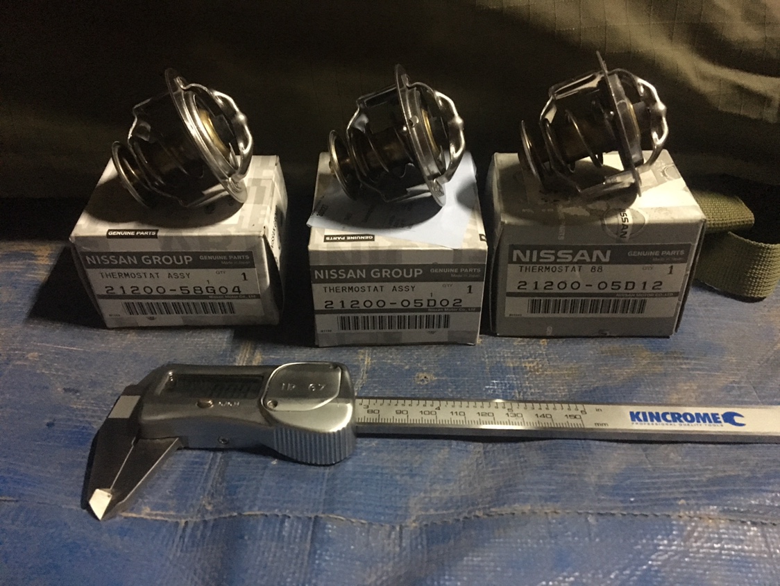

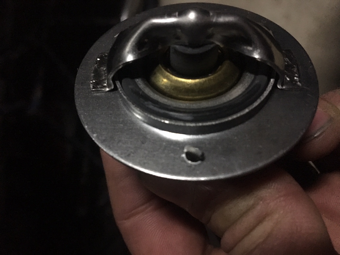

    Well the good news is that all three appear to have identical dimensions including the TD27 88C according to the verniers.
    Only difference I can find under poor light is that both the 82C & 88C have the ‘Jiggle Pin’ and rubber gaskets whereas the 76.5C does not have either.
