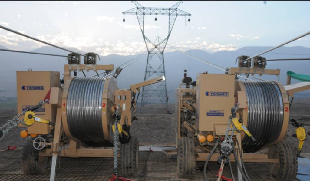

    We use a very similar concept on a larger scale when spooling on re-conductoring ropes, firstly started with a large clove hitch around the drums.
    Trailer will get off the ground way before the rope even considers detaching.
