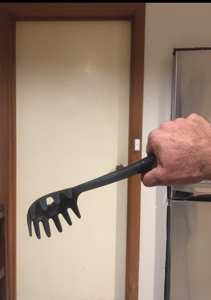

    Cooking & Or Baking Thread Stolen Idea
    Best ever Swarf itchy removal tool if you’ve been wriggling around on a shed floor welding too

    Yep, we use a steel one, they work very well.

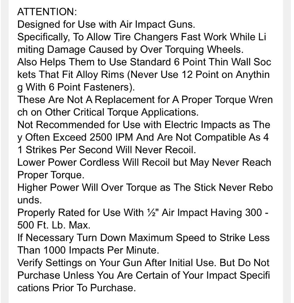

    I’ve seen this warning on the cheap torque sticks on eBay
    Note it states to turn down to under 1000ipm

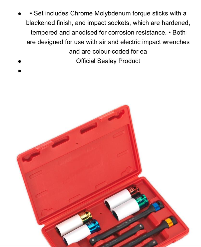

    The more expensive torque sticks state for use with air and electric wrenches
    The local tyre place found, very quickly, that using these to tighten the nuts from the start, can over rev the gun and cause the torque stick to shatter when it comes to a hard stop. They used a normal extension to nip up the nut, swap to the torque stick and do the final torque.

    Can someone educate me on what the Torque Stick does??? Is this instead of using a Torque Wrench? are they Trustworthy?

    well spoken Bruce, I was wondering this too.

    Basically they act like torsion suspension. They take time to twist and spring back with each hammering they receive from the rattle gun. This reduces the peak torque the gun produces.

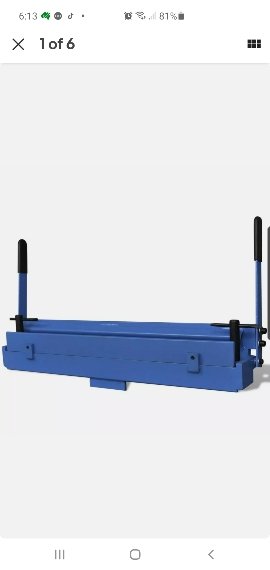

    I have a couple projects underway, here are a couple of additions to the shed once the postie brings them.
    650mm wide ans 120 degrees. Most others seemed to limit to 90 degrees which was not enough. Bonus it was about 40% off.

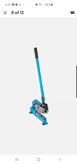

    Next
    300mm long guillotine. Cant wait.
