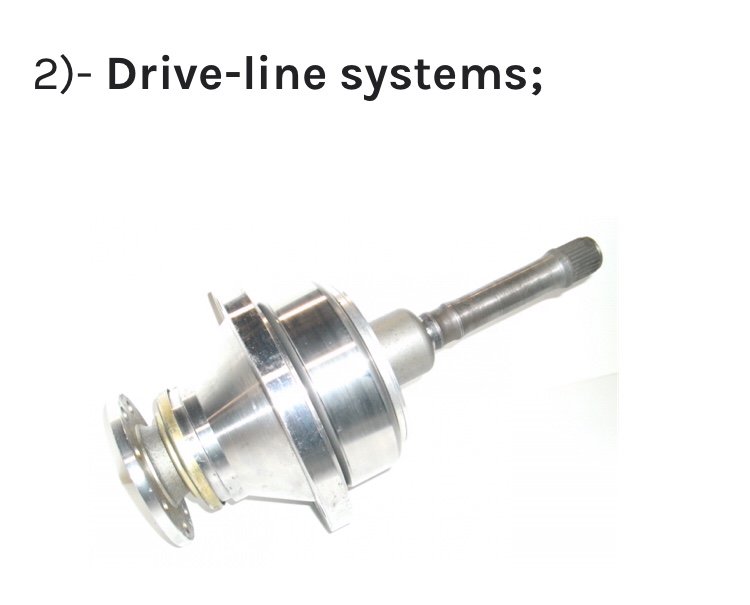

    Wow, that truck is quite the weapon Cuppa mate!
    I’m no doubt using the wrong terminology above but if you have a read through Bob’s website link above can explain his system better.
    Still load sharing as per pictures snippet below.
    Patented I believe power divider between the two rear diffs.
    As I understand the centre CHS pipe framework allows the axles to ever so slightly splay apart on tarmac cornering too which is a huge tyre scrubbing advantage for touring over rigid leafy 6x6 versions.
    This system is a must for off road setups as a standard twin drive line a truck you'll be snapping uni joints in no time.
    If you can add a second pivot in the way of the rocker so both rears can move independent of chassis but together somewhat you'll be much better off.
    Make road worthy and engineering a little harder.
    But the ultimate setup..
