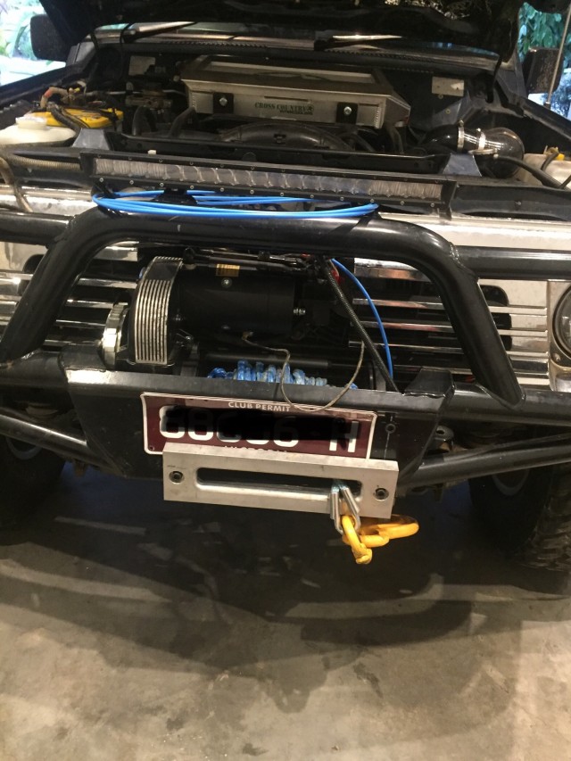

    Went up to the local for a quick overnighter last night, was good even if it starting raining as soon as I got in my swag lol

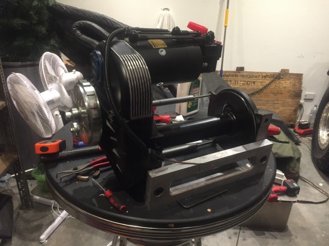

    The last two bits for my highmount turned up, now has air freespool so whacked it all together

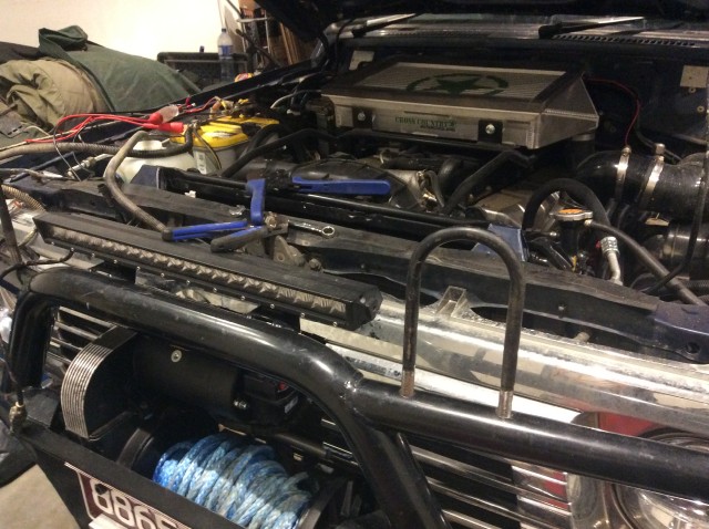

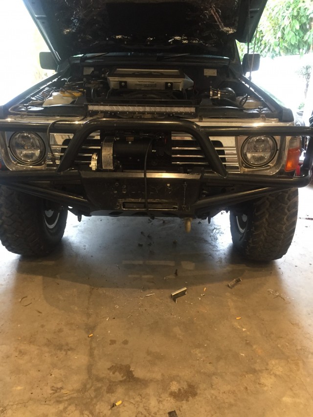

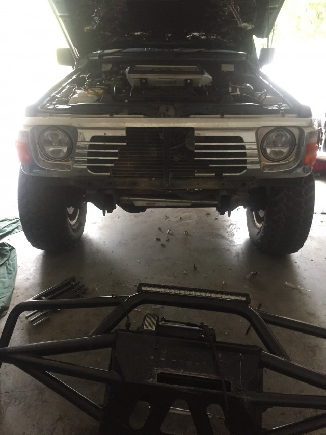

    Then cut the grill to suit and modified the bullbar to suit the +76 drum
    Fitted it up to the car to see whether I’d cut enough
    Then fitted the rope off my lowmount and a cheap fairlead I bought to test it out, just need to tidy up all the wiring and do some minor welding on the bullbar, this bar is definitely not designed to take a larger winch!

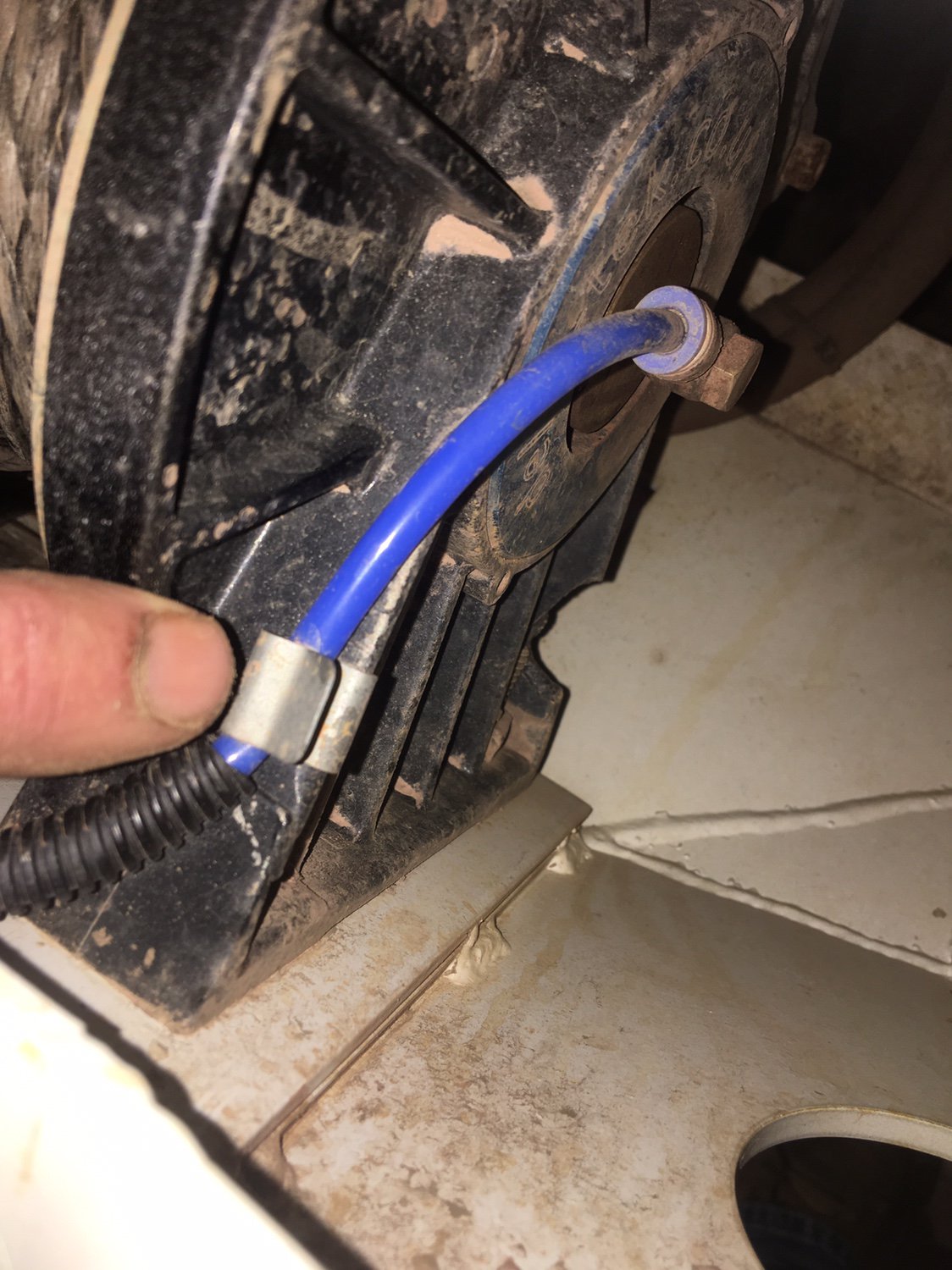

    Please be sure to install that air spool line clip on the HM plate side as close as possible, especially when new they rotate very hard well sealed once found:-(

    Back up top to the good old shed queen now Dave mate! Hope this picture makes sense?
    Typical bloke style me when installed the oldish UK-Delta +76 too, she’ll be a rats twisted nest soon MB enough:-)

    Thanks for that mate, I’ll have a look when I run the air line, I’ve only just fitted the line as I couldn’t access the end of the drum in the bar

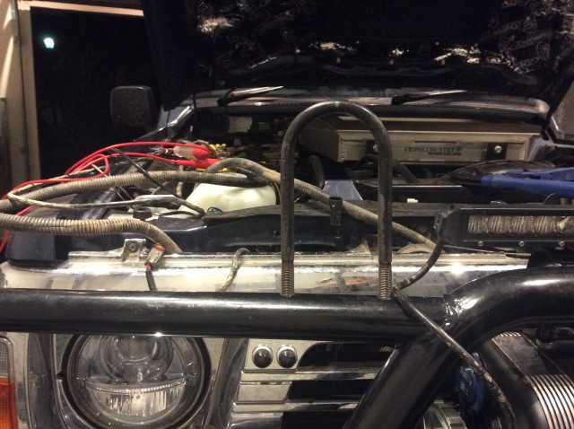

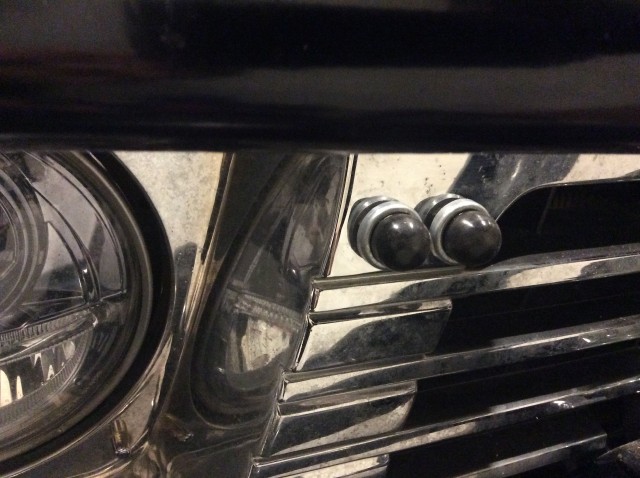

    Added some push buttons on the grill so I can use the winch while outside the car as I have incab switches. Then repurposed some U bolts to use as winch horns.
    The bars coming back off tomorrow to get welded up then I can do all the final wiring and fitting and spool some rope on under tension!

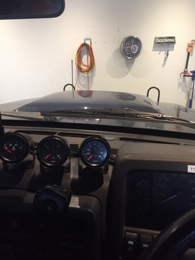

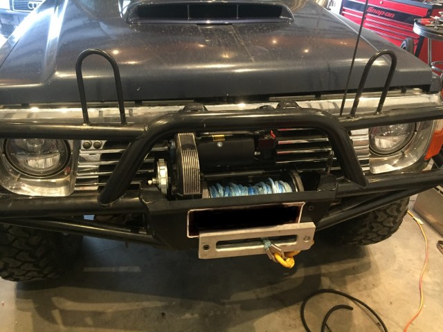

    Welded in the winch horns, removed my light bar and I’ll get a smaller one to mount under the hoop, fitted the winch up and wired it in completely, plumbed up my air free spool.
    And here’s a view from the drivers seat!
    Just another Blue over Silver GQ with another TD conversion

    Absolutely gotta love GQ flat center dash space, shit hot tops Dave mate
    If time permits, die grind a wider/higher fairlead space to allow a ‘Big-Mouth’ type fairlead to forgive a figure 8 emergency knot to pass through they say :-)
