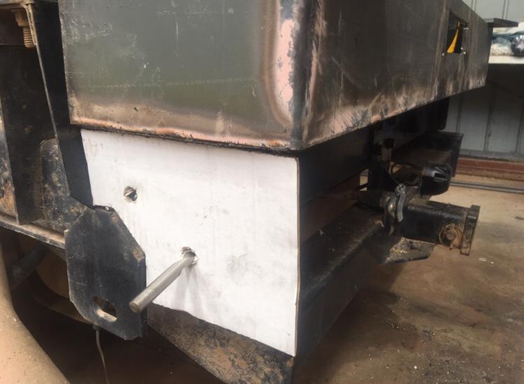

    A couple more baby steps today @PeeBee Mate!
    Working on the side rear end mounting plates 12mm.
    A trial & error cardboard template first:
    Does anyone out there kindly know what correct size & thread pitch our GU utes rear outer chassis end bolt holes are?
    Would like to securely bolt in place these plates with correct size 8.8 grades before welding next steps pretty please

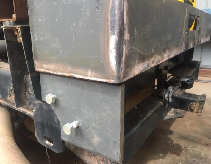

    Looks good Mark, keep going, another 80kg of plates and 20kg of butter welds should suffice! That is going to be a very robust platform for the Sherpa winch - no problems.
    Metric fine pitch bolt options are M12x 1.5, M12 x 1.25, m14 x 1.5, M14 x 1.25, M14 x 2.0 (coarse) (M12 x 1.75P (coarse) Grade 8,8 minimum as discussed. You have plenty of support designed into the assy.
