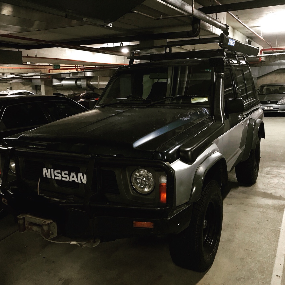

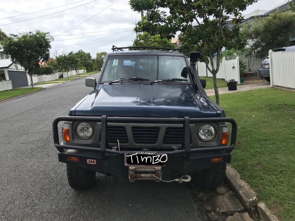

    Picked up a roller; gonna now transfer all the running gear: engine, transmission, exhaust, shocks etc swap as well as replace any panels to build up the best of both rigs! Finally a respray in metal/silver colour to keep the original theme going! Will keep ya posted on the build

    Nice one enjoy mate sure it will turn out nice. Did the same with mine, respray in the original colour so it turns out looking like the original car only heaps nicer. Looking forward to the pics / updates. . .

    Nice colour mate, don't spray it lol

    This bodies a two tone, so not as cool as your rig AB

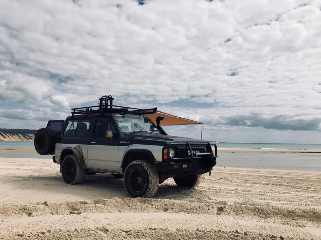

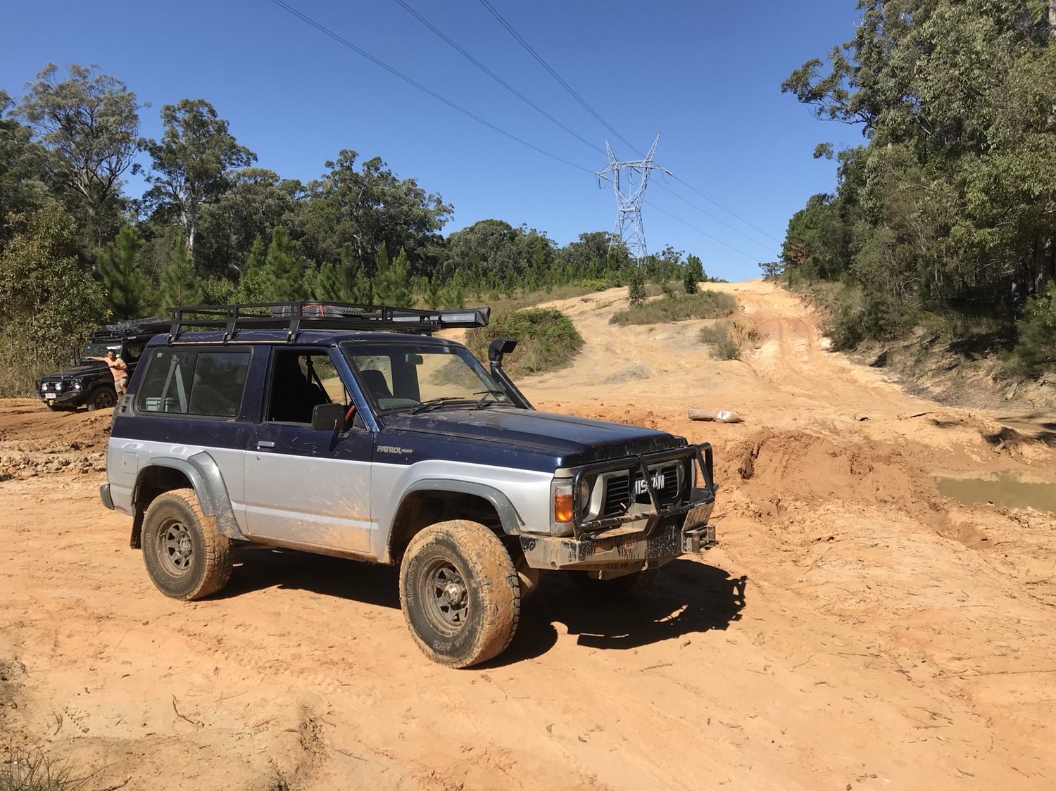

    Has been so much fun working on the GQ, very impressed with it off-road, pumped to keep in getting out and about camping

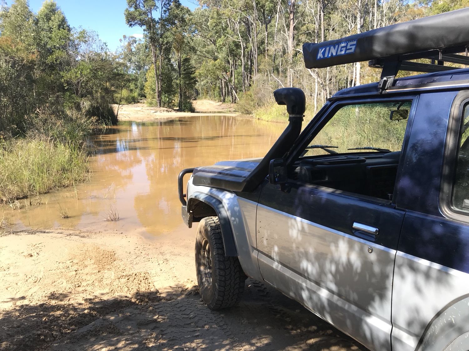

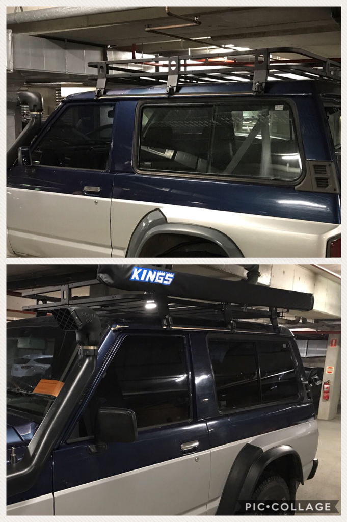

    Tinted back windows
    Loves the beach:
    I’m yet to give it a paint touch up, due to lack of space at my joint, but I’ll get round to it with help from a mate I’m sure.

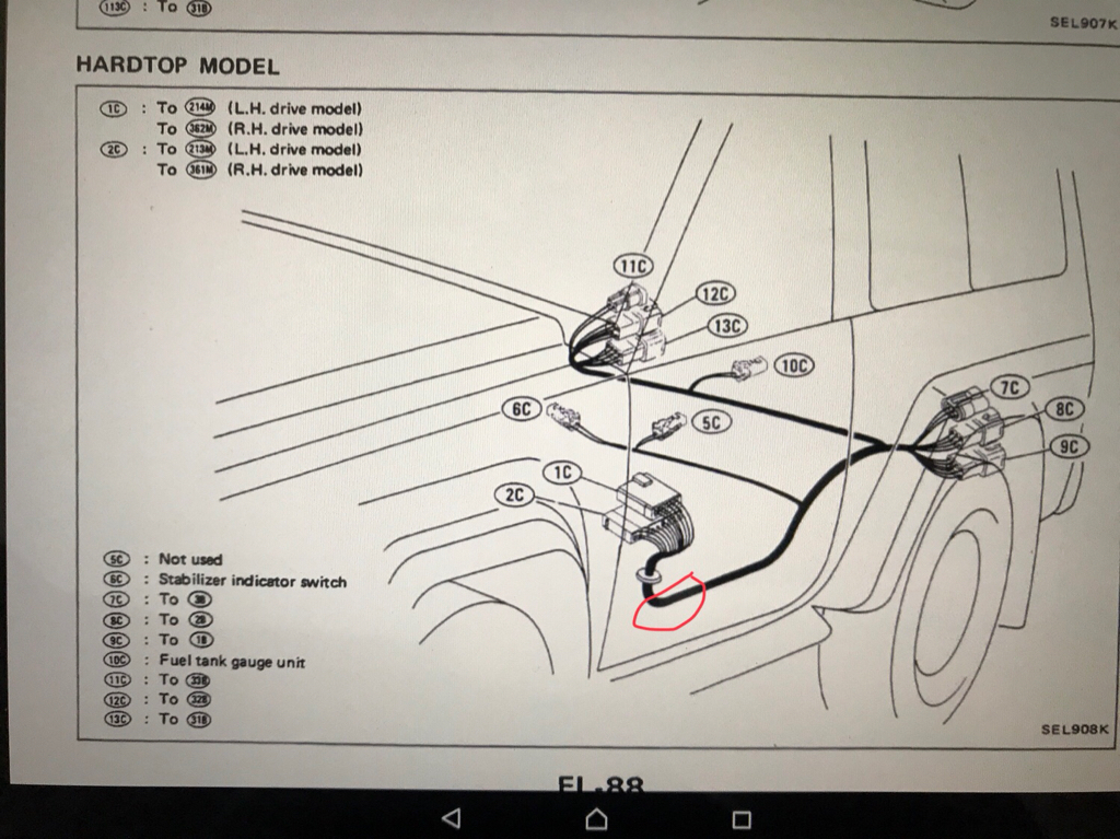

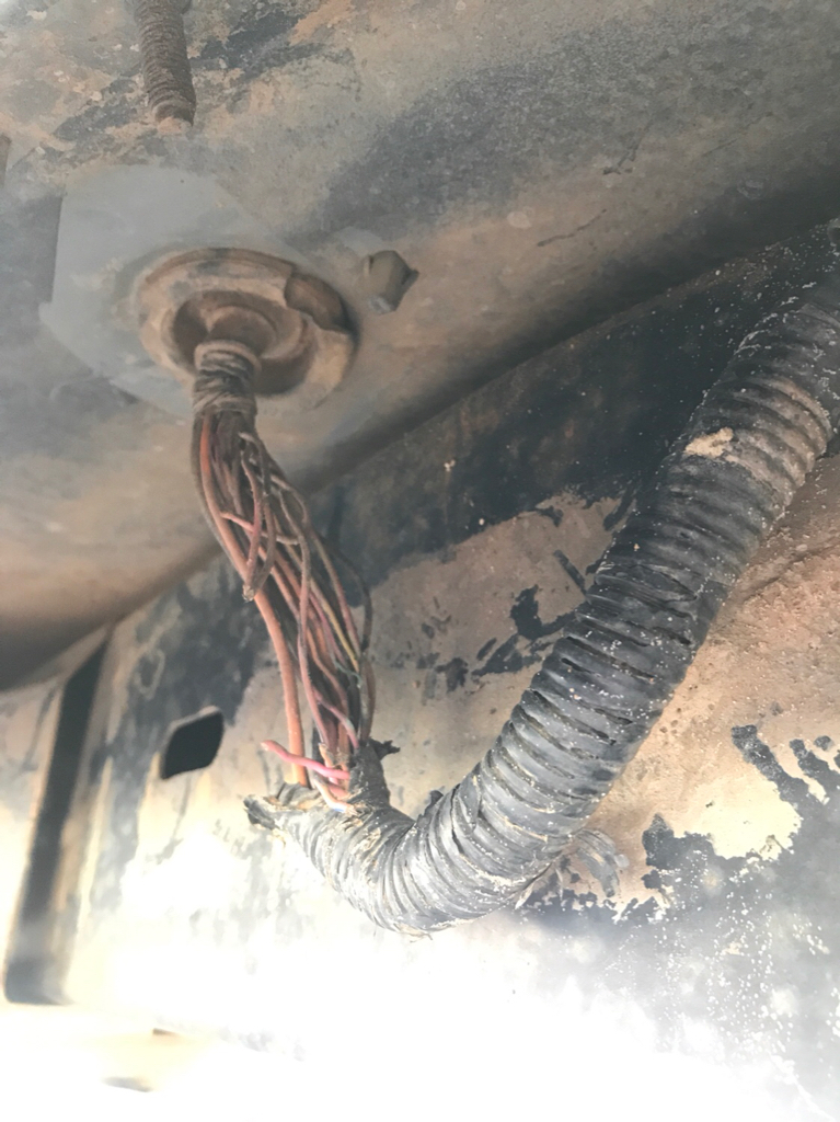

    Reverse lights not working found that the wiring harness looks shagged, so will see about getting another

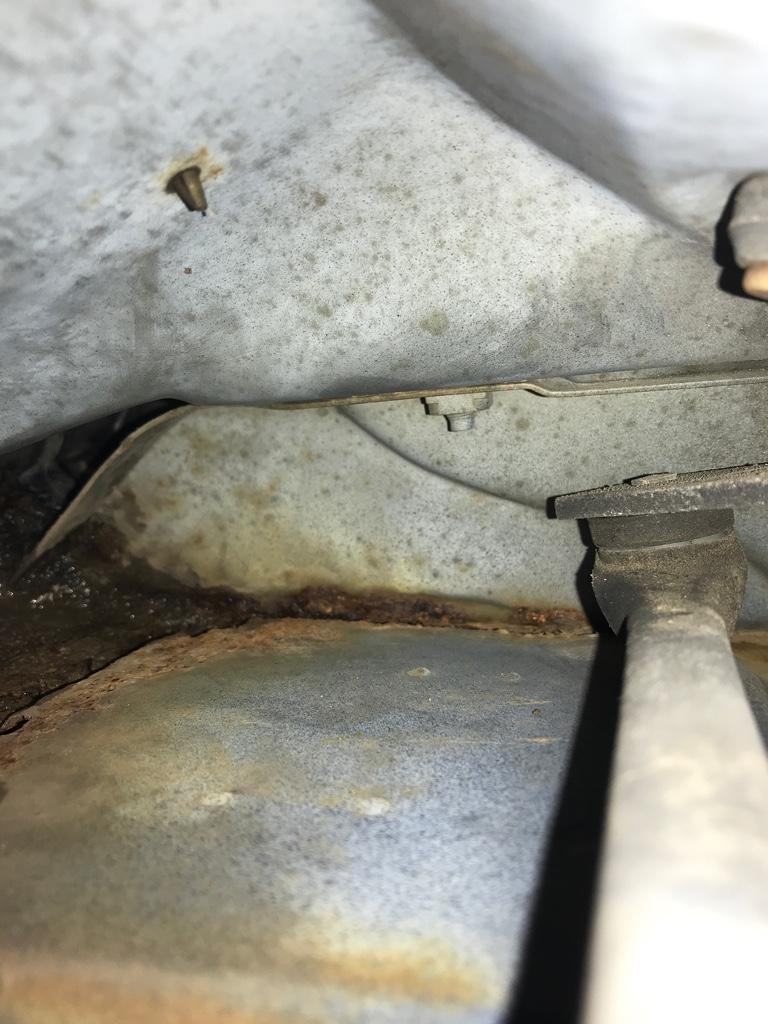

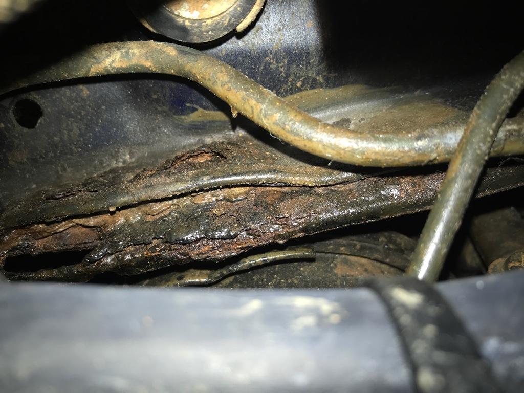

    Found some rust in the cowl panel.... had mud in there which has probably been there for ages from previous owners offroading...
    Wondering if you reckon it’s worth taking to a rust repair shop and see if I can get a replacement panel? The bottom of the cowl has pinholes and leaked into the cab. I managed to clean it out as best I could then spray a lot of rust treatment, big it up with fibreglass filler, then bitumen paint and tape to try prevent water getting in there when it rains. But ultimately I expect if I don’t replace the steel it will slowly continue and might start making it’s way down the firewall.
    Im not precious with this body so would swap it again in future but ideally I’d like to get this body to be rust free.
    Other than cowl panel there is nearly no rust.
