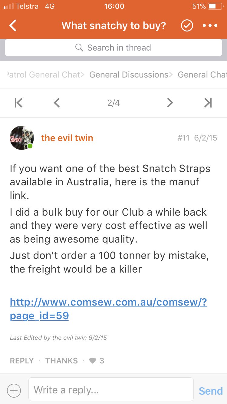

    Here’s ET’s advice to all from a keyword search here mate: The link doesn’t appear to be working in the old thread anymore but Google has found it again, Cheers ET! http://www.comsew.com.au/products/4x4-recover-kit/

    Thanks Mark, found them on ebay a moment ago.
