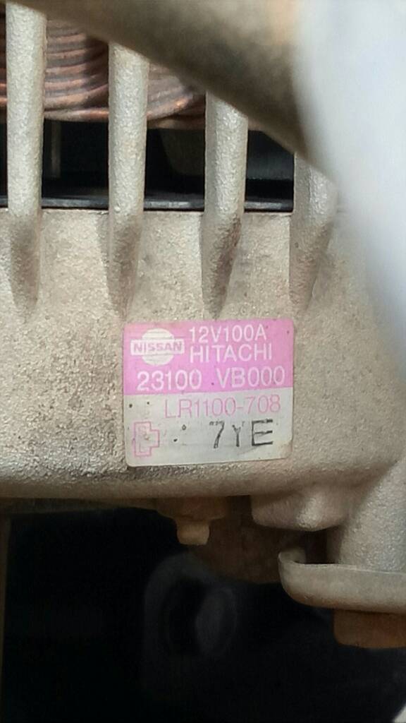

    The alternator should be producing over 14v yeah? If that's the problem should I replace with another 100amp or do I need a bigger one.
    I'm going to try to get in where I got the battery set up installed tomorrow morning. Hopefully they can test it all. If not I'll see if someone like battery world can help.
    Don't want to charge anything outside of the car yet, the whole duel battery system is about a year old.

    I'm not sure what you're model alternator you have , mine charges at 14.4 + volts , I think some systems are lower voltage or can be cantankerous with the way they see an extra load , a battery specialist should be able to load test the system and I've never had to pay for a test yet .
    So get a load test to make sure alternator and battery is not the problem , I've killed a battery in just under a year by undercharging and killed a crank battery when the alternator was on the way out .
    I just posted prior to reading this.
    Yes, about 14.4-14.7 there abouts, and adequate current to cater for your demands. It is good that you are going to check out battery world or the like. Hope all goes well.
