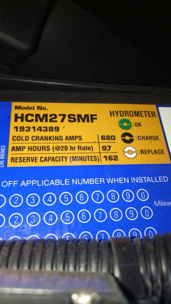

    My 55L (I think) weaco won't last 12 hours. I know that there is a cut out to prevent the battery draining completely, but shouldn't I be getting alot more out of it.
    Apparently this is the biggest battery that would fit into the battery box.
    The only other thing that is always on with the car is the radio. Charging is through a redarc solenoid type.

    Is that a deep cycle battery ? Is your alternator ok ? Are the connections to the battery ok?
    Starting the fridge on 240 volt then swapping over to 12 volt before you go anywhere reduces drain on a battery so does putting cold things in , 12 hours would be about right if it wasn't getting a proper charge and you started it up on 12 volt only after putting hot stuff in it .
    Your fridge could be using excessive power .
