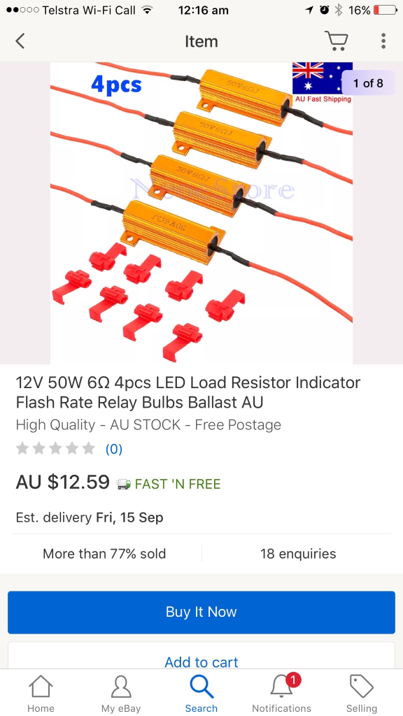

    Try adding a load resistor and it should fix it. We used to have load resistors fail all the time on our trucks then they flashed fast like there was a blown globe. New resistor, problem solved

    Change the flasher relay to an LED compatible one ($5 on Ebay, maybe $15 to $30 retail) problem sorted for ever with no crimping soldering etc
    The reason one side is OK and the other fast is there will be a slight bit more resistance on one side so a higher load so the original relay thinks that side is OK... same for when you plug in the trailer the extra load tricks the original relay so the rate is normal

    50ohm resistors will do the trick but avoid those scotch locks they will fail
