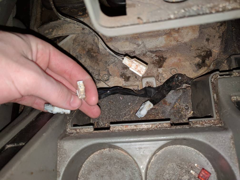

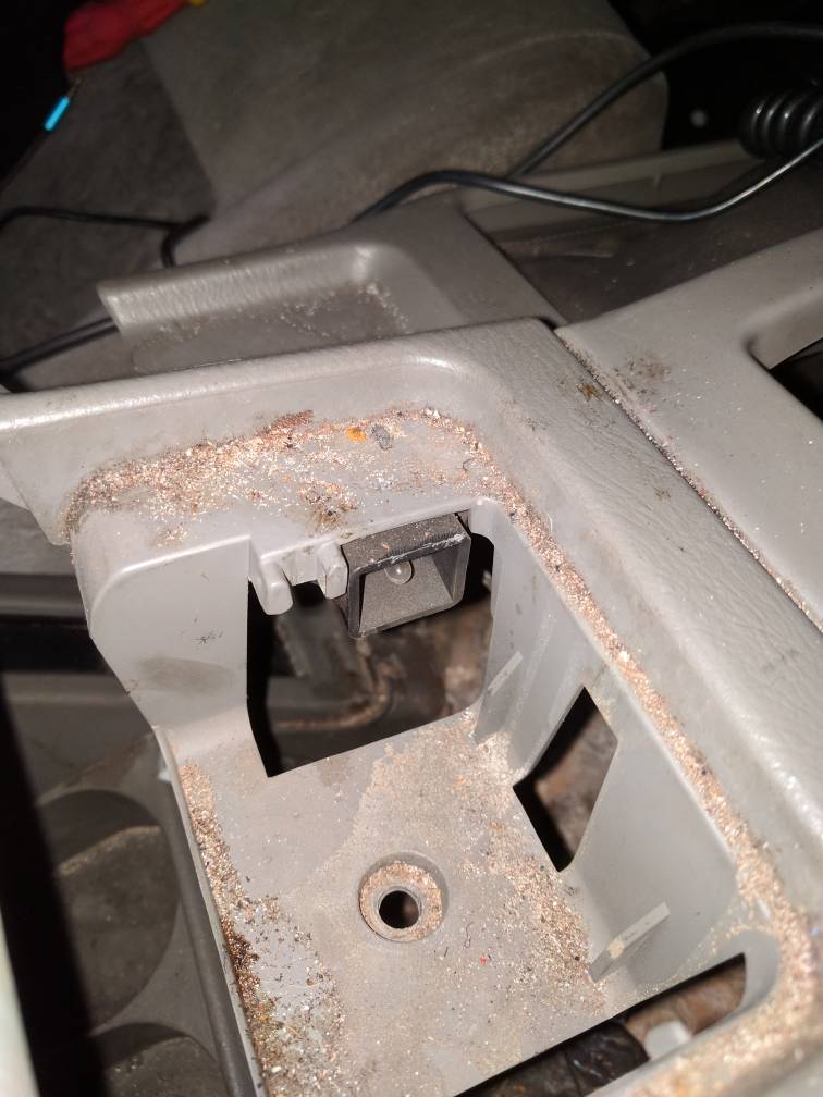

    Quote Originally Posted by Deano2506 View Post
    I always use ashtray light wires for that... usualy easy to get to
    Didn't even notice the ash tray light as mine doesn't work, I'll have to take a look with the multimeter and see what's the problem, hopefully the positive is in take and that will do perfectly.
    Sent from my Nexus 6P using Tapatalk
  7. #6
    Aug 2017
    12
    6
    Thanked 5 Times in 3 Posts
    Had a look at the ash tray light today with a multimeter and there doesn't seem to be any power coming to the plug, is there a fuse or something linked to this?
