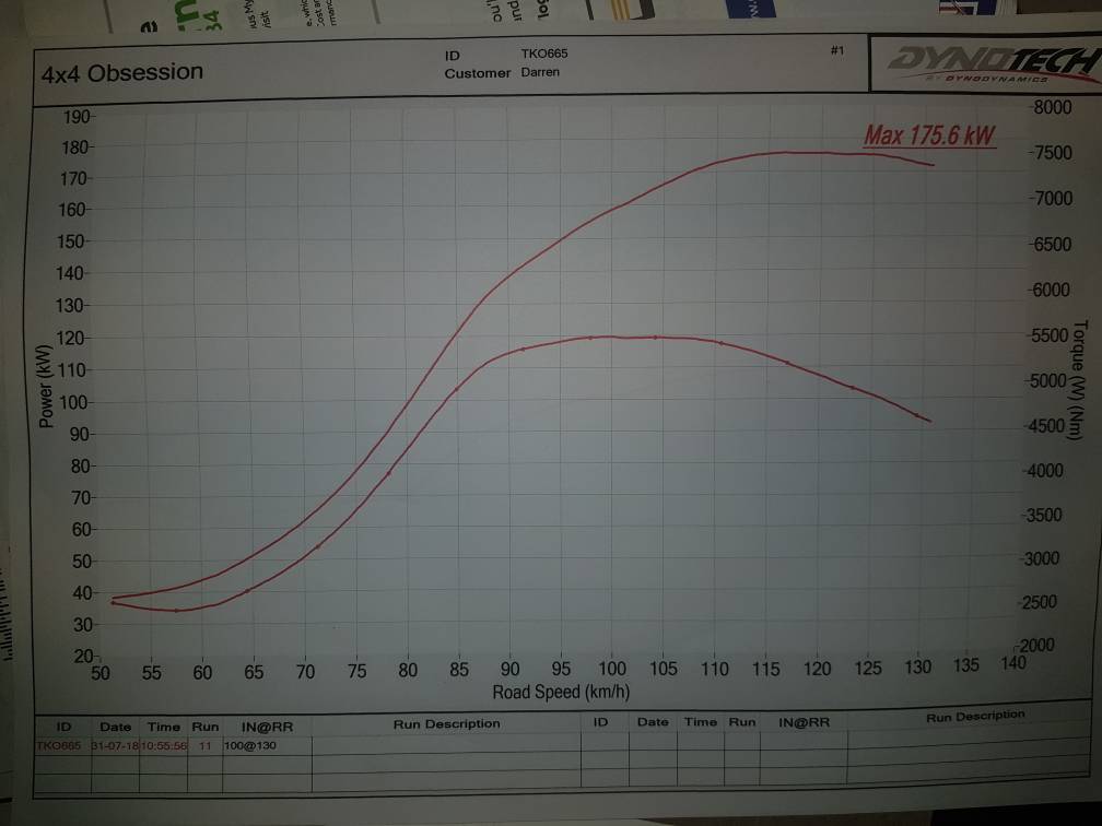

    Yeah you look like you get a fair bit more earlier than i do actually. I will take a pic of mine and post it here to compare

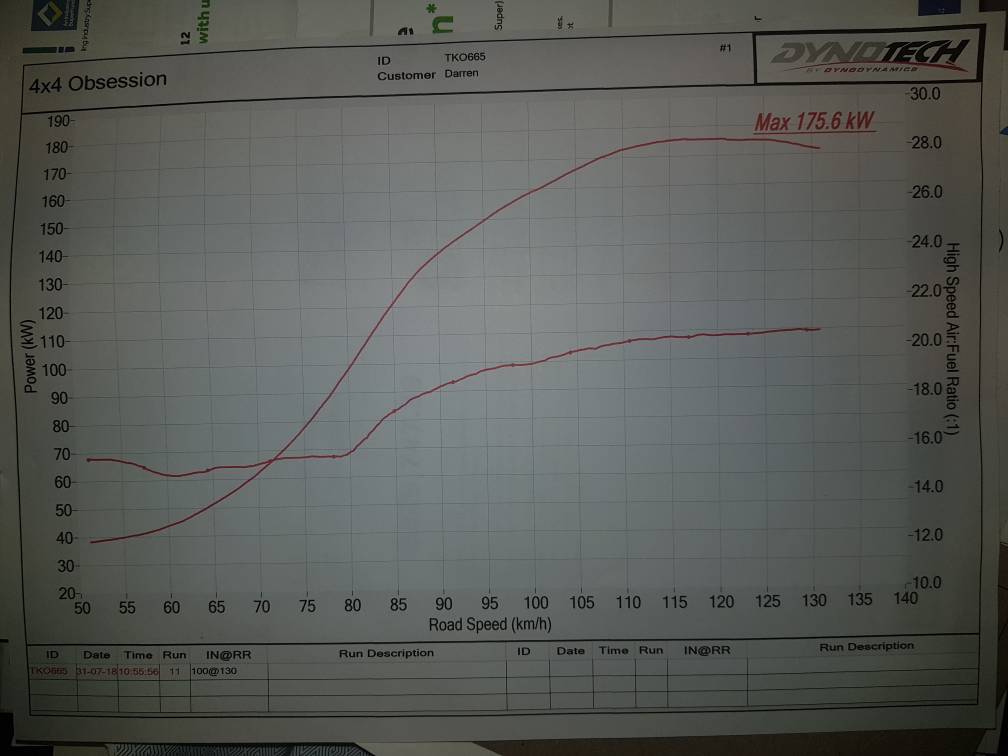

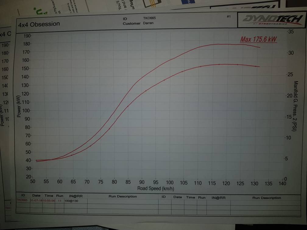

    Yeah wow. If those speeds are correct then regardless of the tacho your peaking at 75 to 80kms/h and im just winding up to peak at 90! That is nearly a gear!! Wow
    At 70kmh im producing about 100kw and you have 140kw already.
    At 80kmh your on boil at 165kw and im just thinking about it at 140kw! I dont see 165kw to about 105kmh. Jesus! Thats a big difference.
