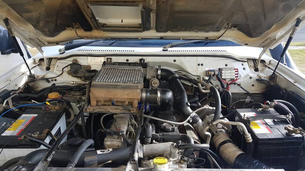

    So heres my patrol at the moment:
    GU 1998 model - originally rd28
    Motor:
    TD42 with shitty denco turbo kit, running through factory rd28 intercooler. (will be changing these soon )
    5 speed box from a GQ but will be swapping to an Auto soon. (ive had a factory gq the td42 and auto and absolutely loved it!!)
    Extras:
    2 deep cycle batteries
    Roof top tent
    Rear draws
    new carpet
    new stereo
    all new wiring for engine conversion and added features
    2x led light bars
    2x hid spot lights
    swapped the 4.6 diffs for 4.1's
    Alloy radiator
    Autometer Gauges and pillar pod

    Well its happening again....
    Turbo
    Cooler
    Pump
    Water tank
    Snorkel
    Airbox
    Gvm upgrade
    Gu4 interior
    All on there way and or booked in to do
    Will though pics up as it happens, also picked up an auto and computer etc for it. But it can wait till ive finished all this lot now haha.

    Got the Kut Snake flares sitting here ready to go on once the detailers have come and given it a cut an polish & paint protect.
    Turbo housing and manifold is currently being ceramic coated in brissy
    My inlet and all my custom fittings for my dual a/c (heat exhanger system) should hopefully be here today
    Gu4 barn door is all bolted up and reverse camera in
    gu3 tail lights are in and wired
    2nd heat exchanger for w2a is bolted in
    Remote start and full alarm system is all in and working (gps tracking and starting etc etc)
    Gu4 interior is on hold atm do to people saying the have bits and dont
    But so far so good, cant wait to get it all knocked out got a trip in a couple of weeks then after that ill have time off road again to send the pump away

    Sooo got the dash all back in and everything working a treat, manifold and a/c lines arrived yesterday - A then had a hulk moment when i realized they 1. cut the wrong a/c line and now *** it and 2. They put the 3" intake in the complete wrong spot on the manifold so much so it wont even bolt to the motor! Soooo now on Monday i have a 400km round trip to go and take it back to them and get them to fix it Sucks living in a small town sometimes haha
