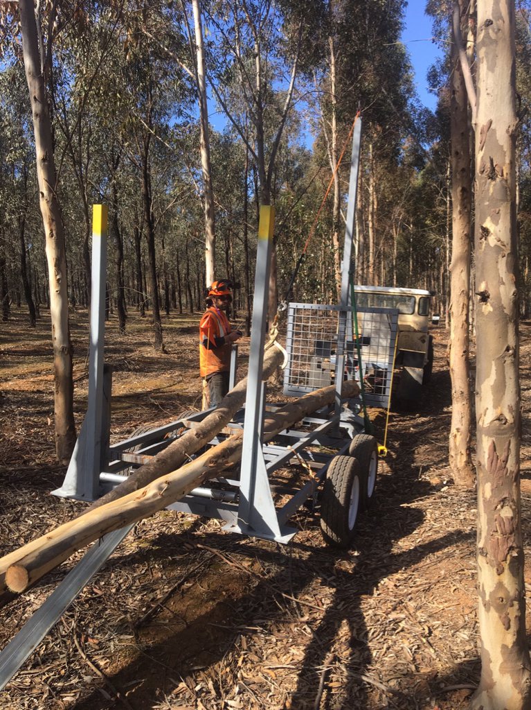

    A quick word of warning we’ve recently found for cheap wireless remotes good folks!
    Setting up our little log private coupe trailer we’ve trialled the $26ish dollar one to remotely guide them up.
    Potentially dangerous as they have their quirky moments sometimes uncontrollably running on for up to an extra 1.0m found :-(
    Never again for us, the poor man pays twice, here’s hoping that Warn can safely get the job done next week.

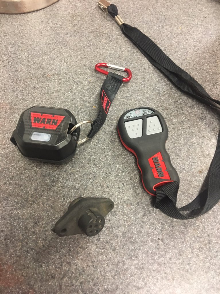

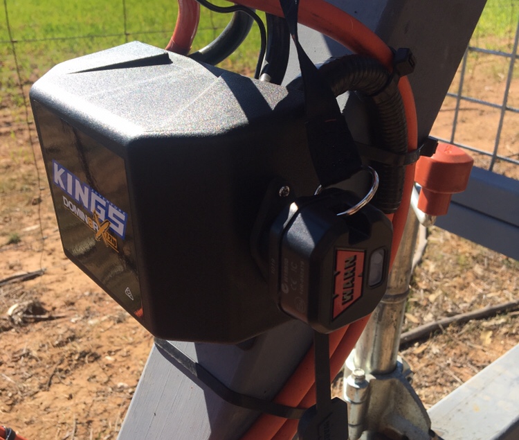

    Problem solved thanks to @matfew ‘s kind 4 pin to 5 pin plug conversion onsite wiring help!
    This new Warn wireless controller has perfect response time even at its rated 50’ away and slightly further found too!
    Now we just need to save like crazy for an actual Warn Hi Mount winch for longer and faster retrieval before the King dies :-)

    Was quite impressed how well the warn one worked. I had one of the early Tigerz 11 in my old dato ute and even made it into the patrol in early days. It had the wireless remote but was actually half decent. Did run on but only a tiny bit. Must of gone real cheap China now days as marks original one was pretty bad.
    Glad it will help out
