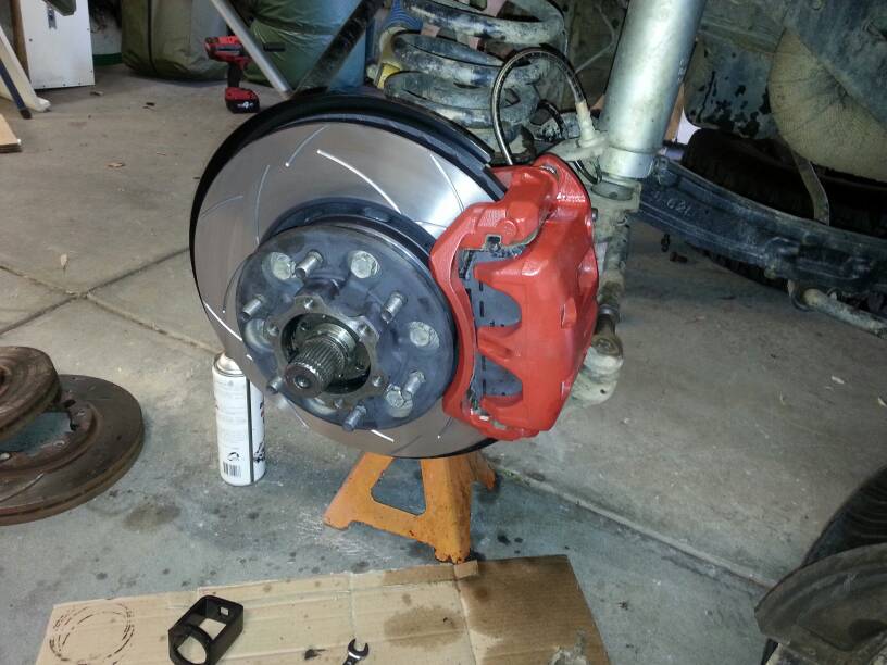

    The TB calipers, discs and backing plates are in... also a new front right hub. Now to replace the brake line from the t junction and the master cylinder.
  14. The Following 4 Users Say Thank You to mudski For This Useful Post:
    AB (3rd January 2016), BigRAWesty (3rd January 2016), Rossco (3rd January 2016), Sprock (3rd January 2016)
    Looks like a race car...
    But looks good
