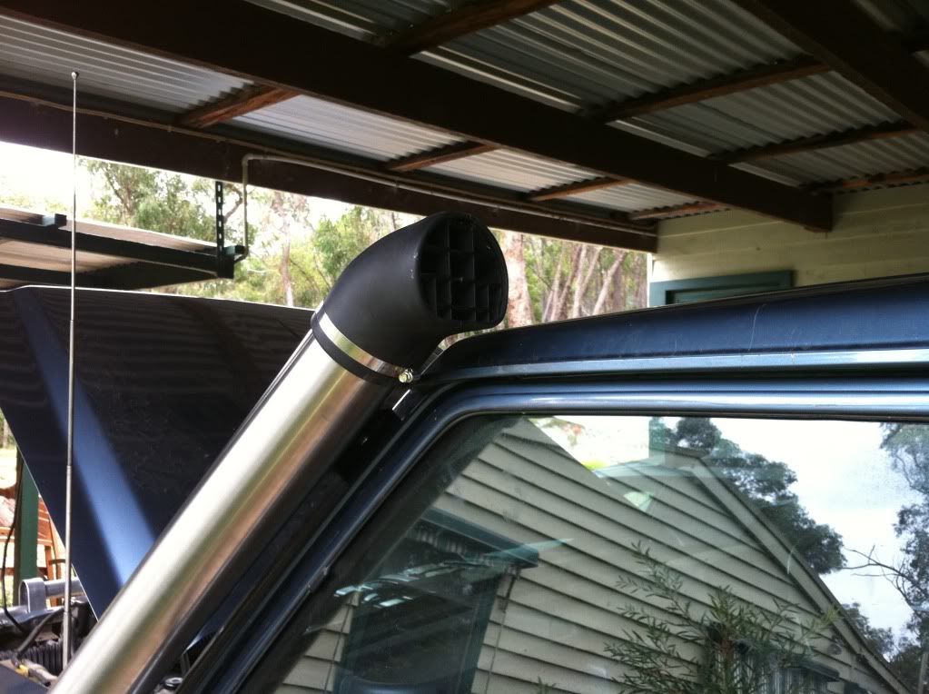

    Fine lookin snorkel ya got there mate. Loveday mudbath here you come

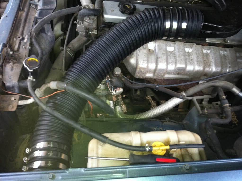

    Forgot to mention, make sure the hose clamps fixings are facing inwards to avoid injury.
    I walked out this morning and saw birds trying to nest in the snorkel so I found an old rabbit trap and used the entrance to the trap to put inside the rubber elbow...Fits like a glove and works a treat!
    Also, there was a slight air leak from the hose clamping over the wire wound flexi pipe so I had to add a few extra hose clamps. Might be a bit over kill but better safe then sorry.
    Also, I did weld a 4" pipe outlet from the original 75mm square pizza box outlet on the GQ to fit the flexi pipe over.
    You could also keep the original 75mm aquare outlet configuration and tap the 4" flexi pipe over the original flexi pipe that comes off the pizza box somehow.

    Pure magic mate,yep id like one of them,now for the test guess your up the bush now
    hows the fuel economy &torque going to be now

    Look good Andy
    Also looks like hard work, I had 2 crack open a bottle just thinking about taking on a project like that myself.....

    Took 6 hours (3 hour spent bending brackets and waiting for paint to dry) and 8 cans....Not bad really!
    I'm slightly concerned about water getting in at the top in heavy rain as the pre filter is now gone and there is no way to get the water out or to tell if water has come down the pipe.
    I might conjoire something up one day...I'll take it for a test drive in pouring rain one day and see how it goes anyay.
    It almost needs a little top cone cut on a 45 degree running horizontal or even a one way hinged flap to pull inwards when sucking and can never go outwards....thinking thinking thinking....lol
