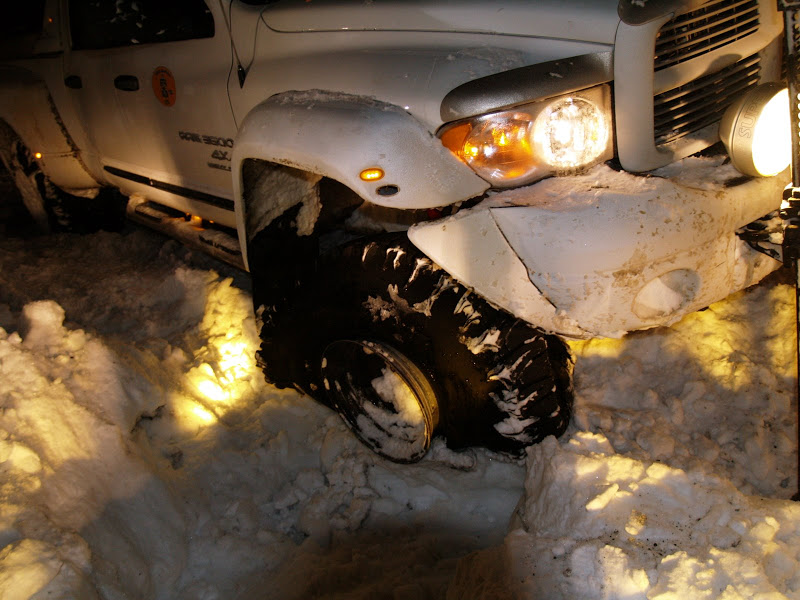

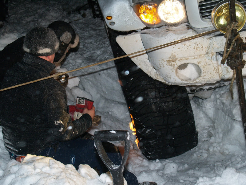

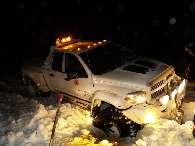

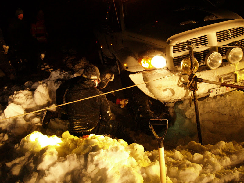

    here is what once happened to a guy i was traveling in a group with on a glacier and some photos on how this may be used practically when in trouble.
    here is how the tire came of the wheel

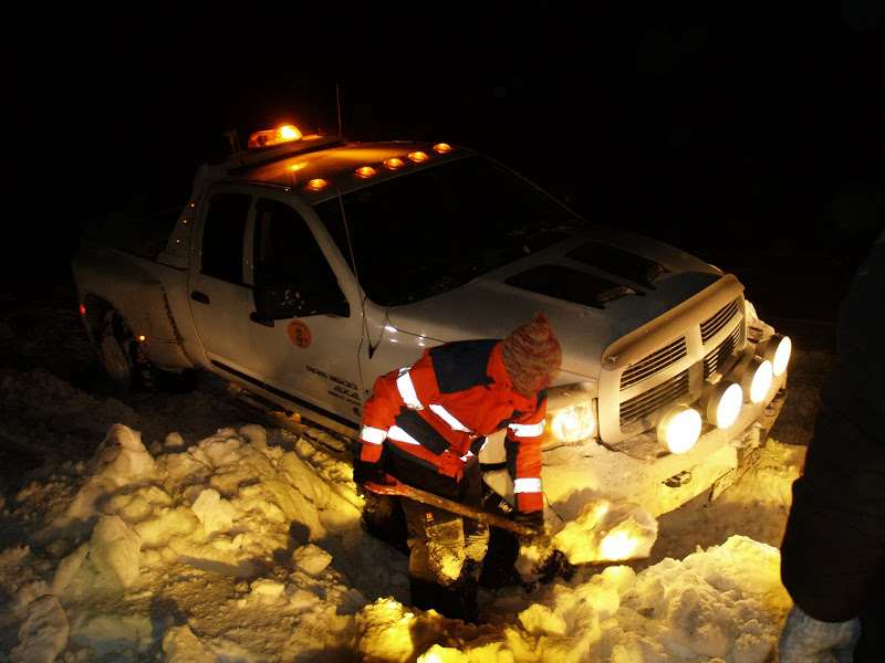

    then some digging

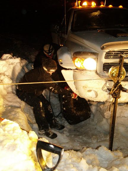

    then lifted up with a high lift jack
    the jack then stabled with some robes and the tire adjusted in place.

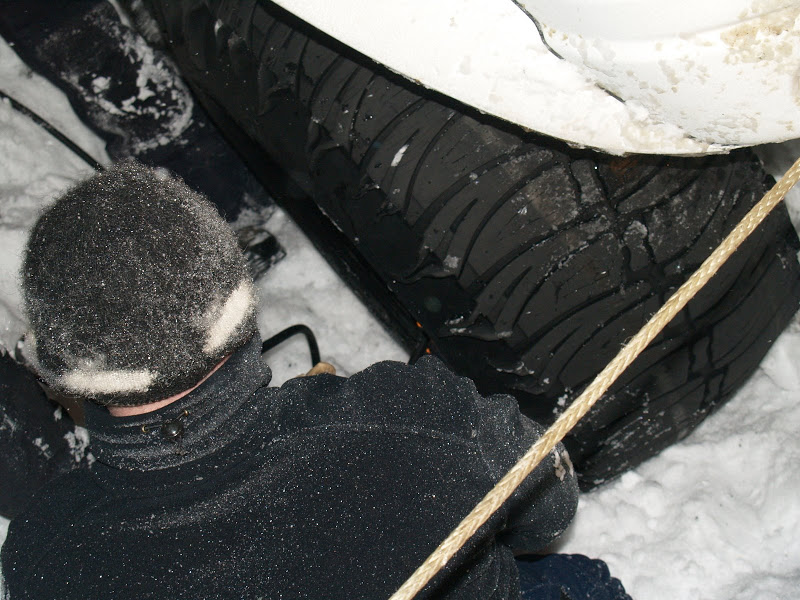

    at last some gas sprayed underneath the tire

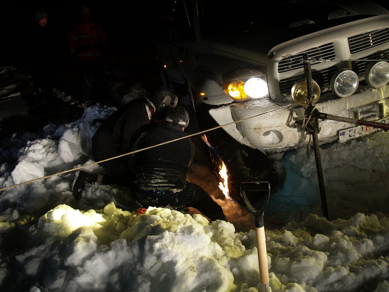

    the next few are pretty self explaining light it up and...
    i knew this method existed since i was a child but those guys driving the ford you may have seen earlier in some of my posts new how it was done they said the trick was not to put too much, better to but too little and try again other wise things can go disastrous as they then demonstrated by giving it a few goes.

    cool photos, i like how they secured the highlift - haven't seen that before...

    I have used the rope as a tourniquet never seen this before - would like to try it before going outback - has anyone done it with the tyre not restrained? - interesting Paul

    I've done this a few times with 35's unsecured just leaning up against something and havent had and trouble.
