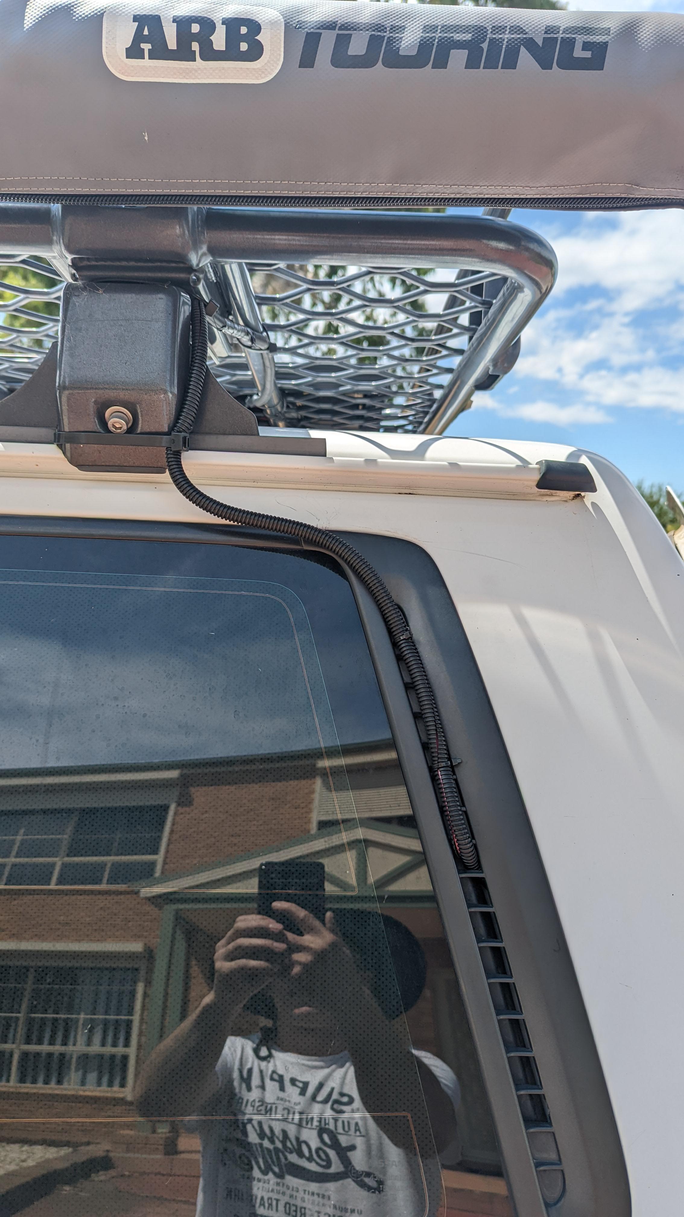

    A lot of these cable ideas from racks to inside the vehicle have a bit of a problem because water will run down the cable into the cab. You should have a drip point before the cable enters the cab in an upward direction if possible, or else well seal the entry point.

    Heres how i routed mine into the cab.
    But my battery is right under that window so to me it made sense. That air relief vent is already water and drip ready so it was a no brainer.

    I do like the idea of running to the window vent. Hmm one day...
