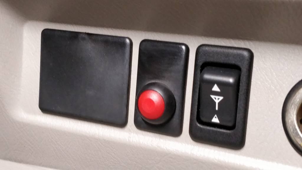

    Do you have an antenna control switch like this?
    The other place to look is on the back of the head unit there is an antenna control wire that triggers power to the antenna when the stereo is turned on.
    Not any more. Using a AM/FM wip. That's why I don't want the antenna to work. The head unit is wired up through a switch and to the aux battery. Unplugging from the antenna will probably be best. Will see how I go tomorrow, soccer isn't till later in the afternoon..

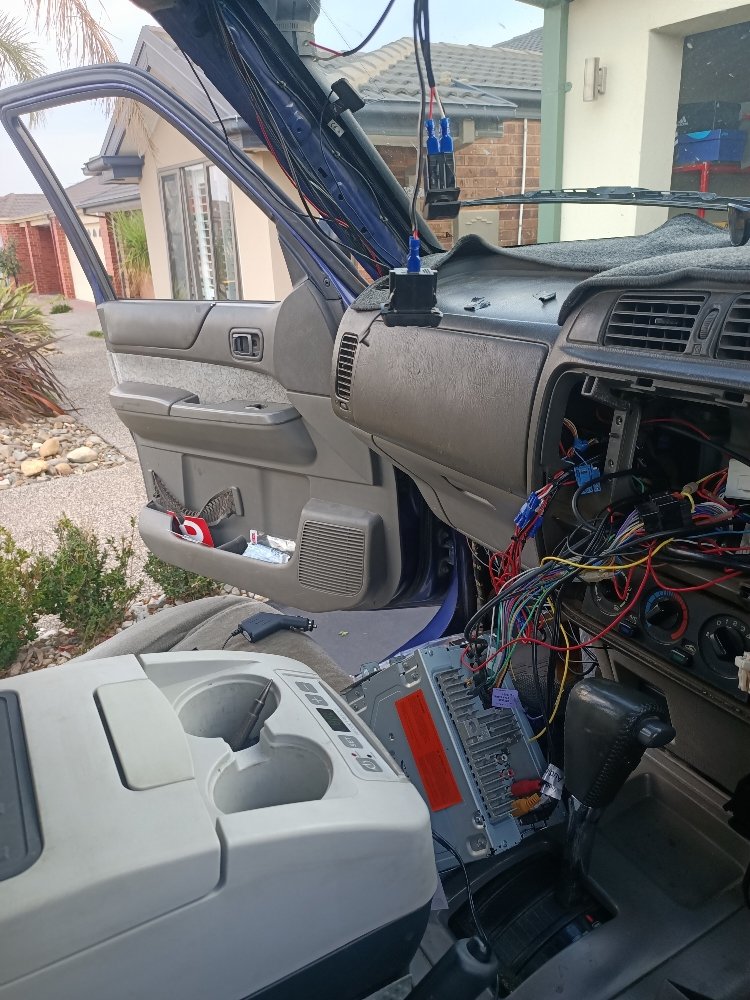

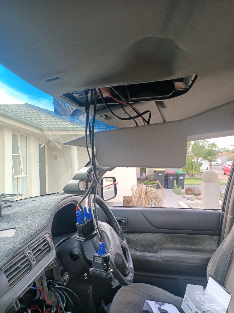

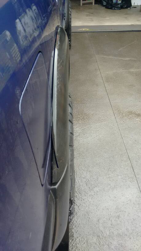

    Getting a few to things done.
    Unplugged antenna, now to get the flare back on properly.
    Out with the old in with the new.

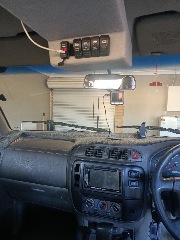

    and finally getting this roof console sorted. Continuing tomorrow.

    Yeah maybe, there's a bit of storage space in the console itself will see have it all goes.

    It's not completely finished, but it all works. Will need to find another radio surround, bloody wreckers wanted $70 I'll find something on marketplace.

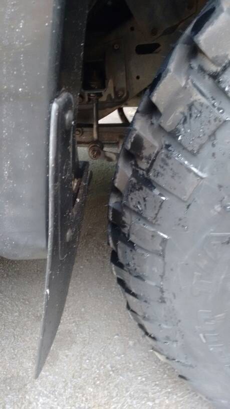

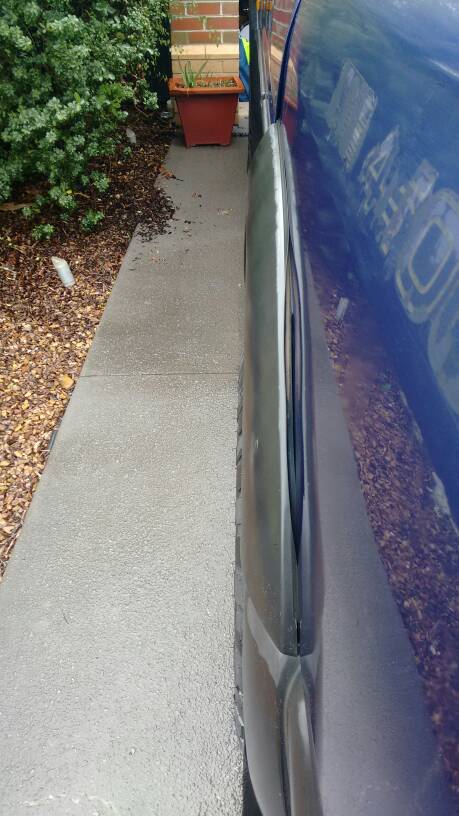

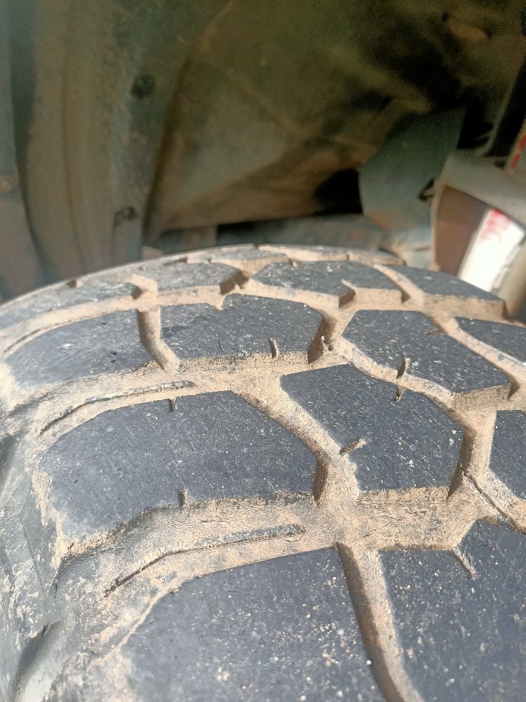

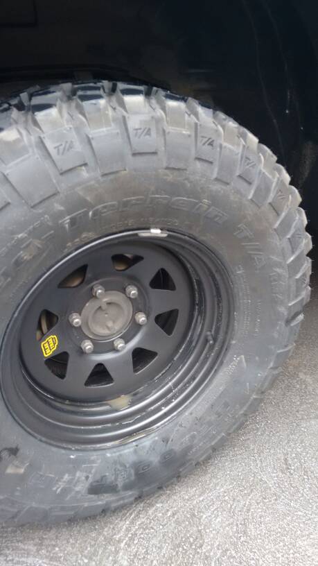

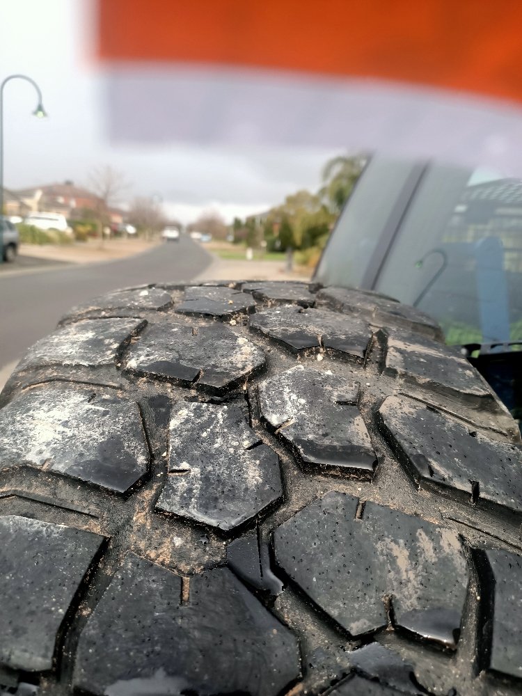

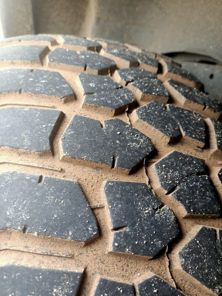

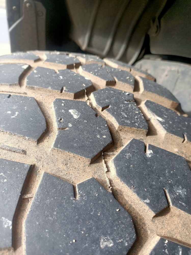

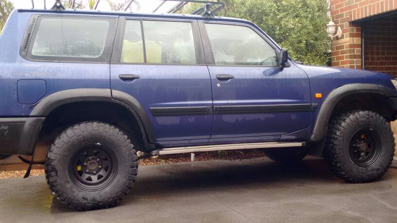

    I was at my folks place last night and was flicking through the local paper and saw ad for a tyre place in South Morang rang them up this morning and was quoted 1900, asked if they could do 1800 and if they had them in stock. Yes and yes.
    Did a few tight u turns and no robbing at all. This is will the wheel turned. It may be due to the 2 degree offset brush.
    One concern I had was in the wet, well today was a good day to test them, drove a bit harder into the corners around home and I'm impressed.
    Drivers side.
    Passenger side.
    Almost 5 years to the day and we'll over 100,000 km.
