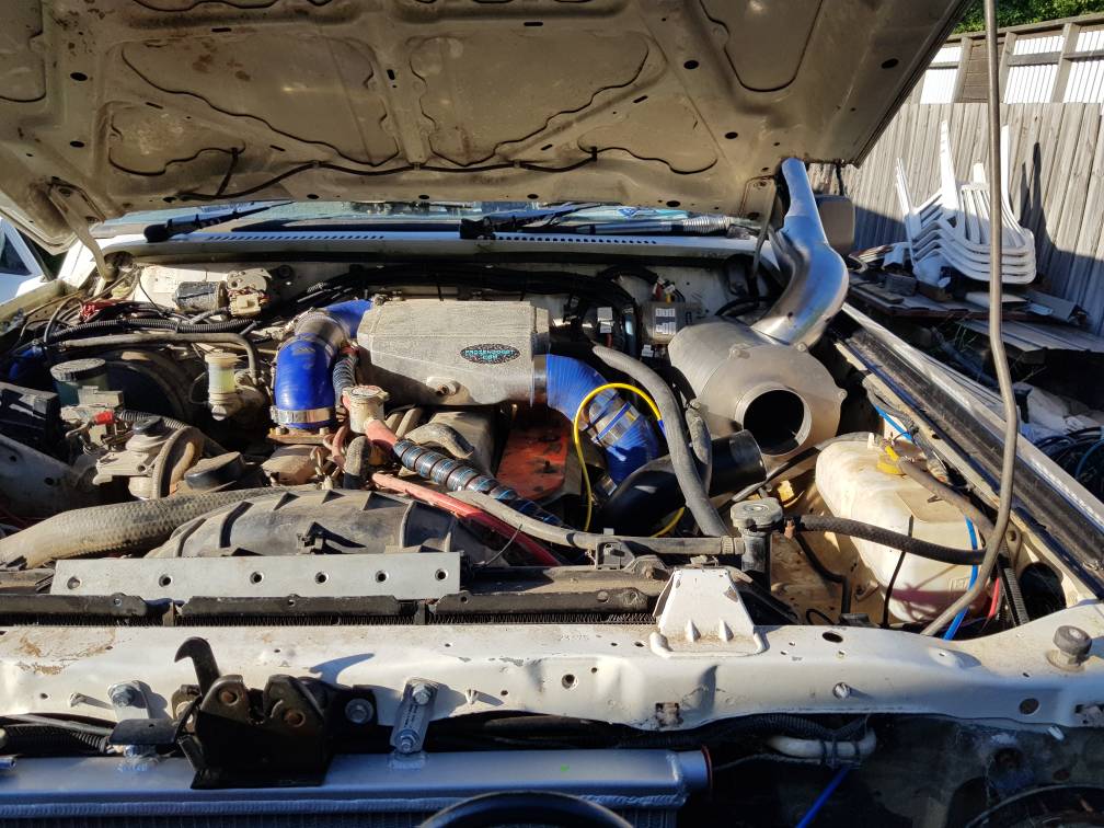

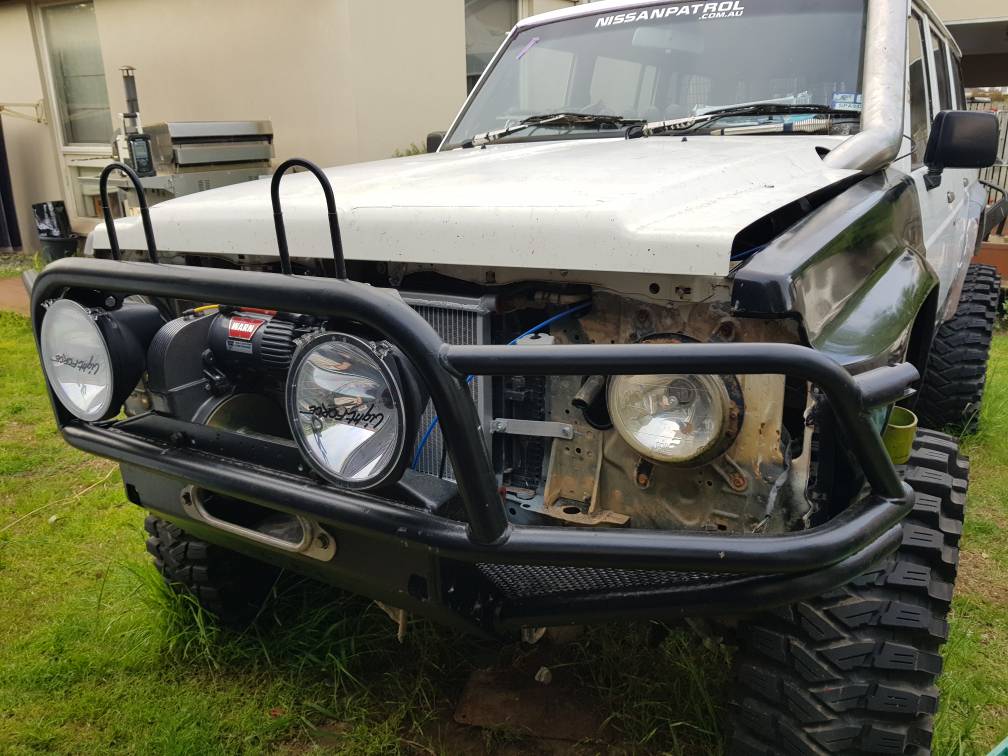

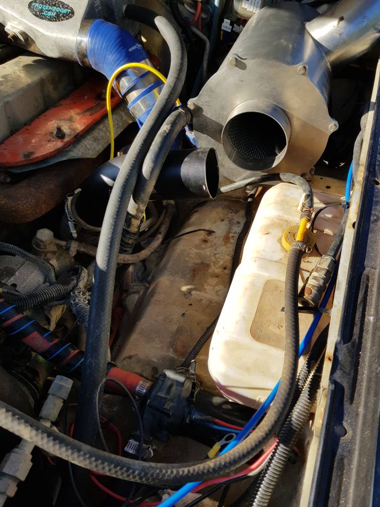

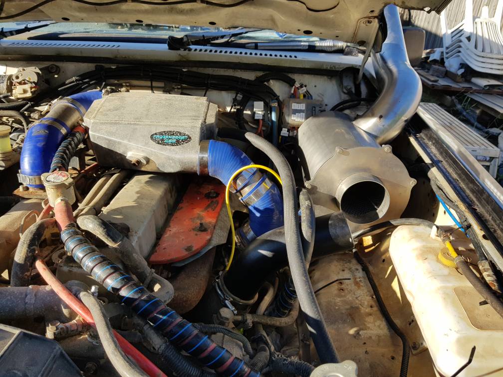

    Did a little more to the GQ yesterday. Cleaned out more wiring. Removed tr he old corner airbox. So much room now!! Relocated the W2A pump again.
    Went to Repco on a 30%off RACV day and bought 10m of 10amp 7 core trailer wire that I will run up to the roof to wire up the side lights rear camp lights.
    Test fitted the new Lightforce Genisis HIDs. Need to buy some 20mm spacer as the bolt holding the winch hoops on is in the way of the Huge mounts of these Genisis.

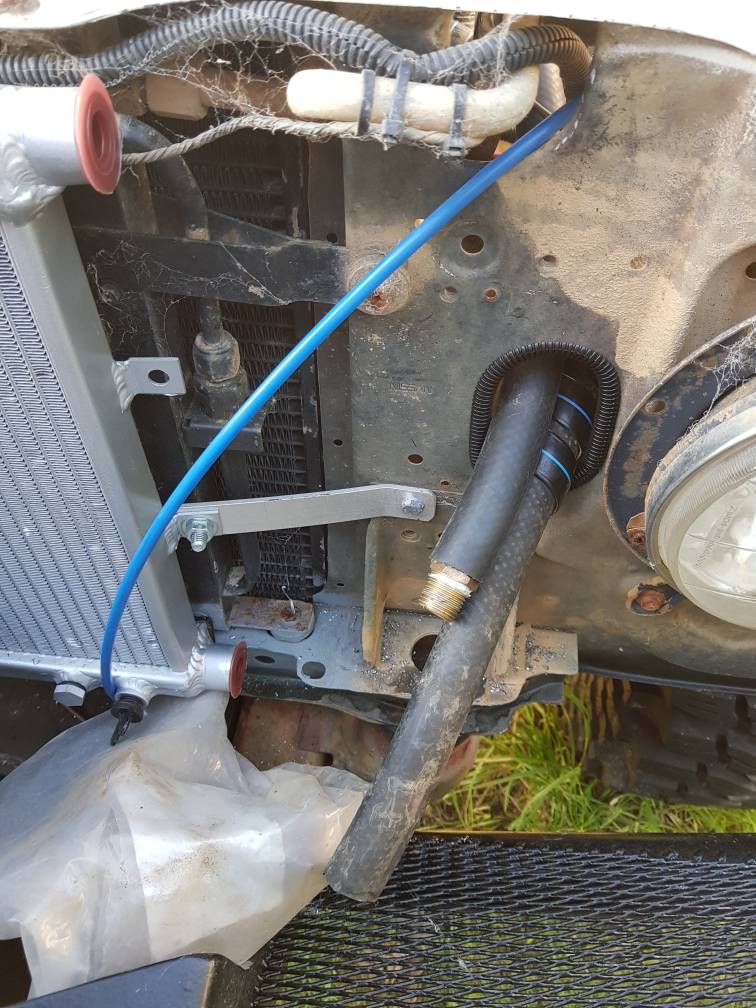

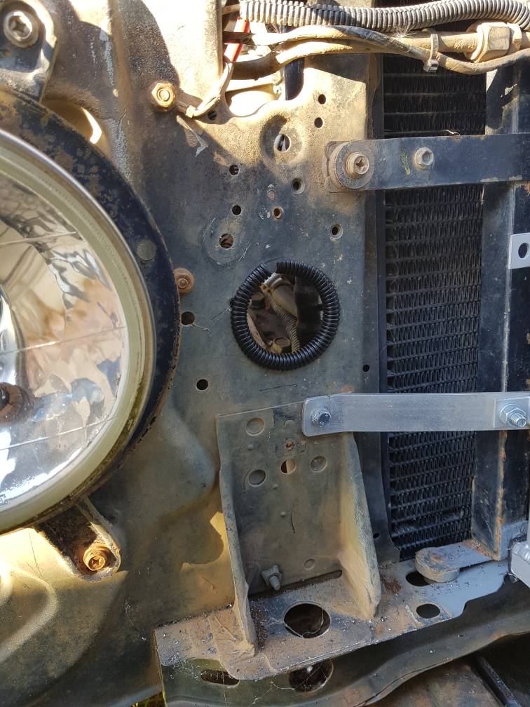

    Did some more work on the GQ today. Refitted the intercooler and mounted the water pump for it and the radiator overflow bottle.
    Rather than stuffing around trying to poke hoses and winch cables through penetration in the radiator support panel (serious lack of options!) I used a hole saw and added one to each side.
    Split core flute works a treat for protection around the edges.
