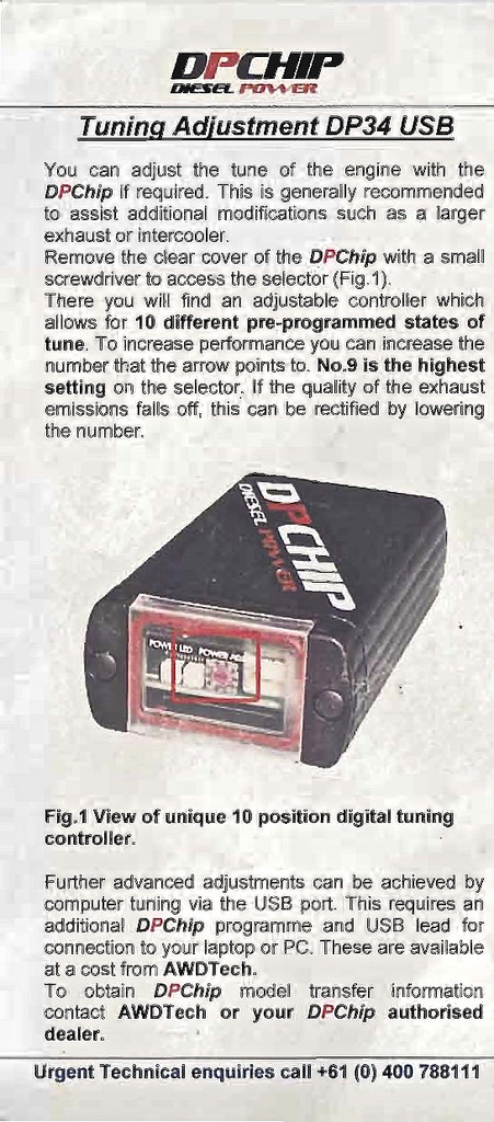

    DP Chip # DP34 Installaition and Tuning guide
    To suit GU Patrol with the 3Ltr Direct Injection motor. Please check if this is the right instructions, DP#34, for your chip prior to using.
    Tuning1.pdf
    tuning2.pdf
    coverback.pdf
    cover.pdf
    wiring diagram.pdf This wiring diagram if for a 2001 Y61. ST model with manual trans and no dual zone air or ABS. As there will be a difference.
    If theres a better way to put these pdf's on here, let me know...

    Ok so I've just had a quick look at how to install this chip and I'm wondering how you guys went about connecting it to the pump. I can only see about 10mm of cable where it's meant to connect too. Did you just solder it on there or is there some special adaptor you used? Thanks
    03 ST-L auto, Dawes and needle valve, provent catch can, 3' exhaust. I want more than I got
  14. #10
    The master farter
    mudski's Avatar
    15,618
    8,679
    461 Post(s)
    Yeah those two wires on the pump are a real pain to get to. I just used scotch locks.
