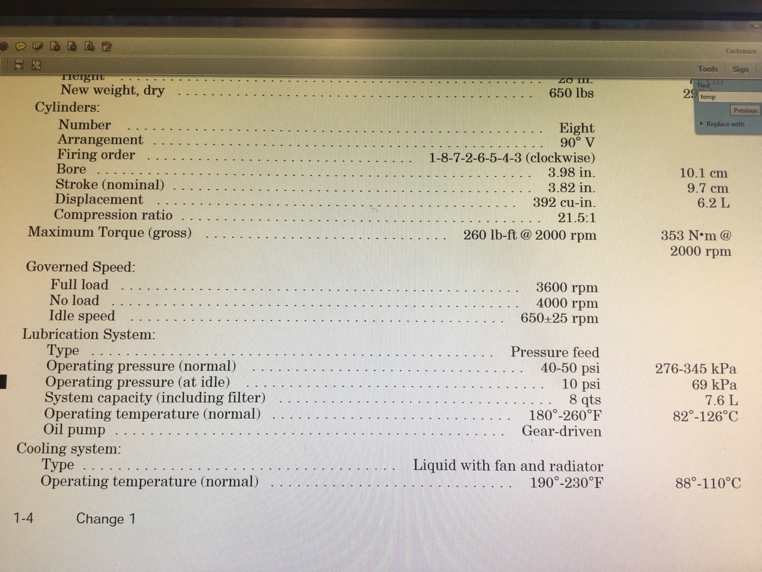

Todd kindly put a link on here years ago to the US Military download that I'm slowly working my way through like a nuffy.
Cold idle I've always experienced minimum 40psi and cold 2,000rpm up to near 60psi. Hot and flogging the old girl I've seen as low as 2.5psi hot scary idle. Hot water I think it's turning to :-(
23rd February 2017, 10:11 PM
#547
Sounds like the oil is the wrong grade, as pressure is 'only system resistance', so if its as thin as water then it isn't going to generate much back pressure I would surmise. Do you know what your oil temp is - bearing in mind this is a critical part of the equation. If its well above the specs above then I can see the benefit of cooling it like you are doing, but if its within spec, temp wise, could it be the oil? Sounds like you have a very accurate oil pressure gauge as well - what brand?

Funny thats exactly what I am running - swapped over from Mobil. That oil must be stinking hot. I am just wondering if a 50 or 60 grade, like a semi synthetic or the like, 10W-60 for example might also help with hot temp viscosity. You maintain the low temp characteristics and increase the top end. Worth enquiring, but first thing any oil company will ask is, 'whats the temp range'. However if your super coolers do their job, then alls well. I guess one thing at a time is best practice. I am eagerly waiting the outcome!!!!! I know a couple of the guys in FNQ have upgraded their oil coolers to a second unit on the chassis rails, but speaking with BD their applications were heavy towing and constant high temps - maybe not the variables yours will see, which makes that pressure stabilising valve a good choice i reckon.
