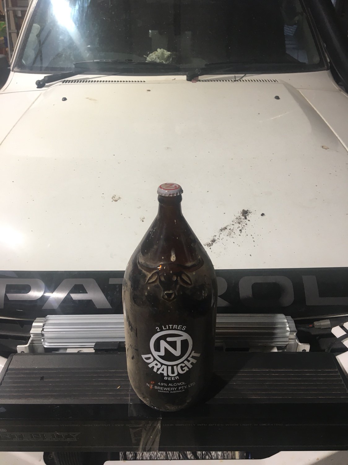

    Sideways... but cut a hole in the Bonnet and put an ARE Scoop in with the Cooler on top and screw a Light Bar to the Cooler... with a Mack Bulldog on top of that again
    Sweet as ET mate, like it alot ;-)
    Buff’s are heaps tougher than Bullwog’s though :-)

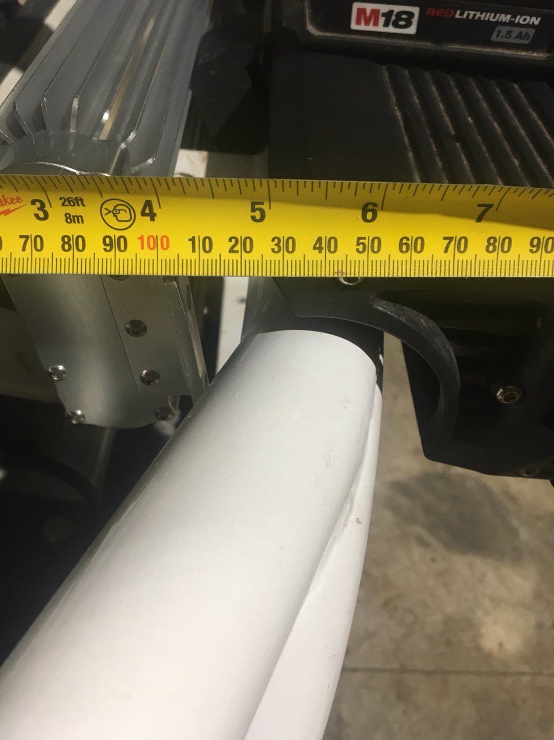

    FWIW top blokes ! 35mm hole centres on the new ripper PeeBee oil cooler! 40NB/48.3OD bar as most. Approximately a 7mm bolt hole with a minimum 60mm distance/length. Have ratted through every shed shelf tonight to no avail :-( ! Thinking this needs a Bunnings run tomorrow for say a ‘drill out’ 8mm SS ‘U’ bolt thingy x 50mm x 75mm long & a bit of bending/styling thereafter:-) ?

    I would use the existing tabs you have on the bar instead of trying to find a clamp, which won't fit well anyway unless its one of those light bar clamps.

    Now that’s a better idea mate, thanks! Seem to remember ‘Bushranger’ brand had a very possible light bar clamp thingys that could mount on backwards. Cheers!
