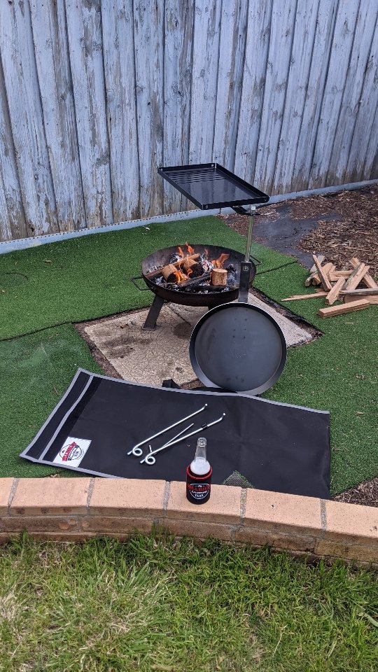

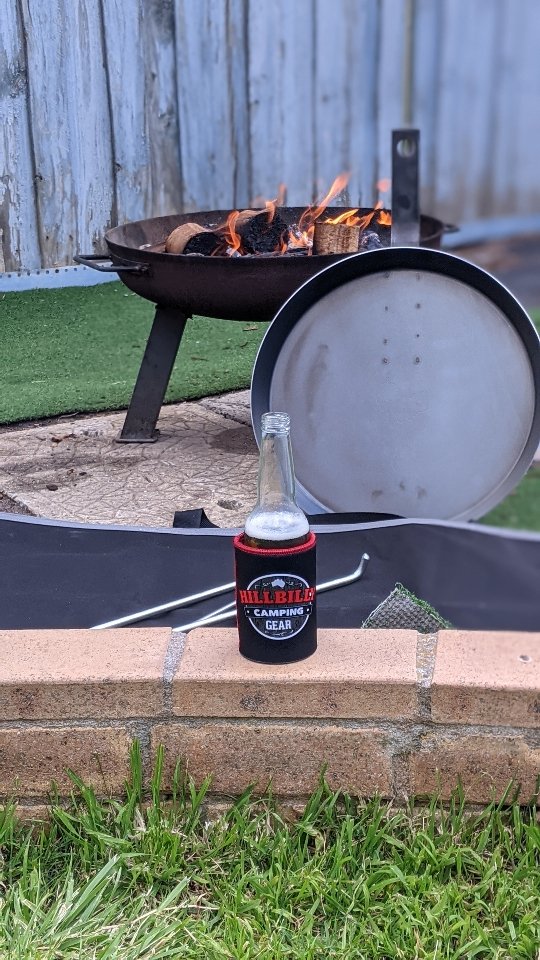

    Hillbillys cookstand kit. Aussie true blue made, no Chinese horse manure here folks. The bloke welded the final bits right in front of me when I picked up today. The canvas bag alone is leagues above any other shit I used in the past.
    https://www.campingwithhillbilly.com...Bag-p157333918
    Seasoning it as I post this ...
