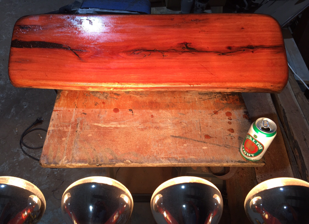

    Back off to our Happy Thread!
    Yanky ‘West Systems’ and Aussie Oxide mixed with Acca Dacca gets the little job done
