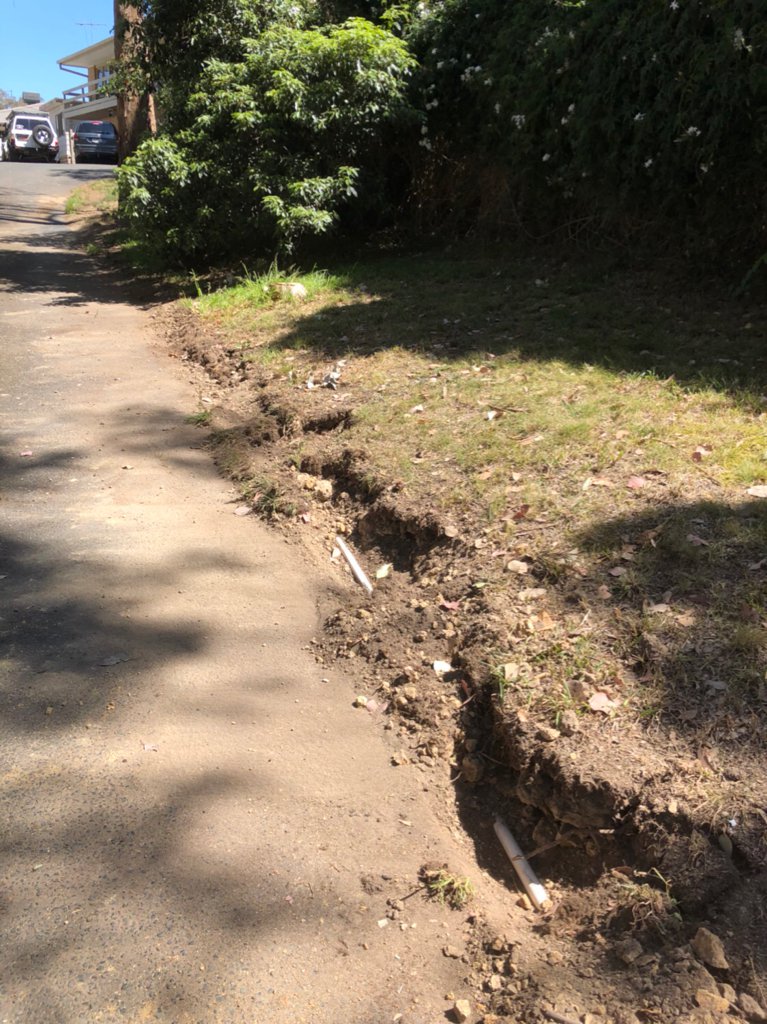

Not angry, just a wee bit peeved, as I was not surprised at all with my discovery.
So we’ve been promised by NBN Co since I moved in that we will get connected. They give us a date, the date passes and we get given a new date. Rinse and repeat 4times over.
So they came out and dug 70 metres of trench and did their thing. Only thing is that their trench was barely 100mm in depth. Guess they’ll be coming back and doing it again.

Lead in trench depth to single swelling premise is min. 300mm .
https://www.nbnco.com.au/residential...n-network.html
Quickly read the pdf .
Looks like to me they rushed it just to get a tick off their list.

Yep, 600mm from memory, minimum, conduit should be laid on a bed of sand,50mm, then covered in 100mm sand, laid over the top should be a plastic tape red/white stripe from memory to alert to cable below, then back filled with 26mm minus stone and then native earth. Its pretty vulnerable on the edge of the driveway, let alone at 100mm deep.. I am guessing they couldn't be stuffed checking for deeper services so went this shallow. I know a contractor who does trenching work for the NBN and he goes at least 600mm, and not for engineering reasons, more because he gets paid by the metre and hour, so its in his interest to go deep and slow!!

So reading the info, Mudski is responsible for the digging of the trench.
If your provider has advised that digging a trench is required to connect to the nbn™ access network, it's the premises owner's responsibility to organise a qualified person to dig a trench according to the specifications in the nbn™ Lead-in Trenching Requirements guide.
Did you organise the trench Mark or did the NBN contractor do it? I am unsure what the arrangement is.

Not sure thats correct PeeBee. I'm under the impression that NBNCo have the responsibility to prove cable to a point at the "house" where the box is going to go.
My neighbour got a similar visit and they asked him for permission to break some concrete if need be, in order to run the cable to the house from kerb. So they were doing the whole job.
I was there helping Mark fit his rear Patrol bar on, when the bloke from NBN showed up and said we're coming next week to dig the trench and whatever else has to be done to get you hooked up.

The text above is clear Hodgey, if the process is followed, the house owner runs the trench from the boundary to the connection point where the cable enters the house itself. However, the NBN has probably hit the hurdle that owners either cant be stuffed doing it, paying for it or organising it, so the NBN contractor runs it anyway. This quote is a direct cut and paste of the doc you put up, which is a good one for sure.
Either way, its not to the required standard, so an interesting conversation tomorrow no doubt!

It is definitely contradicting to whats happened at Mark's place. But maybe they just wanted the job done and tick it off the list to close off the area.

NBN has to do the trench in most cases.
The owner has to do some/all trenching only if they are relocating or adding services.
But, either way that trench isn't Mudski's issue... if outside the boundary
Quote
You must not dig the trench outside the boundary of your premises, e.g. in a public footway, roadway or in neighbouring premises. Trenching outside your premises is subject to land access code requirements and is nbn's responsibility.
