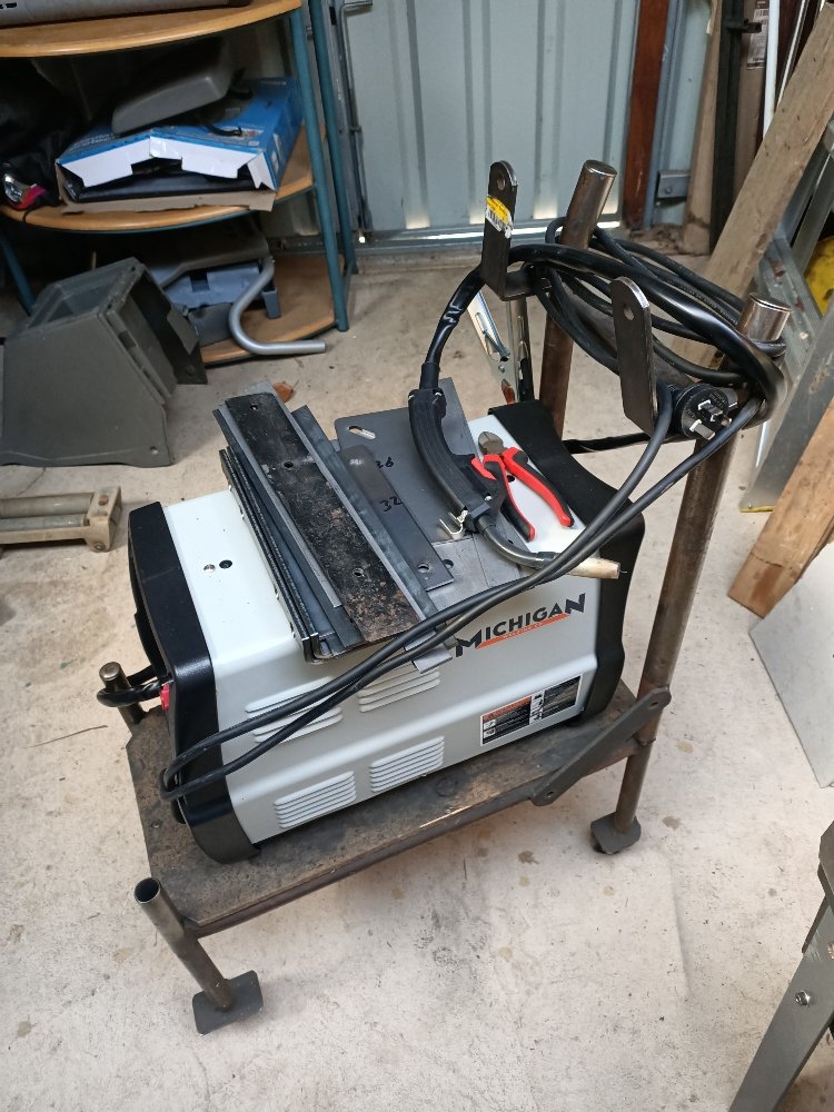

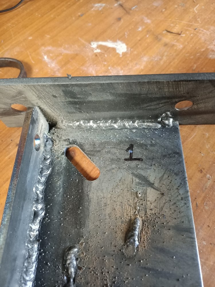

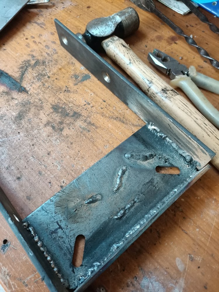

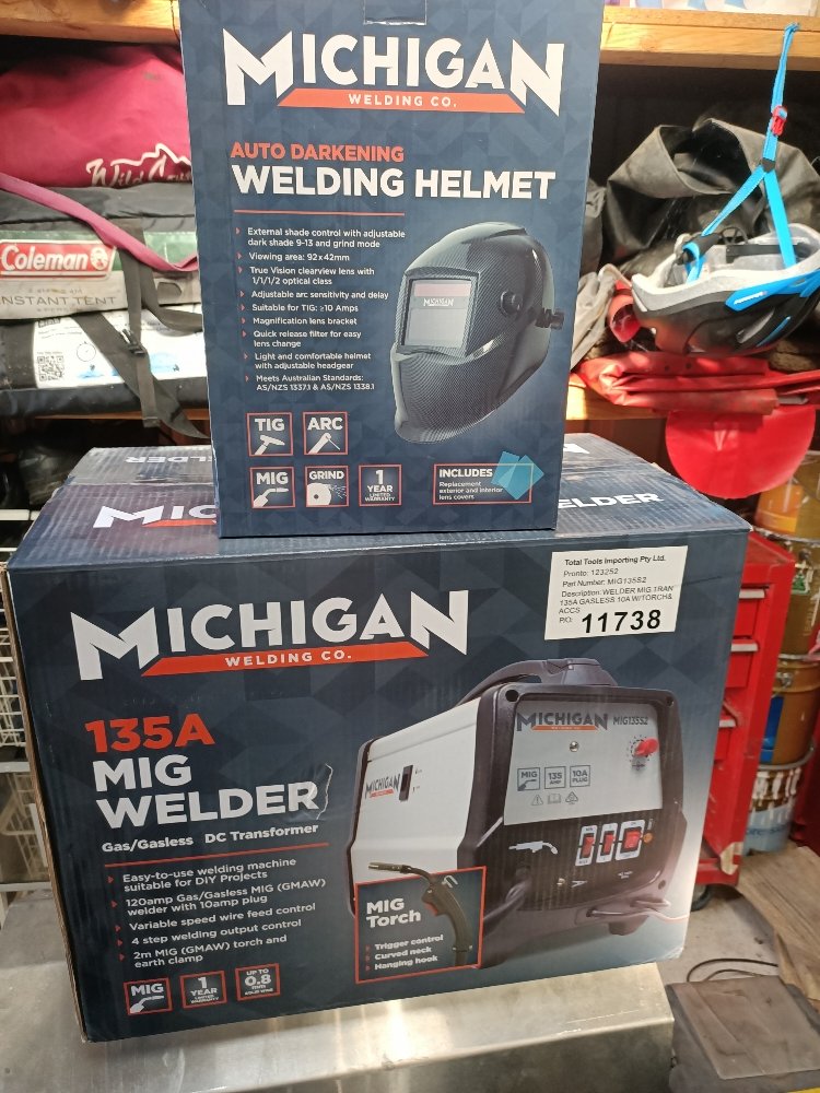

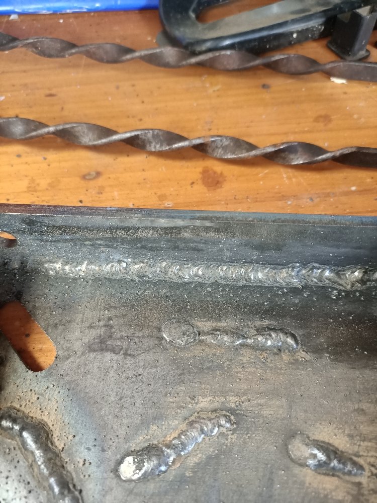

    Picked up my welder today.
    Had a quick little play with it and pretty happy so far. Found an old trolley at work and grabbed some scrap. 1st pic is first attempt 4mm, happy that with a descent hammer not of it come apart, that's gasless. Will have to set up the wire tension/speed correctly, but with some more practice it will do me fine.

    Looks really good. I am still struggling to get my Rossi 130amp unit to lay a decent bead. Understanding that all welders are different, could you tell me the speed and power/voltage settings you are using? This might put me onto a quicker success path. I have done the internal reconfiguration to run on gas now, but looking at your gasless results I might just swing it back for a trial.

    Might be the person operating the welder. Lol
    @jaysee you should find that using gas will stop the spatter you have around your welds. From what I was told anyhow. The gas is there to form a shield around the weld to hold the heat in for a cleaner weld. So I was told again.... I've never tried gasless on my mig.

    Settings are 80 amp and 3 on the wire speed.
    Your right on the spatter Mark gas is cleaner. I'll grab some anti spatter from work next week and try that.
