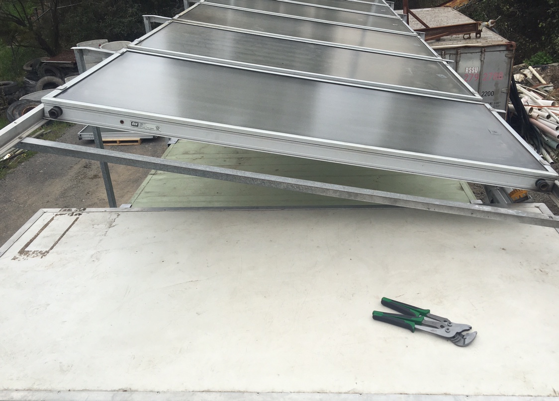

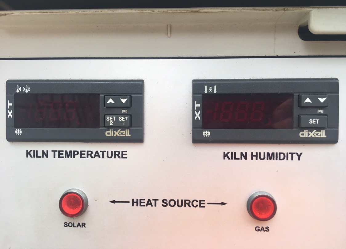

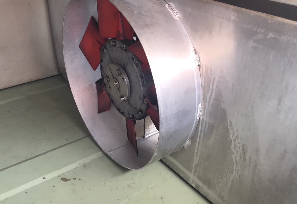

    Pwr source - 11 solar panels? only for fan / blower operation? to move the hot air that just build up in container from heat of the day or other means of temp/humidity control?

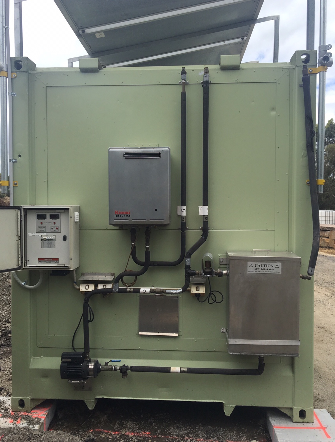

    She’s a pretty good design, happy with it John mate!
    Installing the last of the solar hot water panels now.

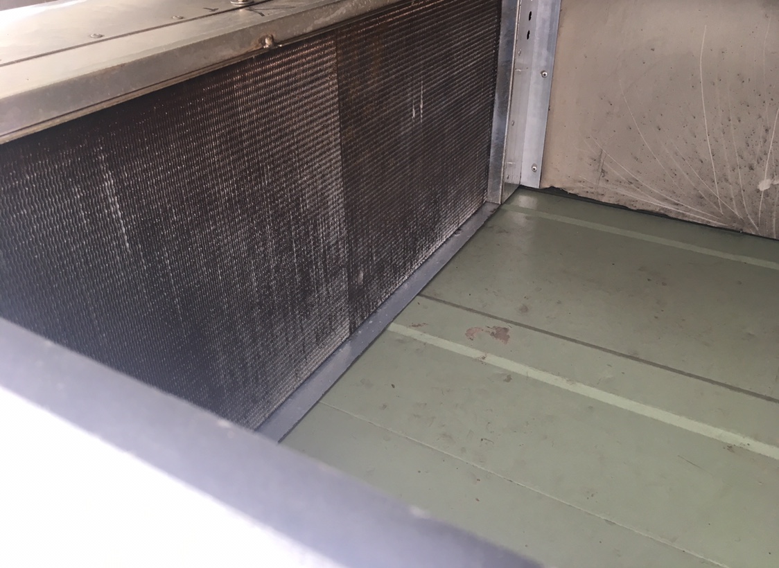

    240V fans blow through the hot water heat exchangers/radiators.
    Nighttime LPG backup squirts for when things cool down.
    Just need to hook the 240V fans up to our factory solar battery system and besides the LPG will run at near to no weekly costs

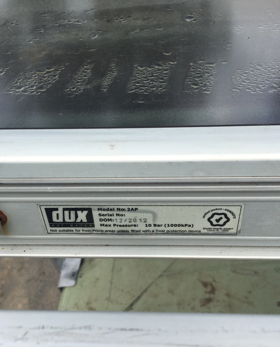

    Looks a great unit Mark. Noted the panels will need protection from frost damage, good idea to run Ethylene glycol thru system maybe anyway. Great if you get good solar down that way mate to save on gas..

    We noticed that frost panel warning too John but believe it should be ok as long as we run it 365days year round so the water should never get below our set say 55C charge.
